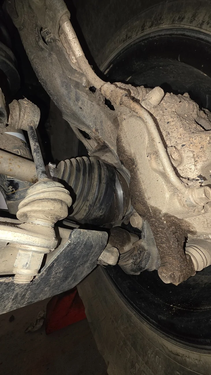

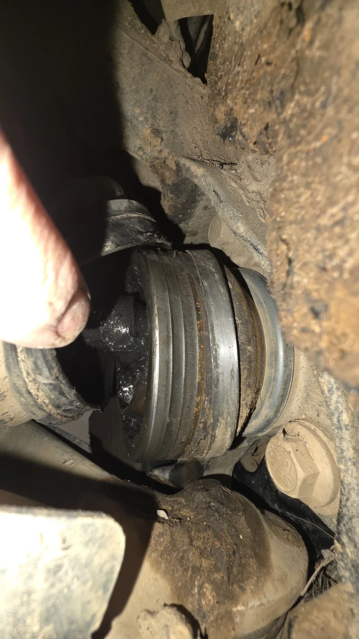

My CV boot came off font passenger while off-roading yesterday. Hopefully the joint isn’t cooked, but it didn’t sound good by the time I limped it back to the highway for a tow.
Is there anything that can be done to prevent / protect against this happening again?

From your description, it will likely need replaced. If you’re leveled/lifted 2.5” above SAS, the likely cause is your cv angles are too great. Can you post a photo looking straight in, parallel with the ground showing cv and tie rod angles.

Running 37" Toyo Open Country MT with Icon Stage 2 lift I had the same issue coming back from Windrock TN with the boot sliding off and getting debris in side the CV. I had to have both CV shafts replaced under warranty. To avoid this in the future I picked up inner & outer high angle boots from Poly Performance.

I had a stick come up from the mud and poke one of mine off. Was annoying. It started clicking a day or two later.
I know folks have replaced just the boot. From what I recall, the OEM boot was like $100 (try MB3Z-3B436-B), and you could buy the entire OEM CV for about $150 and not have to mess with cleanup, grease, or the possibility that it was damaged and just isn't presenting yet.

As far as protecting it - CV angle as everyone here has suggested plays into that. Beyond that - ... not really. Maybe LCA skids might help if it was from something exterior (like mine was), but even that's not a sure thing.
