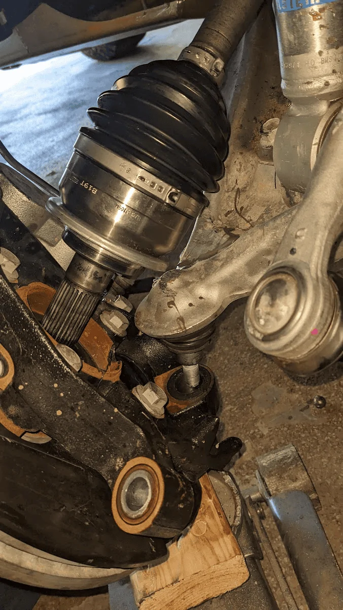

I guess it depends how they removed the CV. There's certainly no need to remove the lower control arm to do a CV.
Just knock the upper ball joint loose from the knuckle and swing the whole knuckle down. No alignment necessary 🤷‍♂️
Either way, if they performed an alignment like they claimed to, they messed something up.
I have done it this way as well. 10 years from now in the area @Ducati1098 and I live in we WILL NOT be able to remove the LCA bolts from the frame...just a fact of life here, so gotta figure out how to do it sooner or later! Helps if you pull the caliper off so you aren't fighting the brake hose, and I cant remember if I took the nuts off the coilover (I think I had them out). Helps having an assistant pry down on the LCA a little, but I can usually get them by sticking the prybar in my armpit and leaning on it

Yes, I did forget to mention remove the lower nuts so it would come down enough. 👍

Easier way at home with no lift is probably to remove the lower control arm bolts, but then you'll need an alignment.
I just do it differently because I do this for a living. So I have access to a lift and all the tools I could possibly need so it's much faster for me.

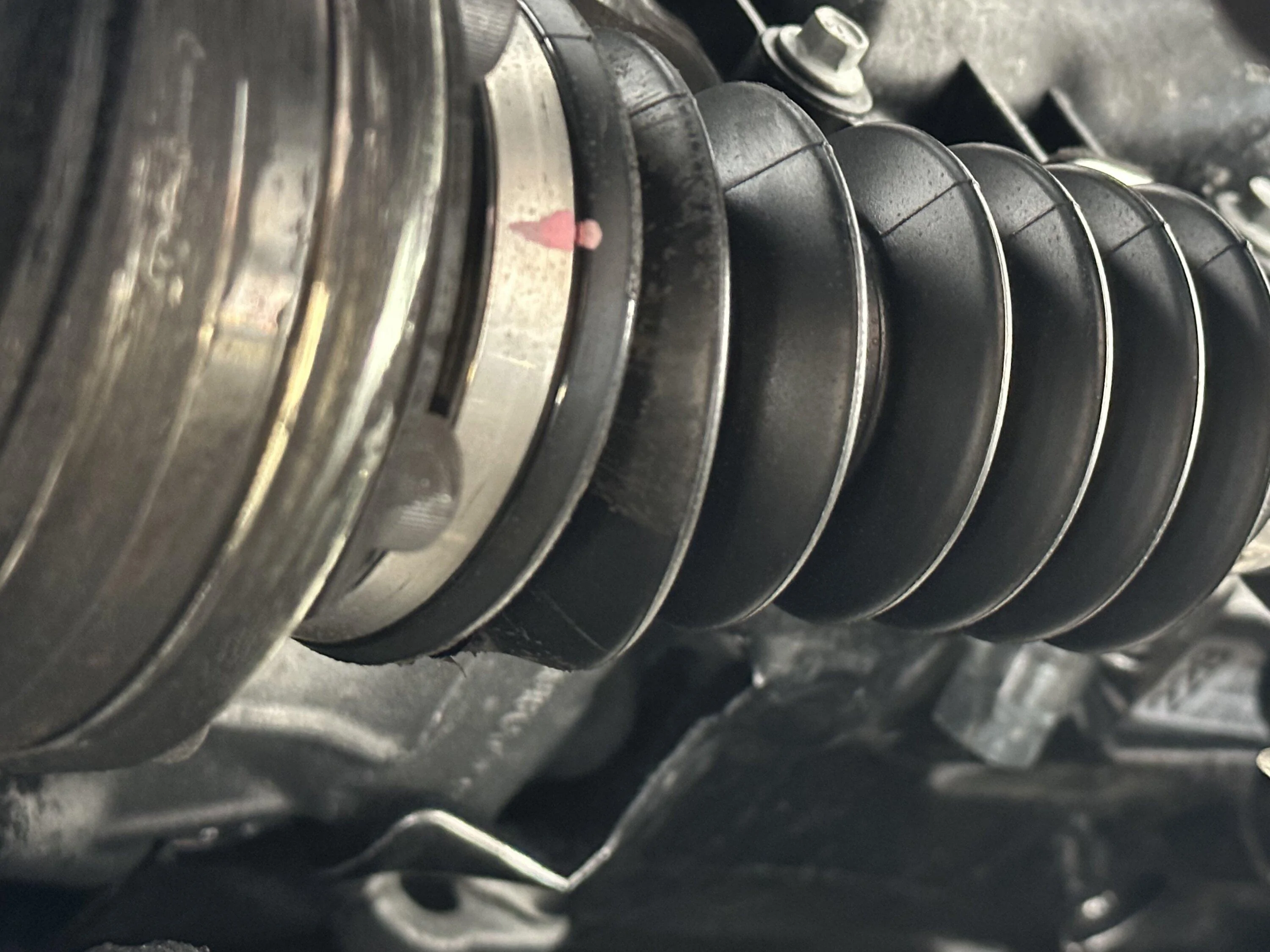

Be glad you found the issue; mine rattles on acceleration, vibrates at Highway speeds and I can’t find what’s wrong for the life of me
Looks like you got a bad boot install.
CV joint might be bad. A split boot won't make the noise looking like that.
I'd demand a new axle shaft.

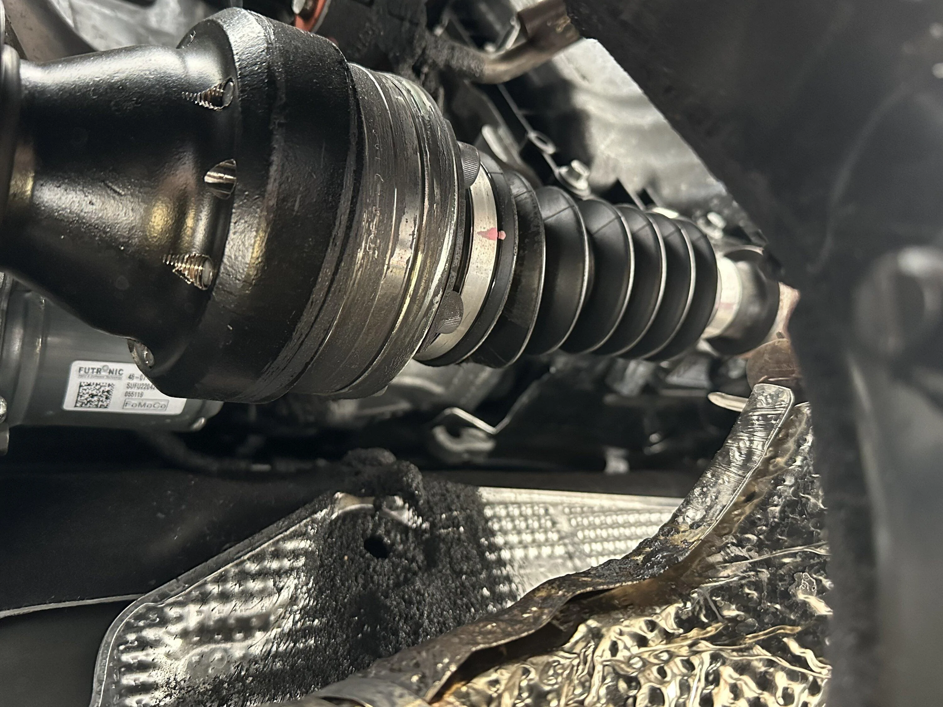

I’ve got a new ‘23 2dr badlands that recently started making an intermittent buzzing/cricket noise when under light acceleration, only when moving. Specially notable when going ~20-50mph. I’ve been trying to check everything on my bronco and just found my drive shaft cv broken. Was going to get my first oil change this Saturday at a local dealer but I’m taking her in tomorrow morning. ~2700mi, mostly Highway/town cruising. Y’all think the drive shaft will need replacing? It seems to me Ford is just replacing the whole assembly?
Edit: Not saying the buzzing/cricket sound is because of the blown boot. But if it does resolve it I will update. Seems like others here have the same noise.
@RustyGString
Can you update me on this? I have a torn boot there as well.. no noises though
