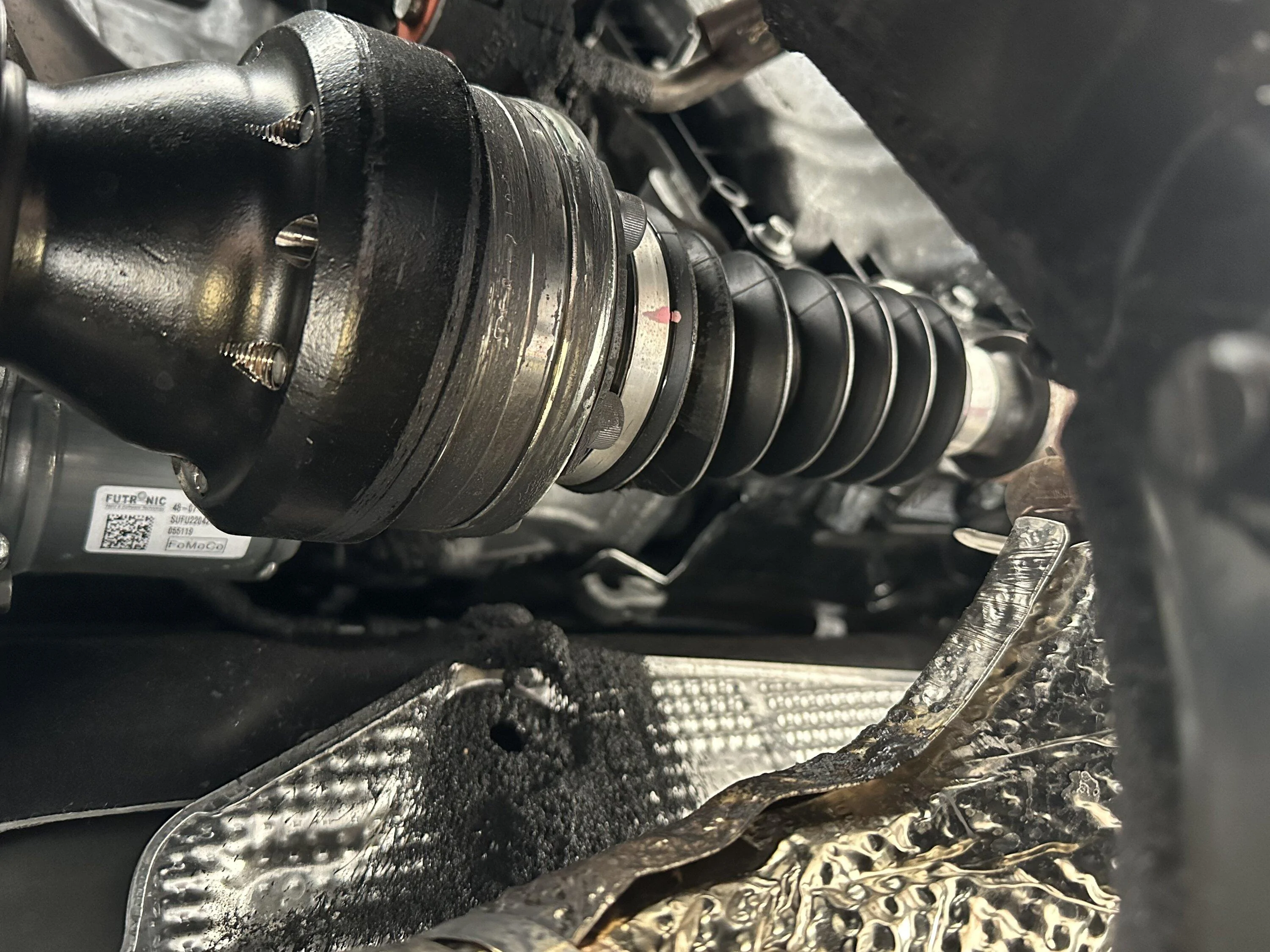

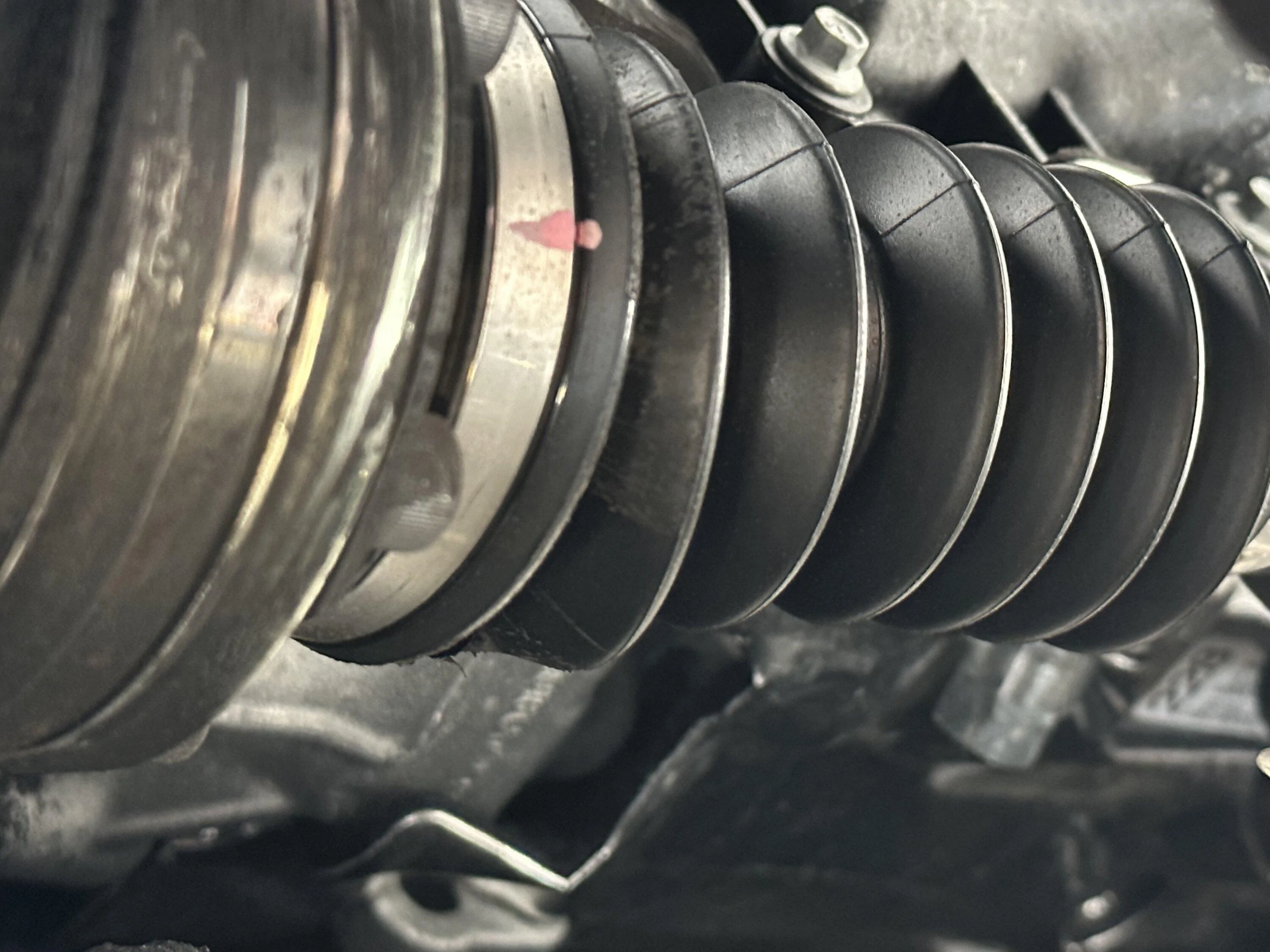

Damn, I just checked the boots on my ‘23 Badlands 2dr and found my drive shaft cv boot broke. Taking it in tomorrow morning. ~2700mi in and haven’t even taken it off road yet… bummer
Ugh. I have told everyone in my build week to take a peek at theirs and make sure no issues. We just got lucky putting on mudflaps and finding it so quickly. My dealer was able to hunt down an axle from another dealer, so hoping to have it completely repaired next week vs who knows how long waiting. Dealer said the axles were on backorder from Ford.
Hope you get answers quick.
Dang! Where are they getting and/or what are they doing to these dang CV boots!?
We're such a small subset of owners, so I bet there are a lot of Bronco drivers out there that probably pay MUCH less attention to their undercarriages than us.
Hopefully, the grindy/ringy/poppy noises get them to bring their rigs in before catastrophic failures occur. 🤷‍♂️

I replaced my own. 3 hour back yard fix. Easier for me to take3 hrs on a saturday than to deal withthe dealer lying to me for a month. Part was not on back order. This was about 2 months ago. Had plenty in stock. Either way,you wont hurt it anymore than it is. It may make noise but thats obvious as to why. Dry….

its not going to be a catastrophic failure. Its a boot thatholds grease that is leaking. It will take quite a long time and by then the noise will be deafening in your seat. Its also not damaging anything else. Its pretty simple. People drive for months with this problem.
