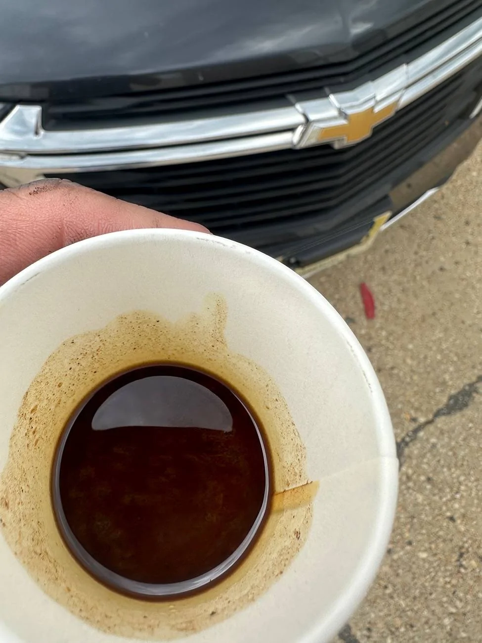

It had 7ml in it after 5K miles, I'll be checking it again here in a couple thousand. Not sure if that makes it worth it or not......
I had roughly the same during my last oil change. Actually, that is a lot of oil that can bake on the back of your valves over a period of time especially since it is direct injection engine. I doubt that when the engine is cold, the port injection really does anything to clean the top of the valves..
