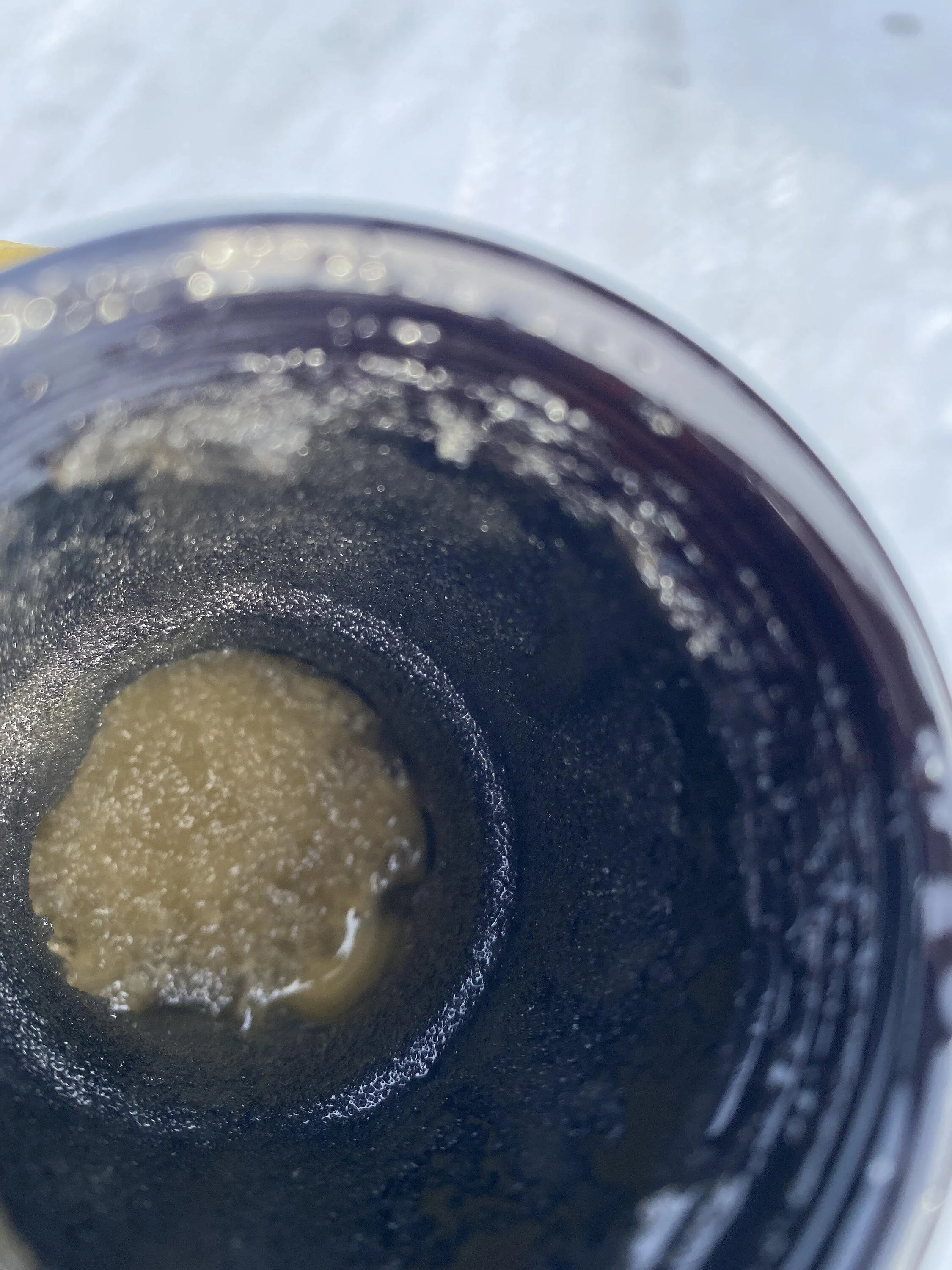

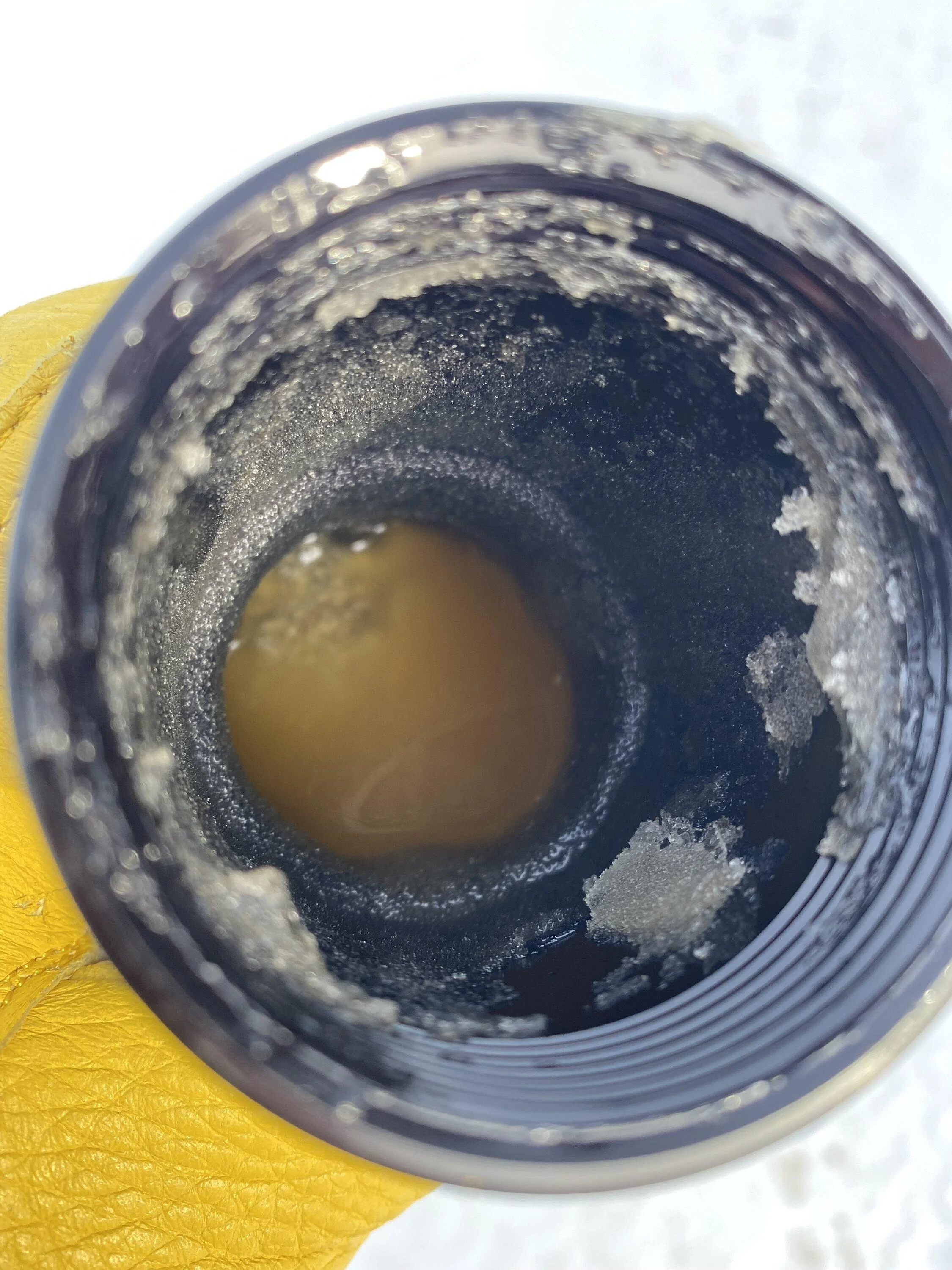

Those of us in the nasty cold winter states, I'm in MN with temps below 0 for the past few days. I checked my catch can (2.3L manual) and I have ice buildup and ice in the bottom of the can. I chipped out a good 1.5oz's. My concern is the freezing in the cap/screen and hoses. Any thoughts?
Update from J&L OSC (the brand I have) on the ice build-up in the can...
The vast majority of this condensation is happening inside the can. This happens from the hot engine air being hit with the cold outside air. Once the hot engine air is passing through the hoses it will quickly melt that ice and hence, more water mixed in with the blow by. The can will fill up faster in these conditions and should be checked and emptied appropriately to match the conditions. Just like any other routine maintenance, if it isn't kept up with there could be potential problems. I have never personally heard of one freezing solid, there isn't anywhere for water to sit in the lines and build up enough to freeze the entire hose.

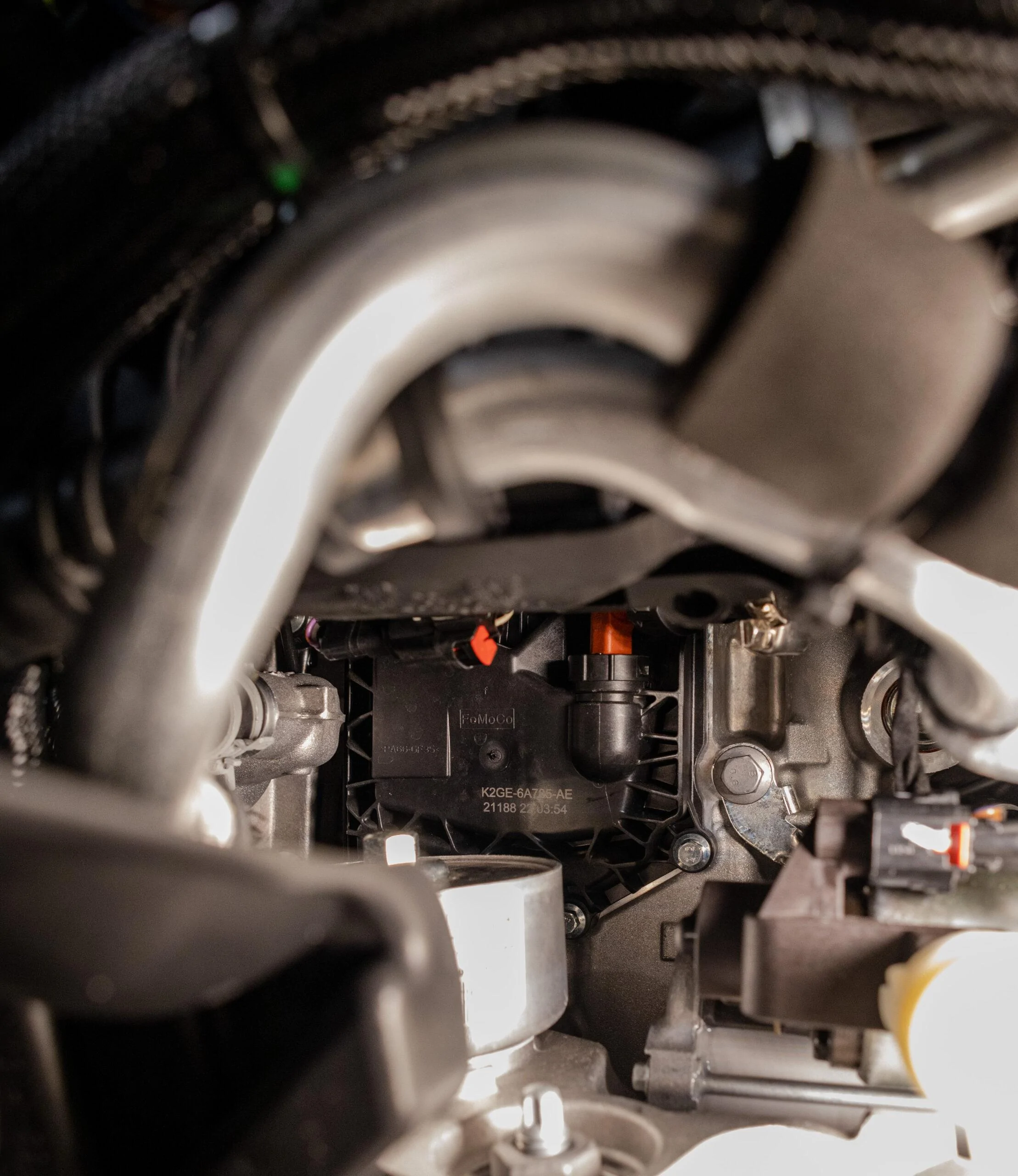

Finally, for those with our kit, going in through the wheel well definitely makes installing that lower connection simpler. Here's the view of where you need to connect the line from the wheel well:
Ford Bronco 2.3L Catch Can Results NLT_9145-scaled
We opted for this process instead of tapping into the line so that you're able to fully return the vehicle to the OEM configuration if needed without having to purchase new OEM lines.
I hope this helps those who had any questions or concerns, but if you have any more, don't hesitate to reach out!

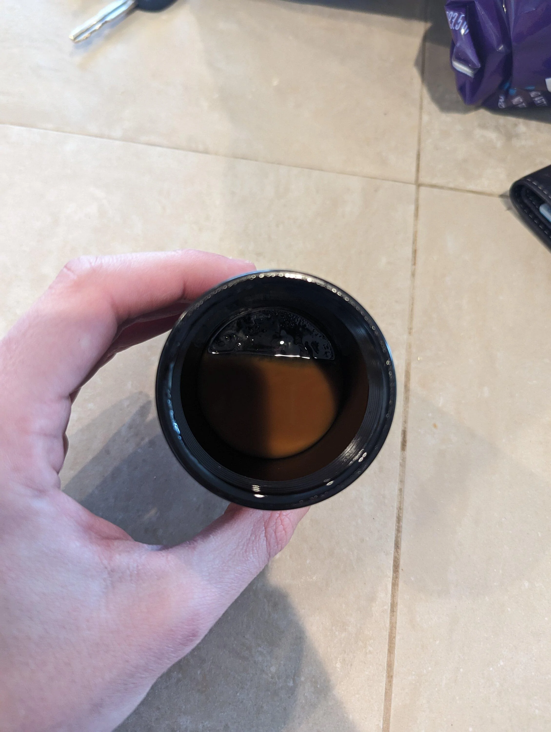

Checked my J&L catch can after having it for 1,000mi. This seems like a lot to me.
Currently at 2,400mi on my 2022 in Denver.
