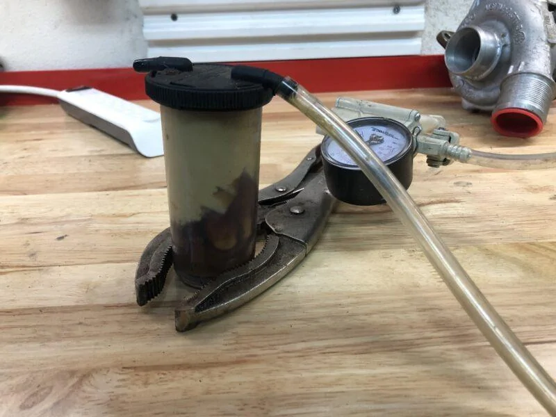

So after about 800 miles and about a month of running their catch can, here’s what I’ve been able to collect.
It looks to be a little more than a teaspoon which is about 5ml in Canadian dollars.
What’s more surprising is the apparent “gunk” in the bottom. See photos
Can was installed at about 3300 miles and first oil change was at 3800 miles.
Appreciate any feedback.
EDIT: after wiping the can out, I could not see the solids on the paper towel.

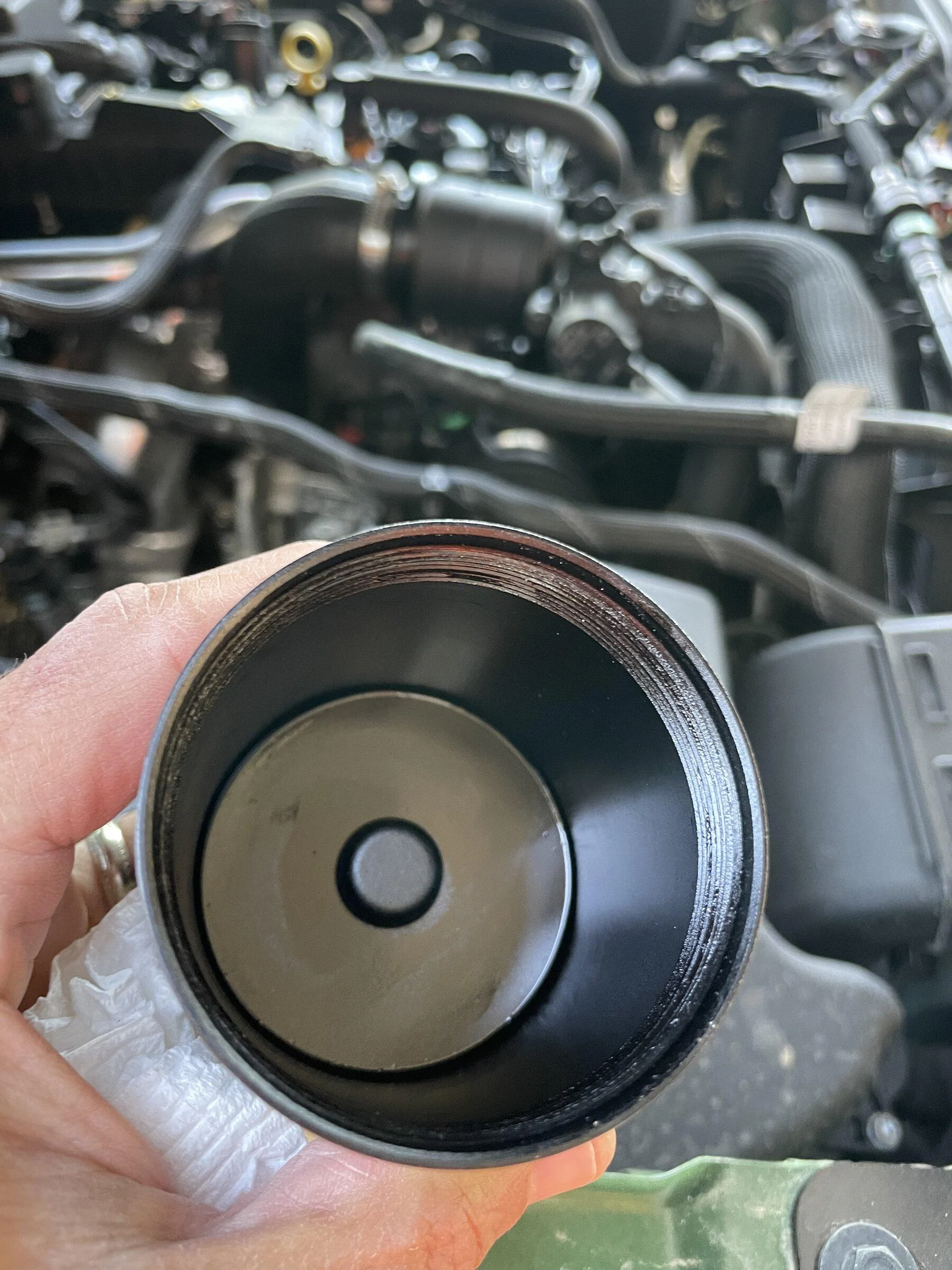

I put one on my 1.5L Bronco Sport after the first oil change at 2500 miles. The first check at about 3500 miles the can was empty. Ever since then it collects about half a can every 1000-1500 miles. I change oil every 3-4k. I'm at 11,700 miles now.
