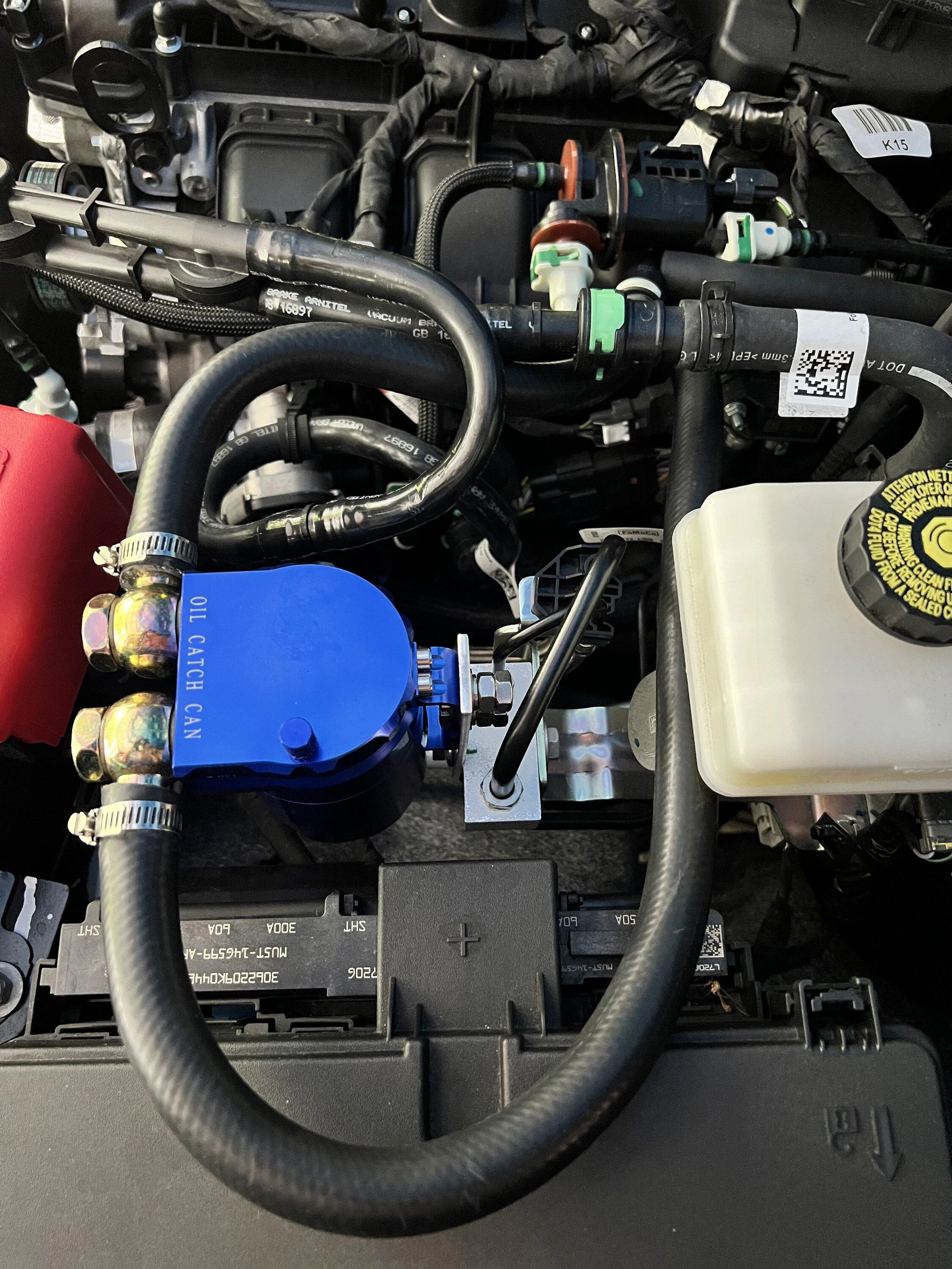

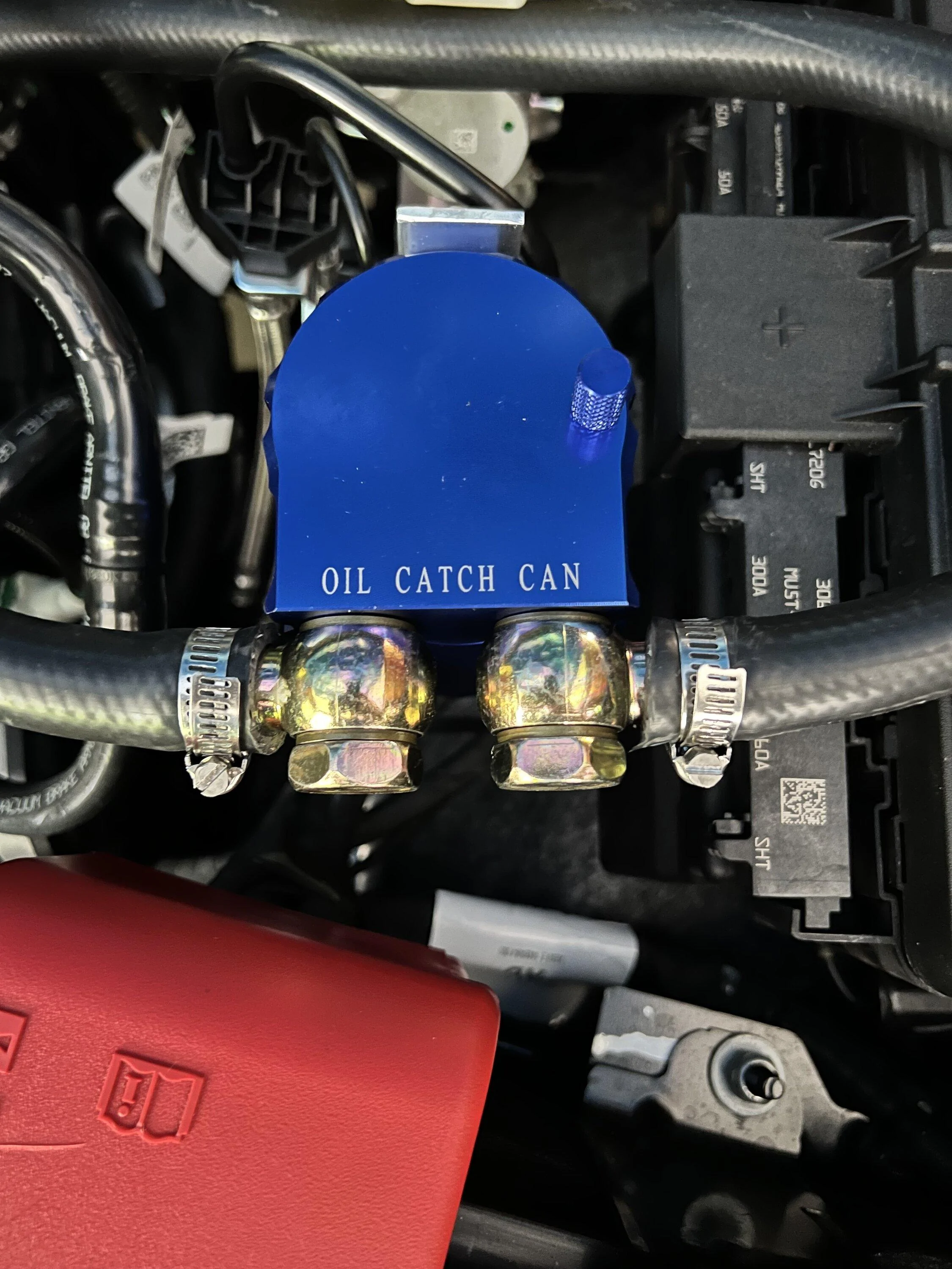

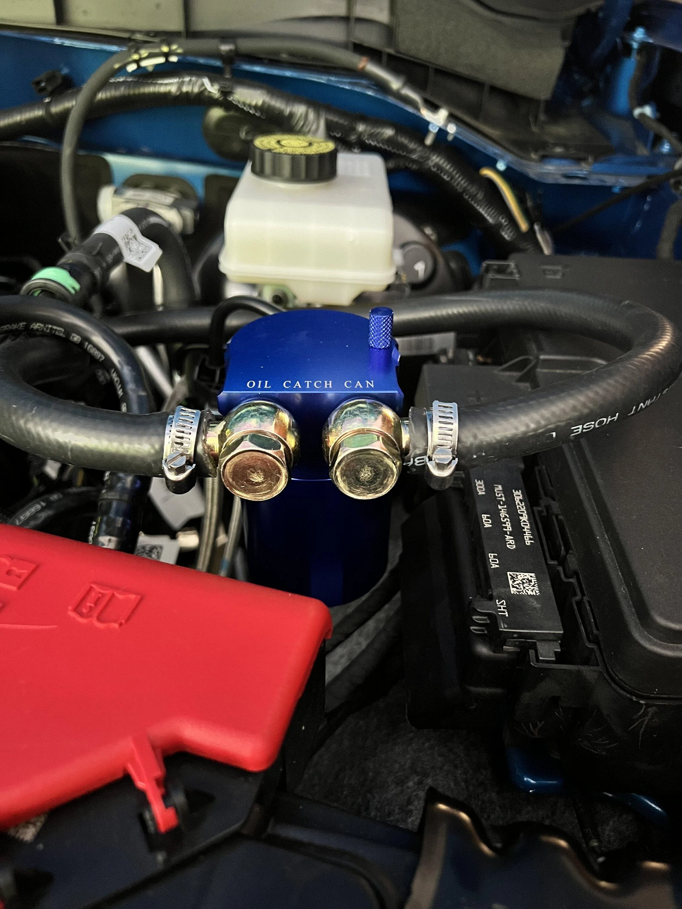

Hello!
First time post here. I purchased the Mishimoto catch can, and got 1/2 way through the install and realized the cylinder wouldn’t allow for east emptying due to location. I ended up buying a can and when I went to gather parts for the install hit a wall with the parts I needed to make it work. Included are the links for purchase with the exception of some aluminum flat stock (Home Depot) and a metric bolt that holds flat stock to brake distribution block (blind hole). I left the OEM PVC line intact (from bottom) and connected to it with a barb X 12.61 (male). The 2 pack quick connectors are optional, as the 1/2” line will fit right on to the intake’s plastic piece. The banjo bolt 90’s are also optional, but clean up the install. If you do buy these, you can get the 5’ of 1/2” line. I bought all parts needed for about $80. And I could have omitted some. Hope this helps someone…feel free to ask questions…
