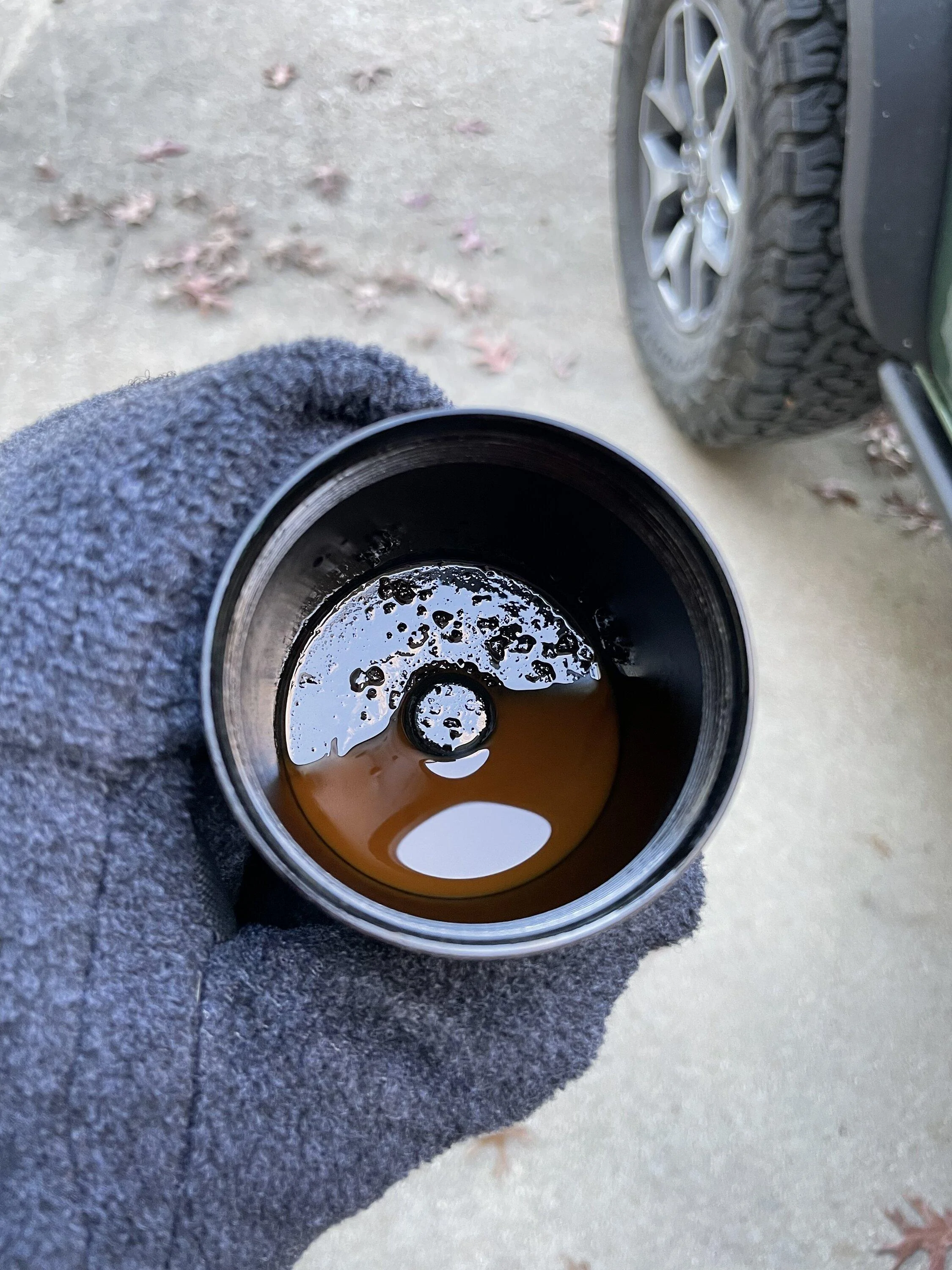

11,000+ miles and not a drop.
Ok, I have to update this. I last checked at 6K then went on a 4800 mile road trip. I just checked at 12,110 miles and have this.
Ford Bronco 2.3L Catch Can Results 50E592F5-466E-4B1A-B27F-E88B4ABC503C
sorry about the previous statement of 11K without a drop. It should have been 6K without a drop.

I get some in mine. Heck when I took off the stock hoses and put on the new ones for the catch can the stoke hoses had an oil film buildup on them already. install was shortly after purchase of the bronco, I posted pics of it on another thread.
It is never a lot as in holy chit the can was going to fill up amount but enough to be glad it's not going thru the intake. I also suspect a good chunk is water/moisture that is condensed and evaporates to a point.
