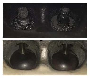

Then why on GDI engine did they develop a way to clean the back side of the valves by blasting with walnut shells? I worked as a consultant in dealership service departments from 2006-2020 and witnessed the problems with GDI develop engines first hand. As I said before, Ford addressed the issue on many engines with the extra injector in the intake. They did not do this on the 2.3L.
The vapors you are suggesting get burnt are ending up as deposits on the back of the valves over tens of thousands of miles. Sure, the repair would be covered under my 8 year 100K extended warranty, but the deposits will hinder performance long before they are bad enough to merit repair.
I’d rather buy the catch can than this:
https://www.ecstuning.com/b-assembl...nP4yOpHQwXZEV1irvOl5m8n7HrvbGie0aAk6DEALw_wcB
Before and after on cleaning.
