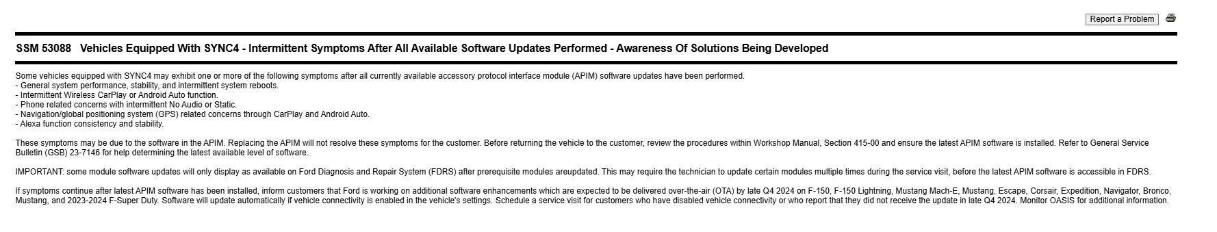

This is the SSM from Ford. The update brings the truck up to 24127. I assume that is the update because ever since I installed it on my truck, the phone connectivity was GREATLY improved.
SSMs require a dealer Visit?
No, an SSM is just a notice to dealers advising them of something......like an FYI. This is letting dealers know that even if the vehicle is on the latest Sync version available for it, there may still be issues and customer complaints.

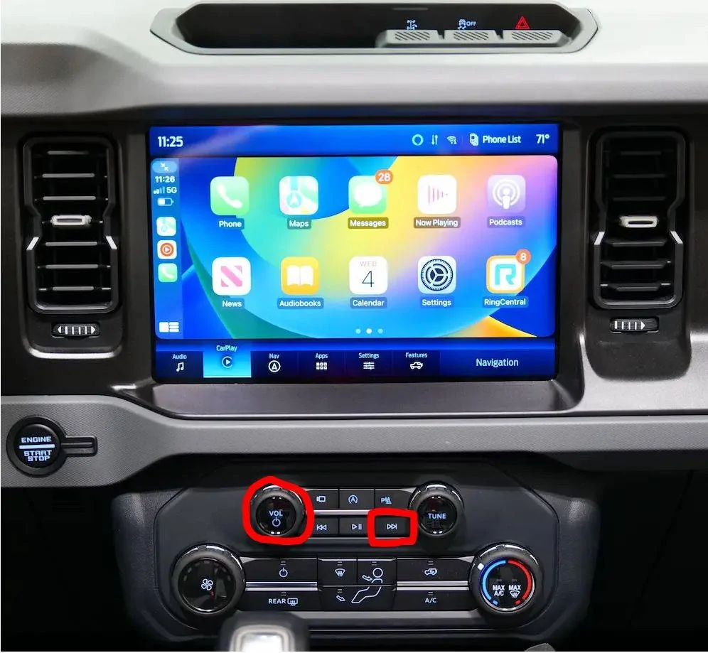

Just hold down the Power button + Fast Forward button. Hold it I’ll the sync system resets.

Dumb question - but what power and fast forward buttons?
Hold these two down at the same time. Takes like 5-10 sec to hold it down. Then about 25-30sec for it to reboot
Anyone know how to do this on the 15.1'' vertical screen in the Expedition? My wife has the same issue, but there is no fast-forward button.
