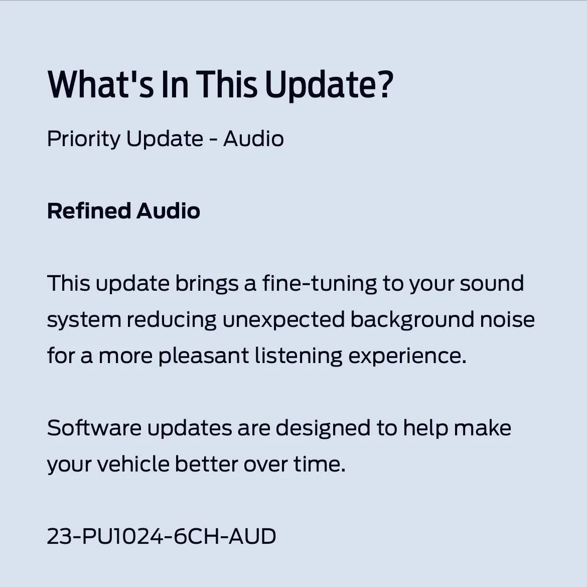

N.B. The ford software update this week, 23-PU1024-6CH-AUD, does not fix this issue.
That update is for the DSP (maybe the ACM?). It won't do anything to address this particular problem.

Release notes ..
Ford Bronco Carplay/Sync no audio intermittent issue IMG_7421
