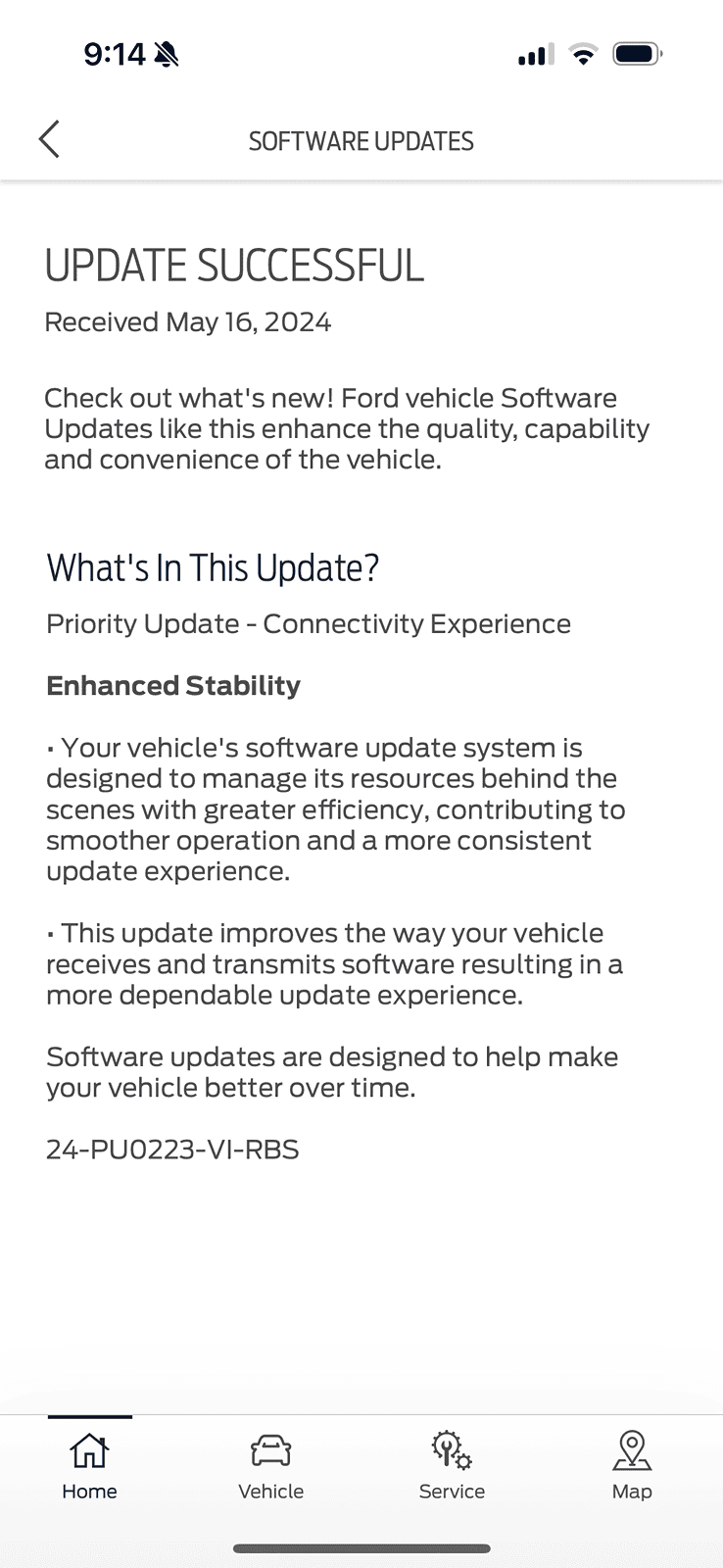

Ford Bronco Carplay audio issues and stutters IMG_3952
this looks promising.. will report back
