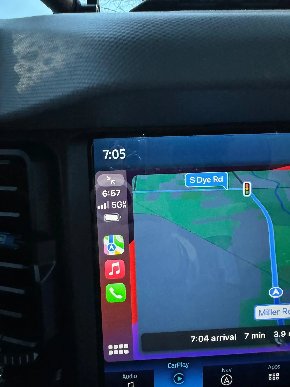

Is this module update/APMI replacement helping for those who have had it done? I have had all the issues described here for 6+ months and because it's intermittent and I can't get it on video to show my dealership, they keep telling me they can't do anything.
I finally managed to get a picture of a frozen screen the other day, I almost missed a turn thinking I had a mile to go. The time on the CarPlay clock is frozen and the system clock above it shows the accurate time.
Ford Bronco Carplay audio issues and stutters IMG_0375
Yes, when I took mine in the APIM was as up to date as it could be. It was the gateway module that needed an update. My previous post is the notes that my dealership gave me for what was done. I also provided my service manager a link to this thread so he could see that it is happening to others.
