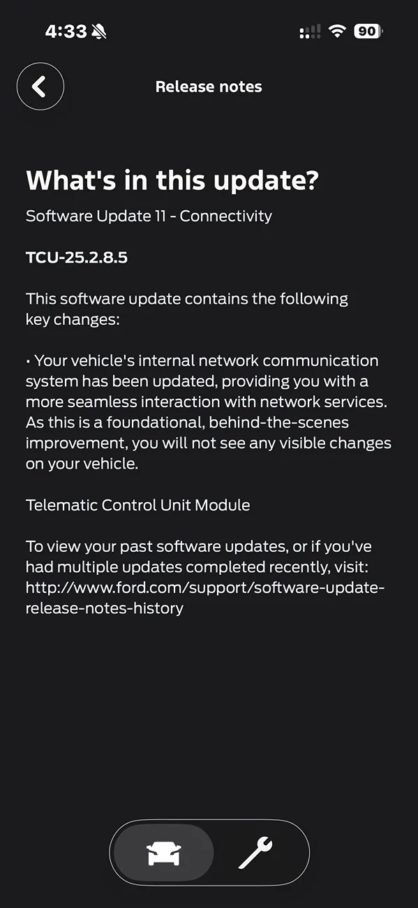

adcam
Mando
May 10, 2023
414
540
97229
2025 Stroppe
There is TSB for connection issues. We took our 2024 in just last week and the dealer did a software update. So far no problems.
Is this the update?
Ford Bronco CarPlay Recent Connection Issues IMG_7941

I hope it fixes my Expedition problem. You can't even use the phone with CarPlay. What a mess
Wildtrac24
Marty
May 8, 2025
Is this the update?
The dealer didn’t say which TSB or how broad it is. When it comes to CarPlay and iPhone issues I always push the dealer/shop check to see if there are any updates available.
