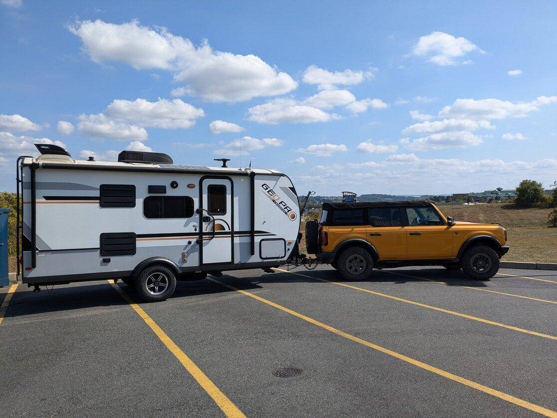

I pull a maxed out Xpedition Voyager at 3500+. 2021 4 door Badlands manual trans. stock tire size. Two things: 1) Camping gear adds up so when you think you are fully loaded, scale it out. 2) Adjustable damping may help but preload and/or helper springs are what will keep you safe and in control while towing at the max. You are going to want some rake when not hooked up, so that when you are towing, you aren't dragging ass. The Bronco can tow, but the rear suspension from the factory needs some help. Safe travels.

Yes you can, safely. Just make sure you're set up properly.
1. Brake controller
2. Weight Distribution Hitch (properly set up to tow level)
3. Sumo Springs
The Bronco rear suspension is really soft. I'm running blue sumo springs without any spacers on my manual Badlands and they help when towing while keeping the ride feeling stock when unloaded. I had originally installed with a spacer and, while it completely eliminated the rear sag, the unloaded ride was too harsh so I took it out.
I'll eventually upgrade the factory hitch to the BRaptor version to get the extra bracing and structural rigidity but that's a bigger expense as it requires relocating the muffler to fit the supports.
