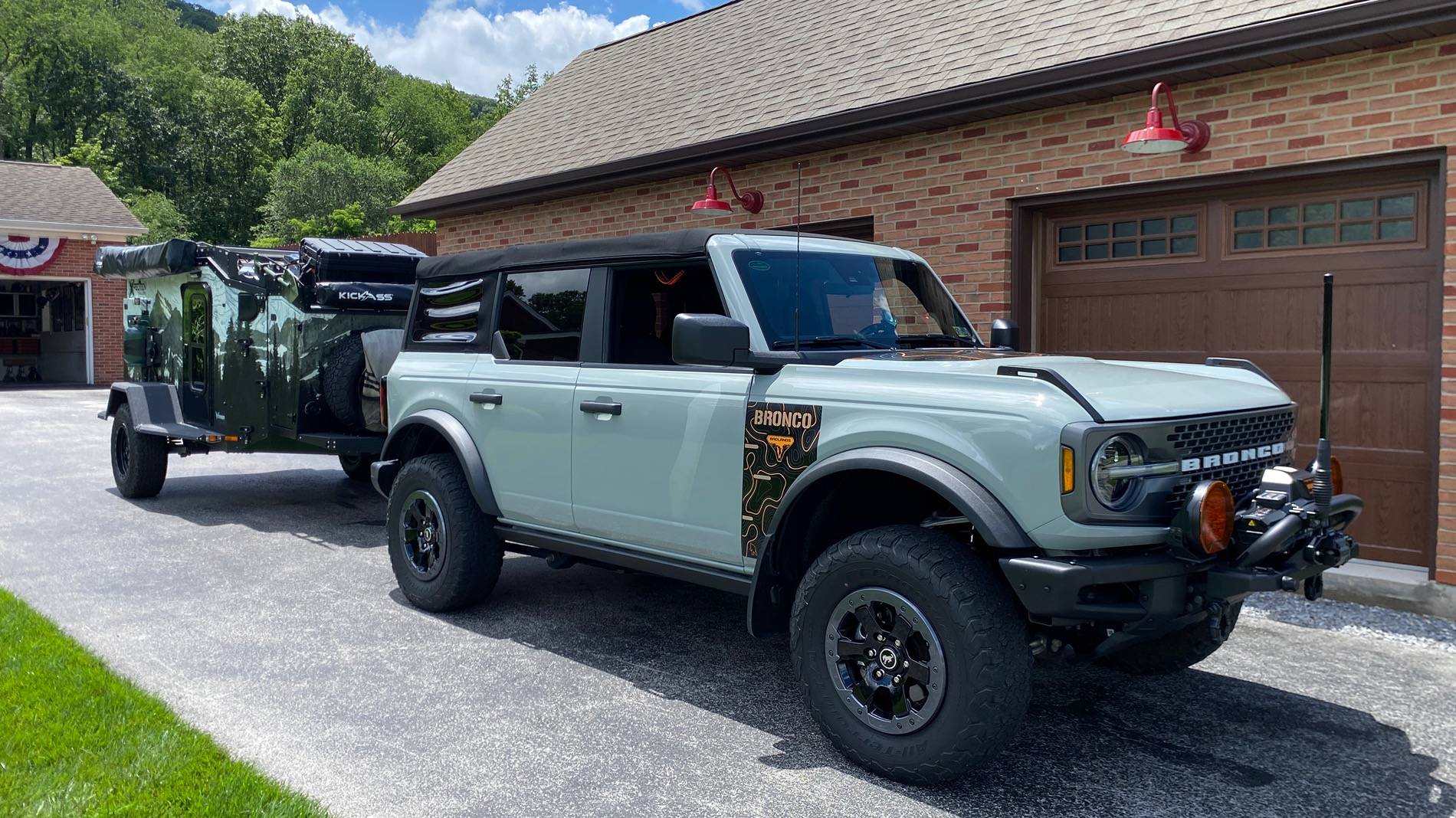

I got a 4x6 cargo for $2500, built a roof rack for it, am adding windows & a vent & will eventually skid the bottom, do a hub swap & put a set of sasquatch take off wheels on it. Hoping to be under 5k total spend when I'm done.

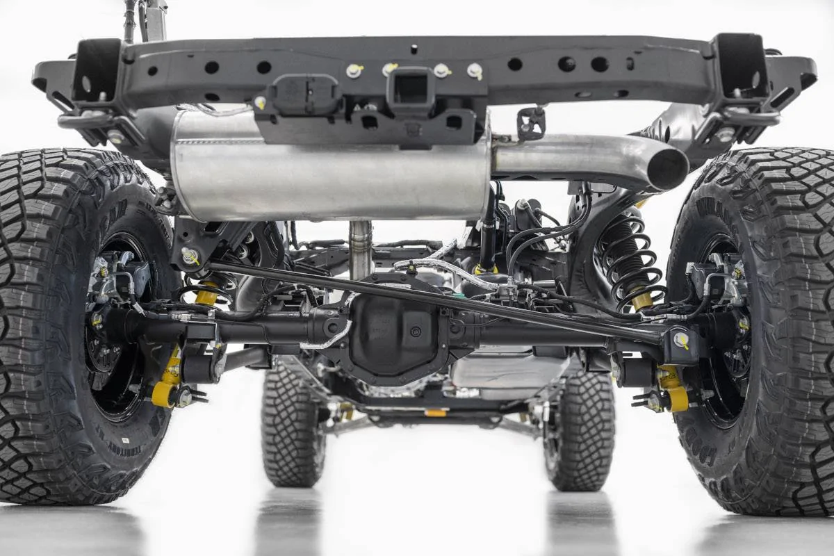

I've read the threads here on the cross member, and many feel it's the weak link... and some on the soft rear springs used because its for OFF road. Then there is the added length to get pasted the spare tire, to hookup.
I live in SoCal and there are tow receiver shops that make their tow receivers... If there are any in TX, I would talk with them about the towing and changes they might make to increase/beef up the receiver.

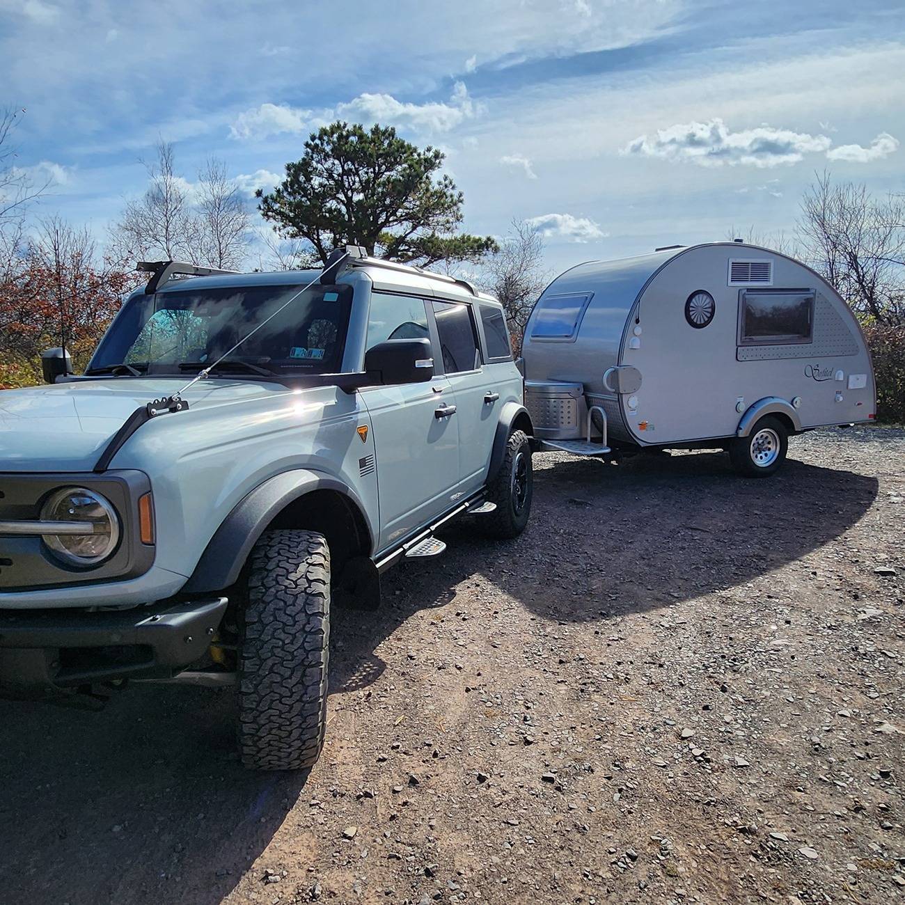

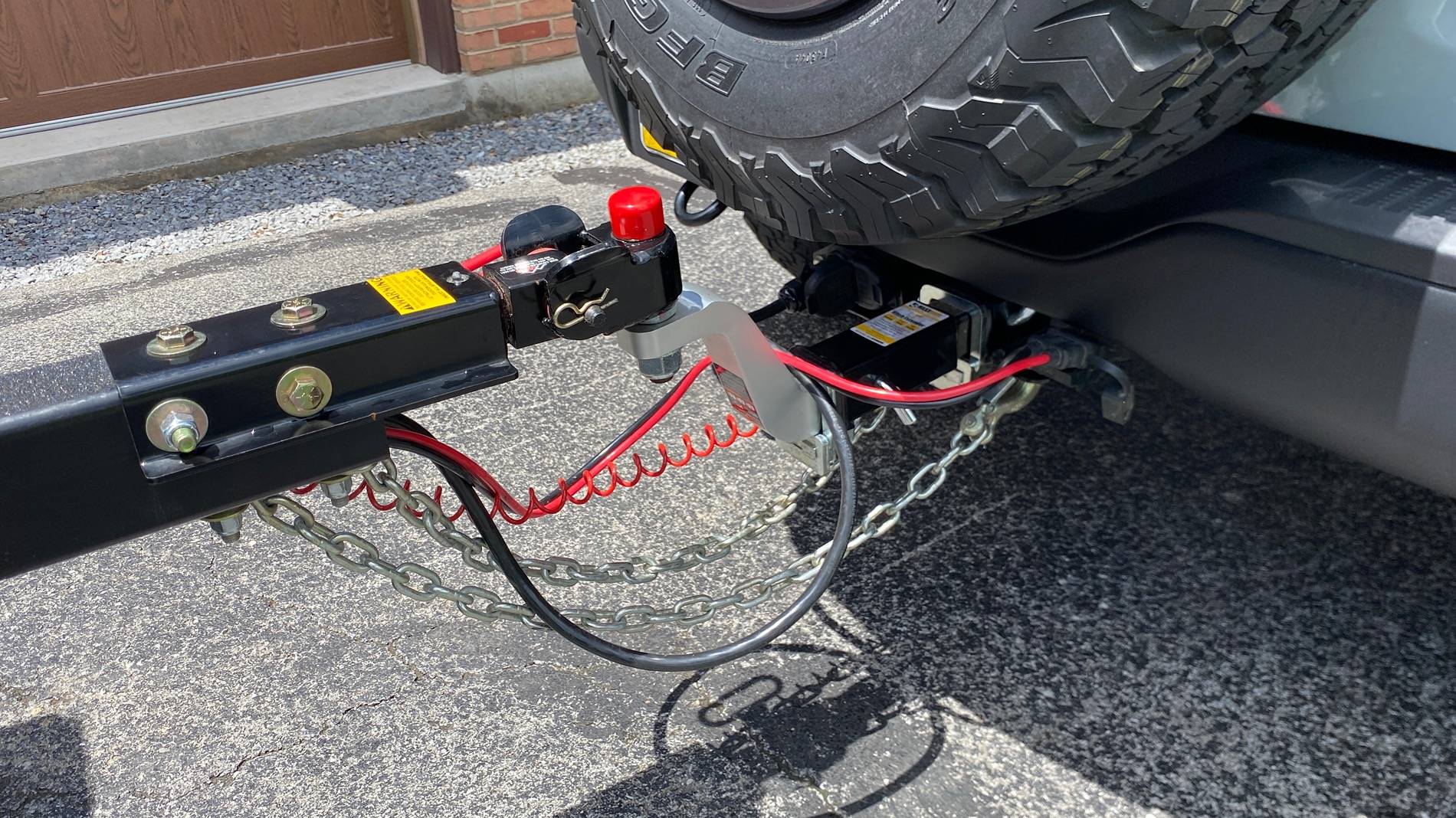

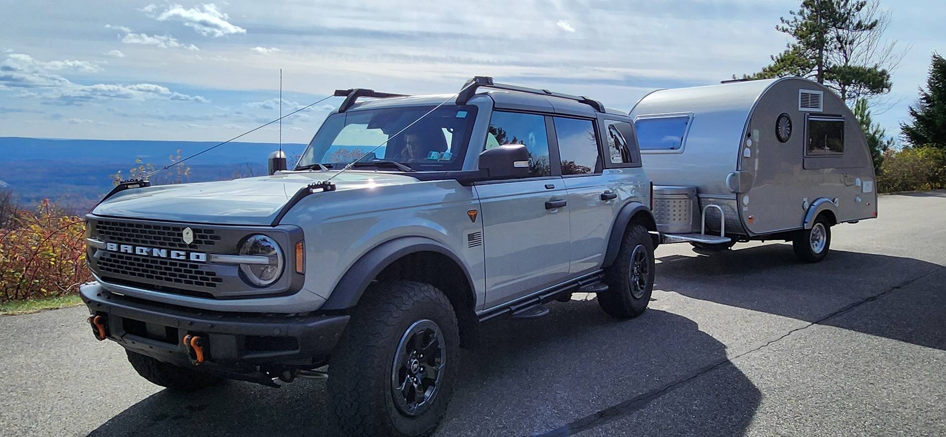

I'm looking at buying a small teardrop trailer. There are so many threads on what the Bronco can tow but people seem to disagree if it can actually tow up to it's rating.
I'm pulling a NĂĽcamp teardrop with the following specs that are close to what you want to pull:
Dimensions & Weights:
Exterior Length: 15' 3"
Exterior Width: 6' 8"
Exterior Height: 7' 8"
Sleeping Area: 58" x 71"
Interior Height: 69"
Dry Weight: 2,105 lbs
Tongue Weight (Dry): 208 lbs
Total Gross Weight (Dry): 2,105 lbs
Tire Size: 205/75/14
GAWR: 2900 lbs
BUT... I've got a Badlands 2.3L MT with 33" BFG KO2's so the vehicle weight is is than yours. I've had good handling and don't really feel it back there (for what it's worth)...
Just thought I'd give you some insight on a similar setup... for what is worth.
