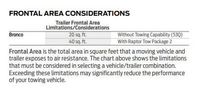

If he wants a simple yes or no.... Then the answer is no.
The thing most everyone forgets, and not mentioned in this thread that I saw, Is frontal area
That trailer has frontal area of 76.5 Sqft. The towing spec for his Bronco says 30 Sqft Max.
It's like dragging a big parachute out the back.
Will it do it? Yes, probably with no problem at all, But if the goal is to avoid liability, then no, it can't be towed without liability.
Something folks always miss, but like you say probably no problem. My E350 owners manual states 64 sqft (or so)for towing (8x8), yet as a Class C motorhome it left the factory at 88 sqft (8x11). And I mean really? 20 sq ft??
