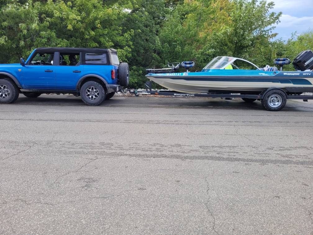

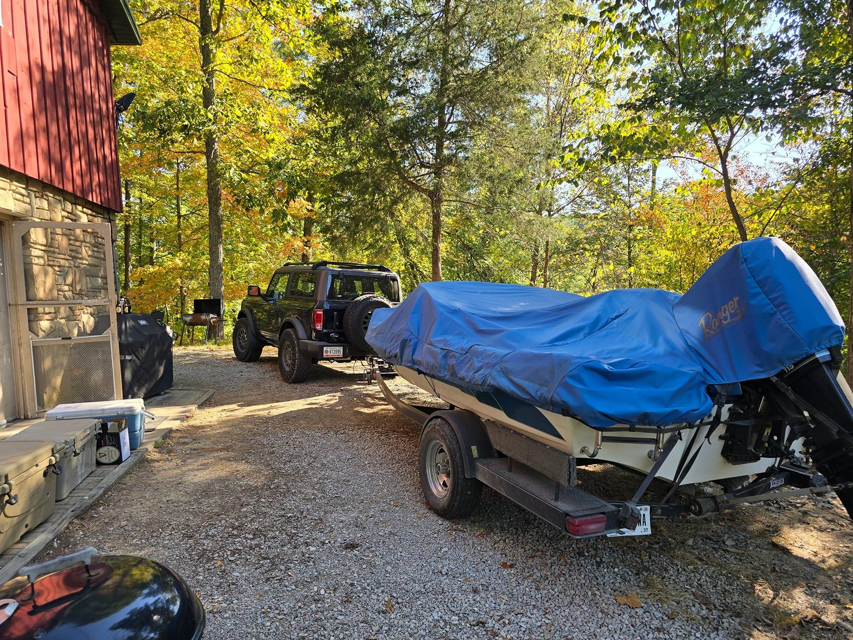

3000 lb boat and trailer , pulled beautifully with the 4dr./2.3/auto
Pulled ok-ish with 2dr/2.3 manual on 35's and 4.46 gears.
We've pulled that boat all over the place since 1995. That 4dr pulled as well as any truck we've had over that time ... well except for maybe the F250 diesel 4x4, lol ... but every 1/2 ton for sure.
I'd drag that tear drop without batting an eye, especially if it has surge brakes. Keep track of your added weight.
If you tow often, MAYBE stiffer springs someday, otherwise it may not be worth the effort.
