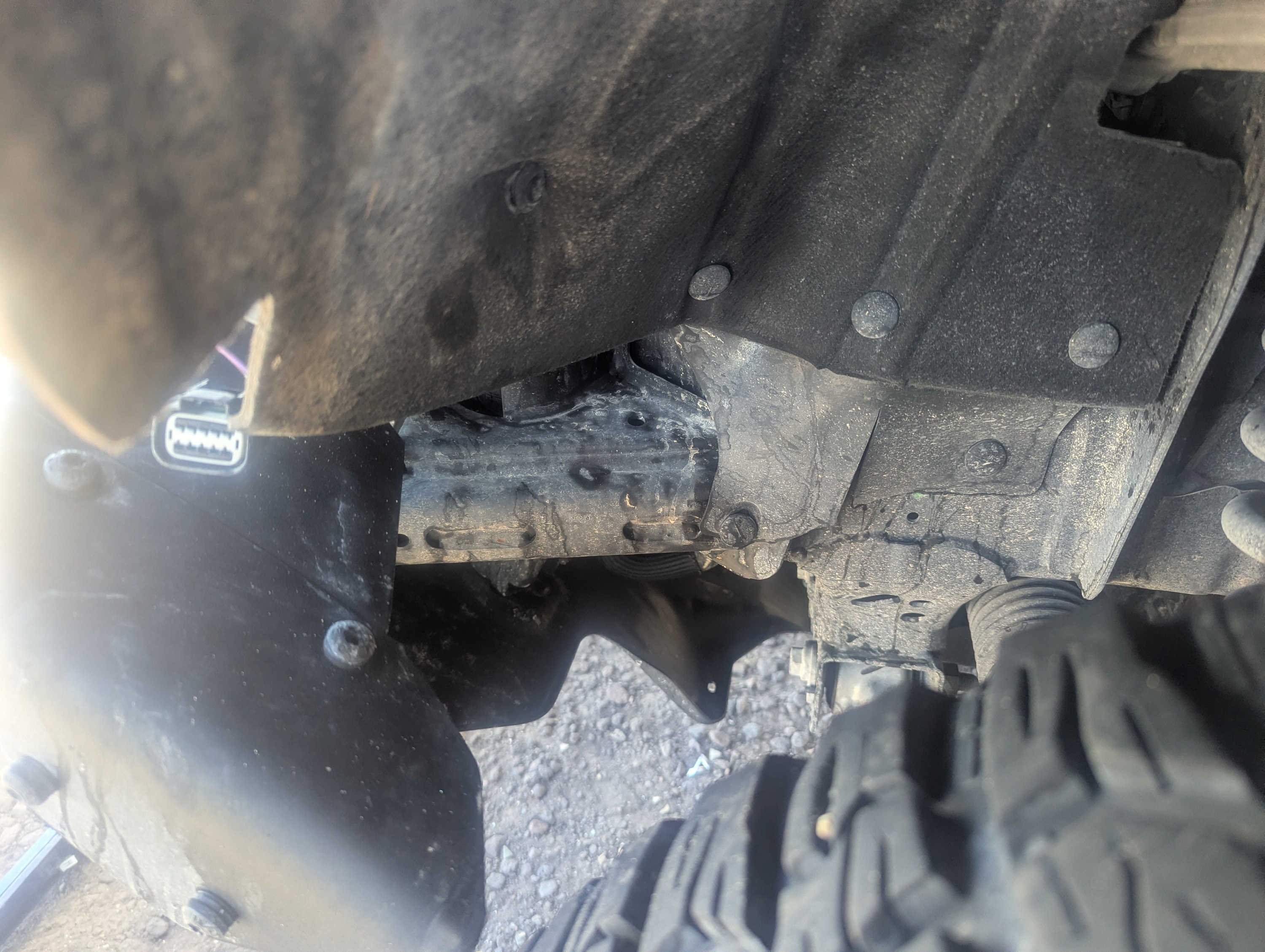

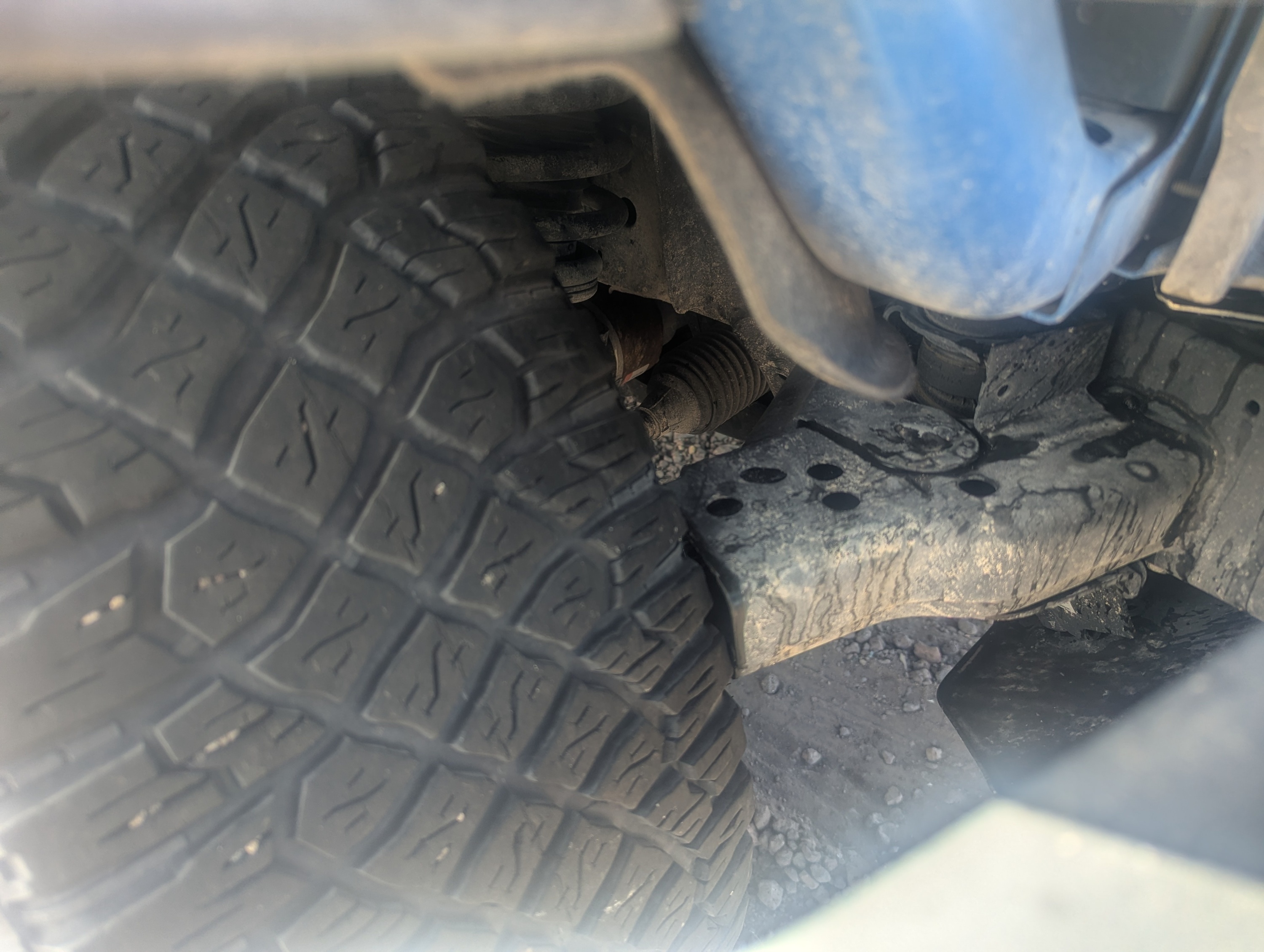

Cut and weld.
In both pictures the tires are pointed straight ahead. and parallel to the frame
Driver's side
Ford Bronco Bronco Possibly Totaled 1y7oMGw
Pass side
Ford Bronco Bronco Possibly Totaled 79bIdIe
Driver's side
Pass side
It's possible that nothing behind the front brackets got damaged but standard practice is to put it on a frame rack, hang targets, get measurements and compare to OE. If the front horns do need replaced the "correct" way is hanging targets after disassembly and the horns are tacked in place once they're in the correct position then finish welded based on what OE call for. Reality is that a lot of places will do it without laser frame measurements and can get it close enough things will align after they're done. There's enough play built into the components to allow for tolerance ranges during manufacturing but it things were already at the extremes, using less precise methods can cause fitment problems when going back together.
