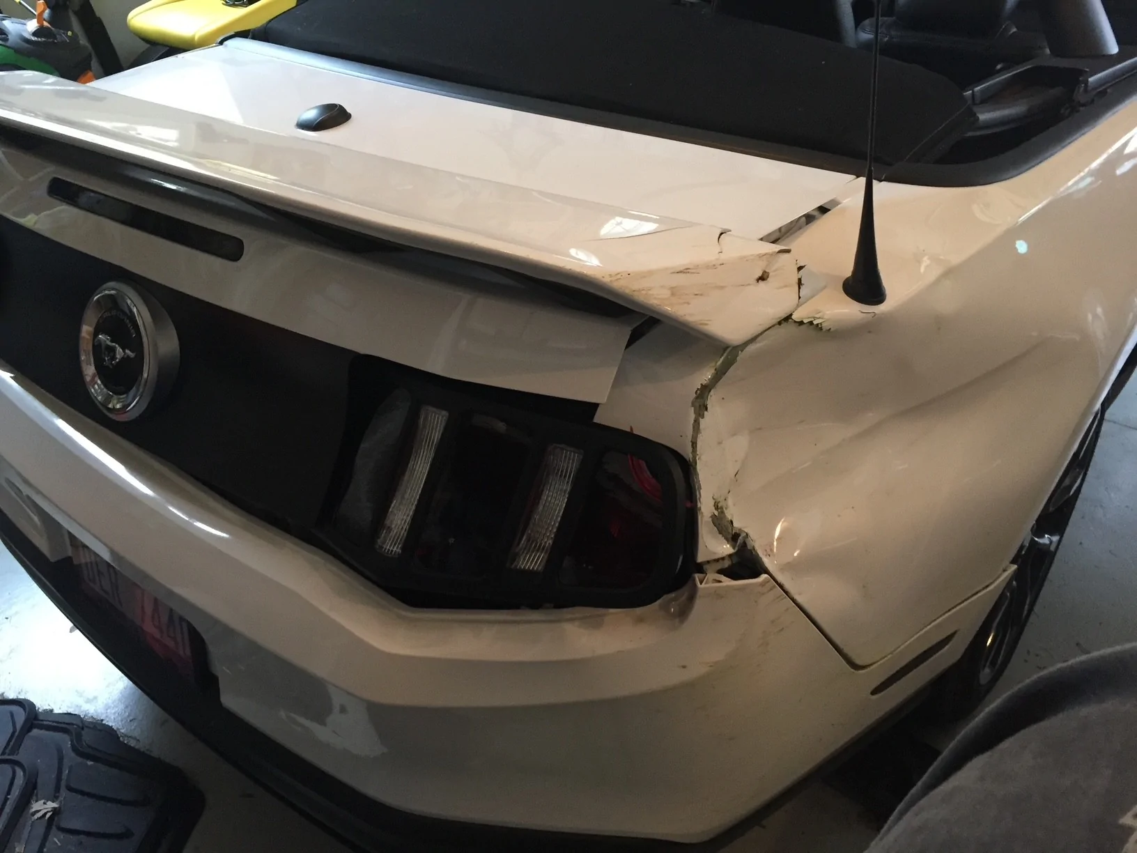

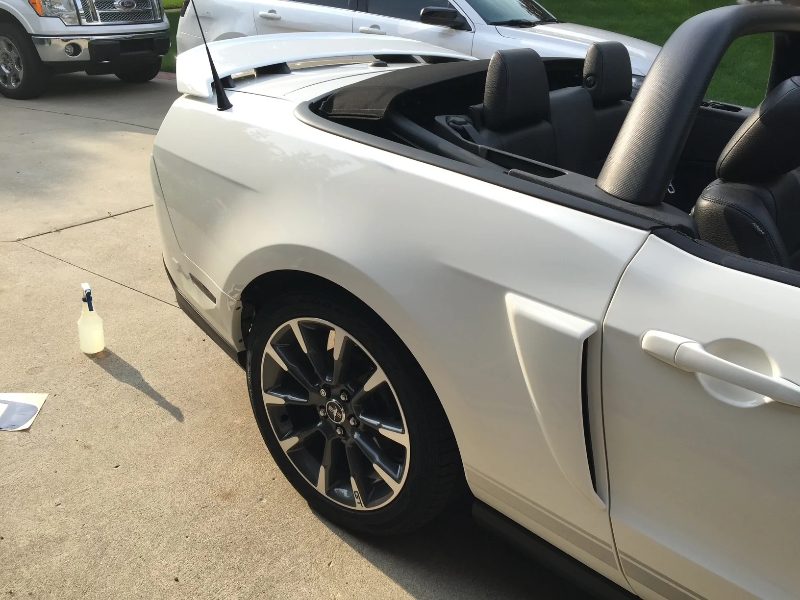

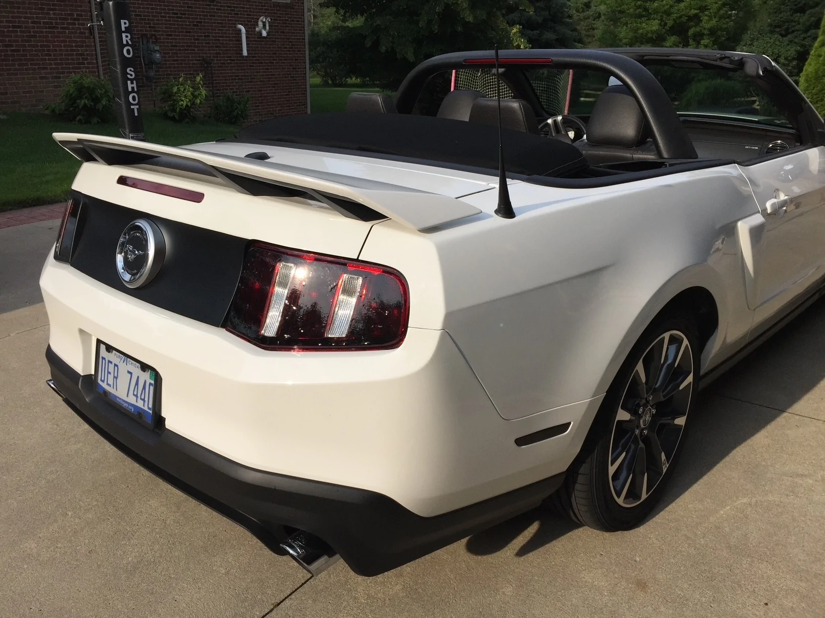

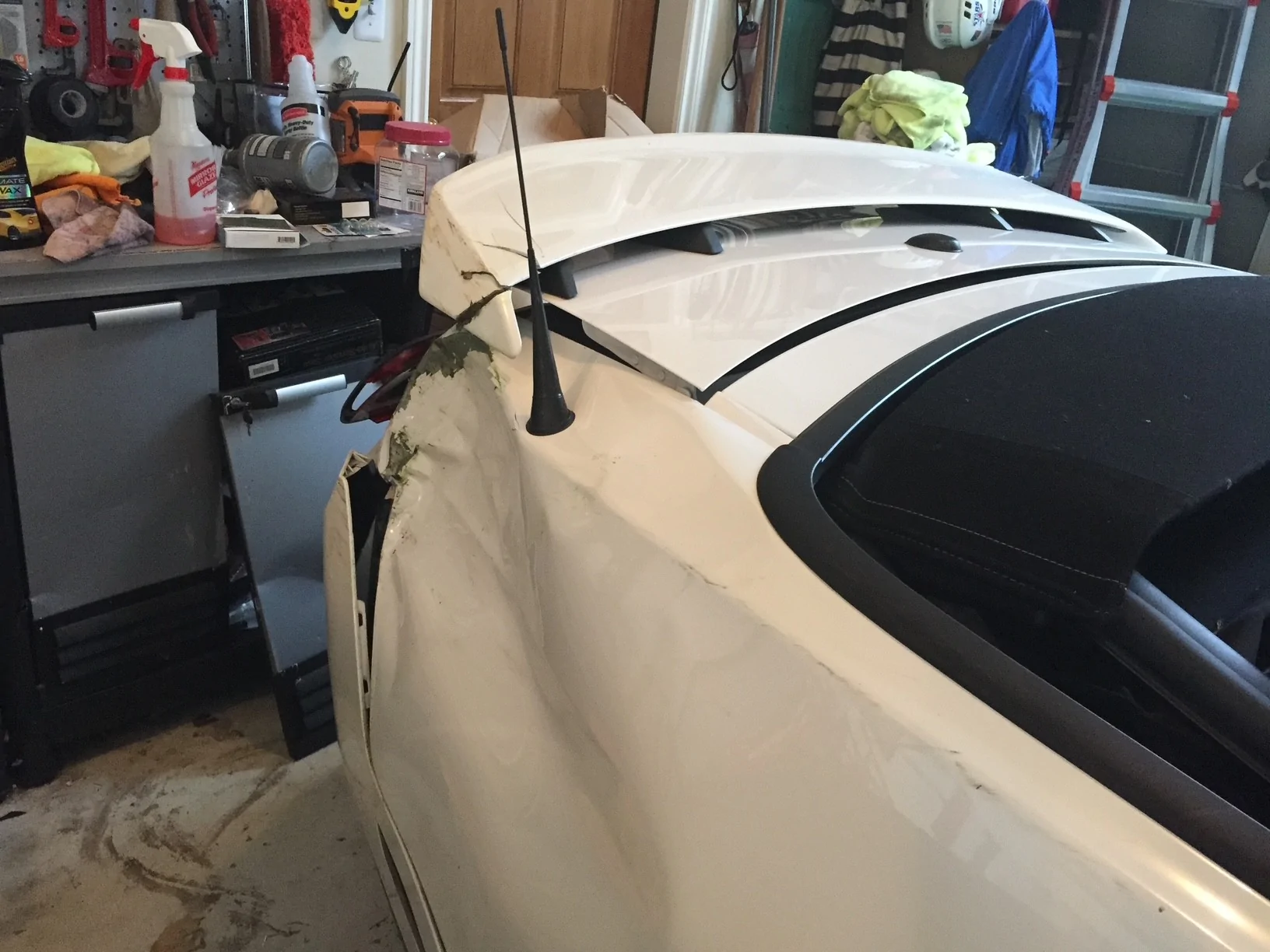

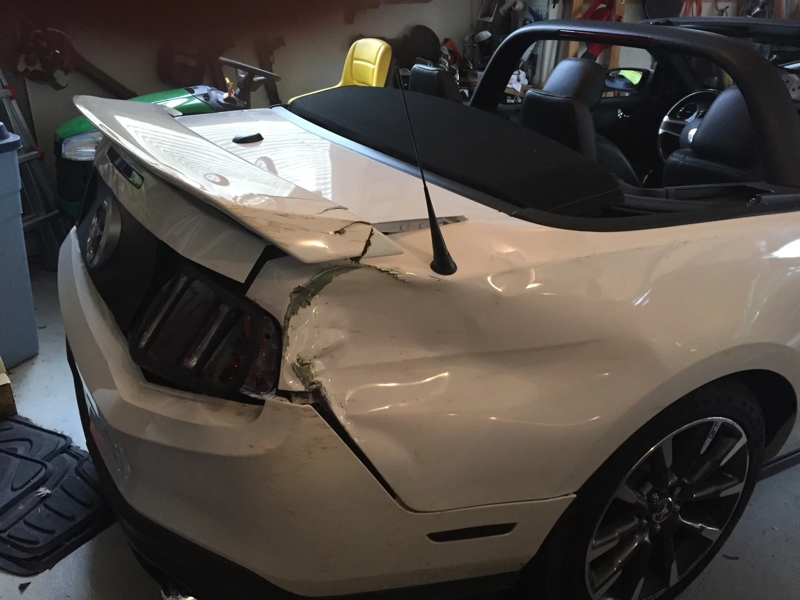

It's why good body shops will repaint the entire side or even entire vehicle and not just a single panel
Yes, either paint the entire side or do what they call "blending". I'm not a body guy so I may be incorrect in what I'm about to say, but I don't think "Blending" means painting all the adjacent body panels. I thought it was clear coating them, since often it's the clear that tends to dull and fade. Again, I could be wrong.
Prior to my Roush Mustang, I owned a white Mustang GT convertible. One of my son's had an accident that damaged the right rear quarter, rear bumper and deck lid. When repaired, in addition to replacing the damaged body panels, they ended up blending almost three quarters of the car (Before and after pictures attached). The car came out looking great.
My Cadillac CTS-V is painted in what is called Black Diamond Tri-coat. It has a heavy metal flake in the paint. On cloudy days in just looks black, but under light or in the sun you can really see it pop. Just a deep color that looks like you can reach into the paint.
I was told once by our head of claims that if I ever had a damaged panel, they would have to shoot the whole side of the car so that the consistency of the metal flake matched what you could visually see at any given angle.

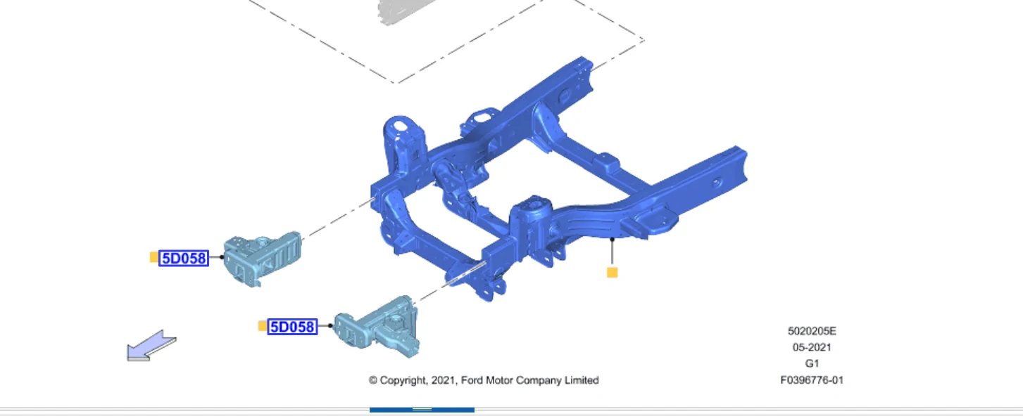

Frame horns the bumper brackets bolt to. They have a front repair section but the body shop will need to put it on a frame rack and take some measurements to make sure the frame isn't tweaked. Procedure manual says frame can't be straightened and requires replacement, some shops would just pull if just a little off to save it from a total loss or panel alignment.

The frame horns are bent pretty far. The mounting hole of the drivers side body mount/crash bar mount is pointing almost straight forward and the pass side is pointed into and touching the tire

How do the light blue pieces mount to the dark blue frame?
As I said they are pushed way over towards pass side
