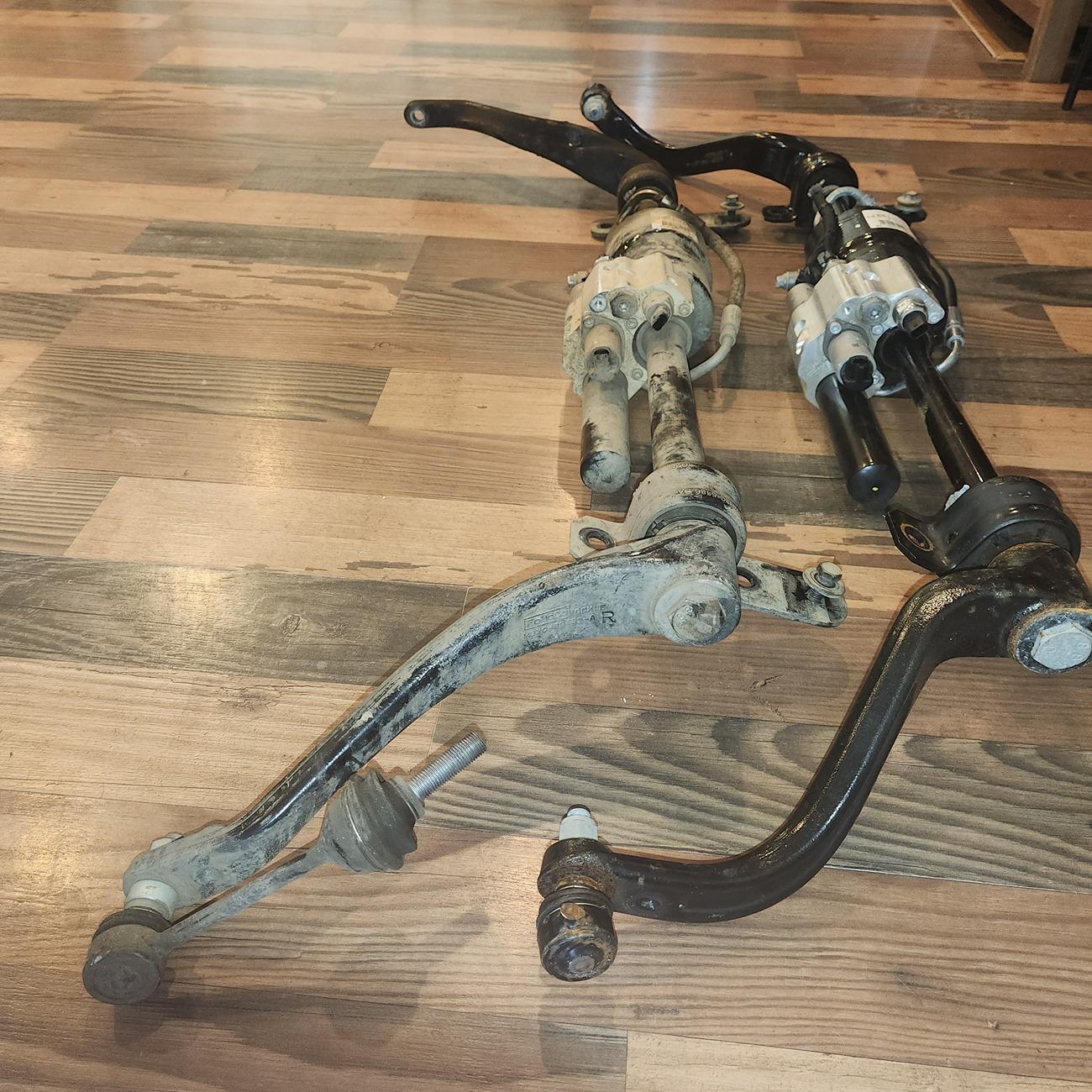

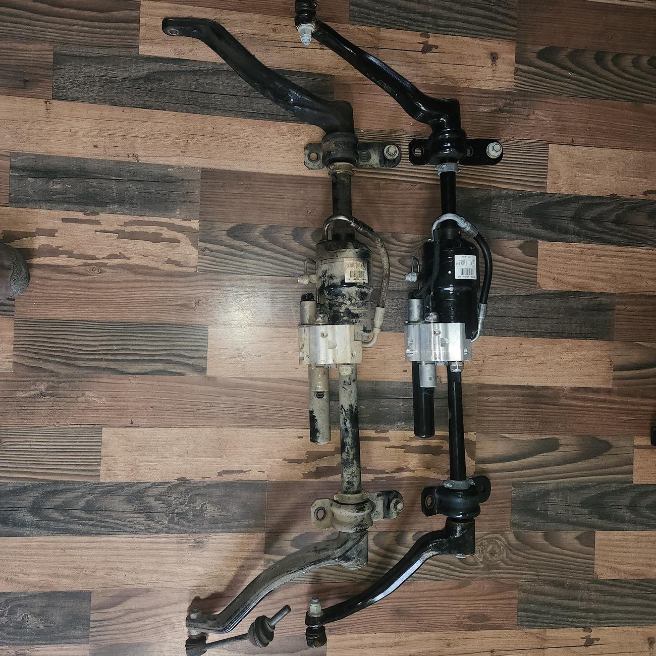

More Braptor parts arrived today 🤪, pics show the differences....and now I have NO excuse for not installing the original on our WT.
Ford Bronco Braptorizing 2 door Bronco... First Edition Warthog... 20240305_112216
Ford Bronco Braptorizing 2 door Bronco... First Edition Warthog... 20240305_112257
