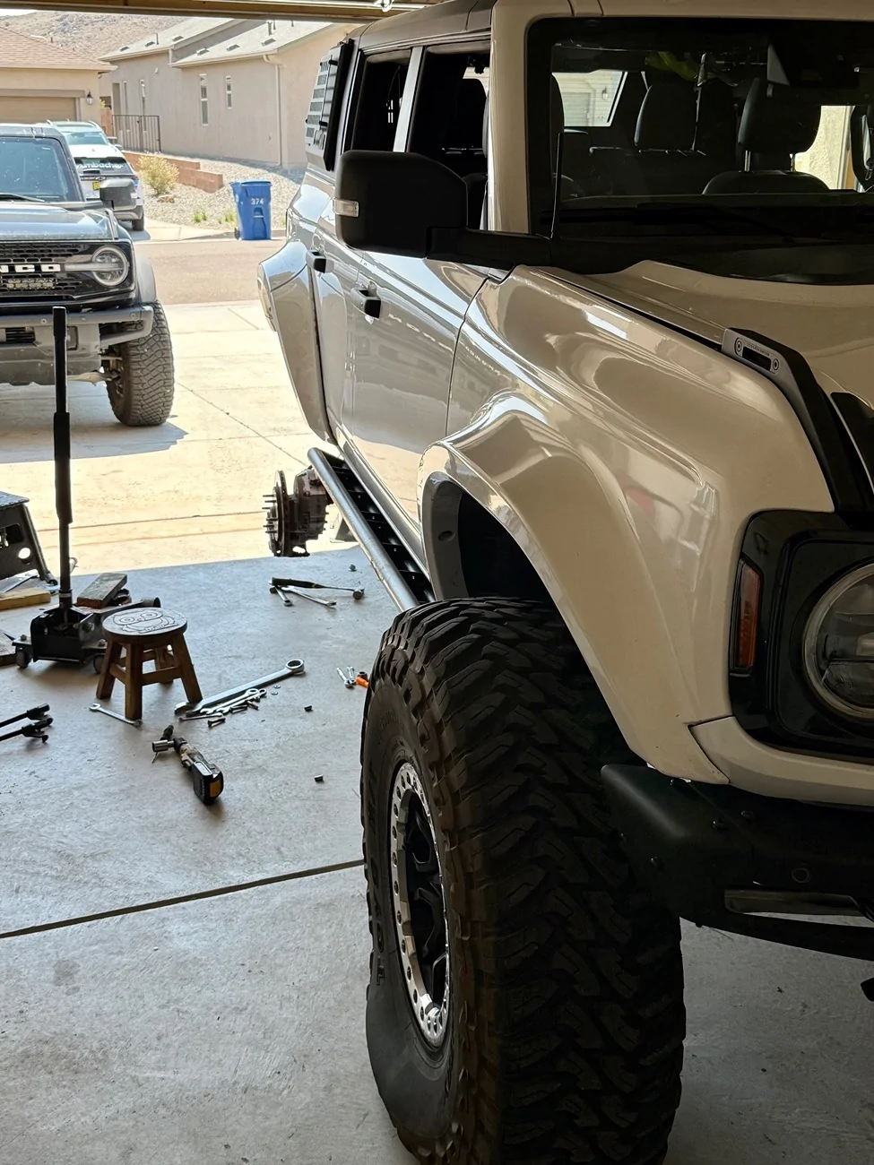

Could be worse… I have an easy up just behind my gate. It’s still 105+ out there

U gonna do the mods to the frame too? IIRC the front coilover pockets are way taller, and the UCA mounts are double shear. Not sure what they changed underneath
Correct, I wound up building making new UCA mounts with double shear on BOTH sides of the UCA.

Everything about your build is badass and well thought out. Really looking forward to seeing it finished and out there wheeling with the Cheeps.
