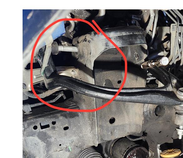

There's kind of a solution for this you can just get upper a arms that are exactly 2 in over length if you can get somebody to sell you those separately. However I thought about doing this, purchasing a set of icon Bronco Billet ucas with the Delta joint Pro, and taking out the FK bearing on the inside mounts and purchasing new FK bearings with a longer threaded stud. I have seen where they are available in different lengths. You could also sleeve the threaded portion that was unburied in the UCA. This would probably be the easiest bolt on solution. But don't allow for a longer shock/coilover...
However, for those that want to run jumbo tires and intend to cycle the suspension "Raptor Style" the normal mounts on the frame of the standard Bronco are minimal at best, the Bronco Raptor has a double sheer on the rear Bolt,(beefier)and the F-150 Raptor has double Shear on both the front and rear bolts. (beefiest).
Recently, during King of the hammer, Lauren Healy bent the 4600 a truck UCA mount badly inward against the engine from a big hit on a rock.
I like the wider STEEL Braptor/DR UCA and the double sheer mount much better.

Hold up, I just called Fox and they set me straight if you unplug it it goes to full stiffness and stays that way. It needs to have five volts provided to the coil to release and RPG sells a kit to do just this, either way I'll be just providing 5 volts to them initially and then later on either buy the RPG kit or wiring the factory stuff and change my ECM parameters to Raptor ones.... I'm just gonna buy Braptor Coilover buckets and weld them on the frame.
this is true , when swapping my UCA I bent the live valve bar
And with it in hooked
It was at full stiffness till I fixed it next day

I like the idea of double sheer on this
It urked my OcD that only 1 side was supported good
I wonder if it’s for crash testing head on

@Yamapro and others have broken that UCA mounting bolt with a long travel setup. It will benefit from double shear.
increased length LCA increases wheel travel for same shock motion, but nothing is free. loads go up accordingly due to increased moment arm or leverage. You are definitely going to want any increased strength and stiffness you can get. Especially with 40s.
Yep, the double shear is definitely a benefit. If I keep my Wildtrack, I will definitely end up converting mine. Bigmeatsbronco I’m interested if you end up making a weld on kit for the double shear and heightening of the coilover

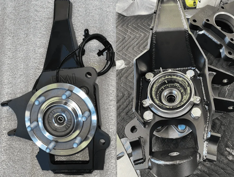

Rather than try to modify or change the above issues, After a lot of research, I've purchased a set of Gen 3 f150 fabricated knuckles/uprights/spindles from @GregFoutz ...
This will allow the Braptor A-arms to bolt onto the new knuckles. From there I intend on Machine work and modification to use modifed 35 spline F-450 unit bearings or Spidertrax bearing...this is far stronger and rebuildable. I may re-drill the Braptor rotors and use them with F 150 Calipers. this will also require a new 35 spline stub axle as well. with ABS sensor Incorporated too. I'll likely also use the f450 lockouts or hubs so the front can freewheel in 2wd on longer trips.
This will not be cheap.and requires time to gather parts and get everything machined correctly, but it will be extremely strong and should work well.
The goal is over 15" of wheel travel similar to the DR.
By the time I'm done I'll have a complete extra set of Braptor UCAs and LCAs if some wants to do a similar set up. I also have a RangerRaptor LCA I'm not using.
