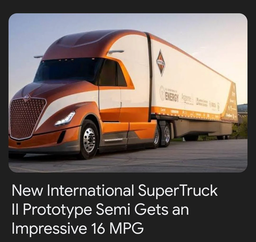

I want whatever mode this has... same mileage I get with my BL 2dr. 🤯
Ford Bronco Best Mode for Highway MPG Screenshot_20230626_202513_One UI Hom
(I know it's a hybrid.. but that's mind-blowing).
