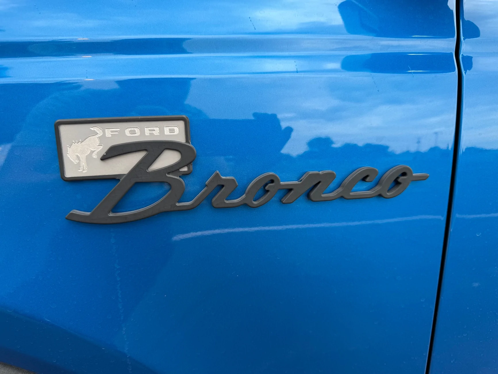

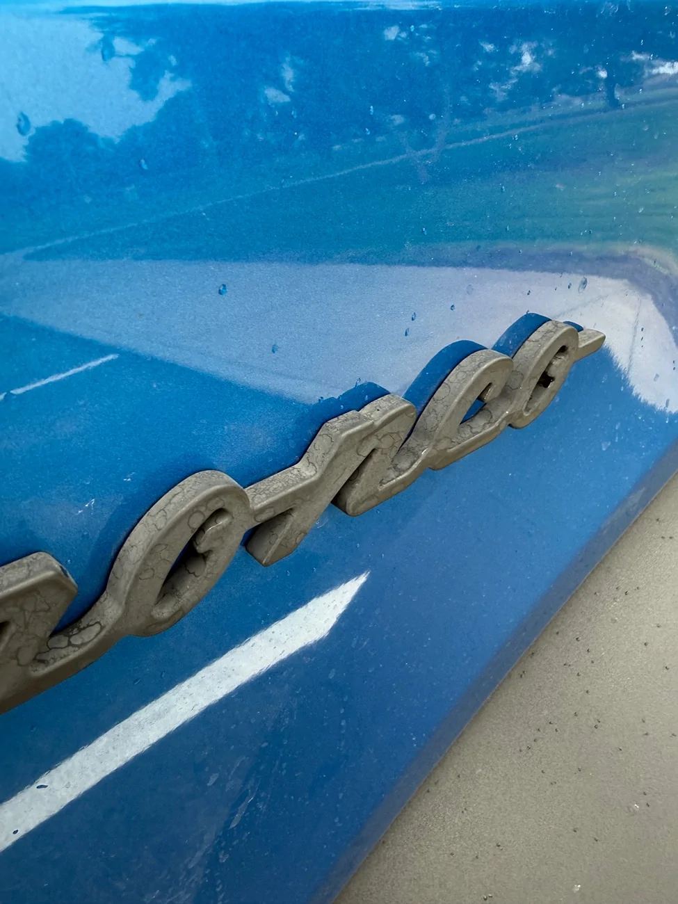

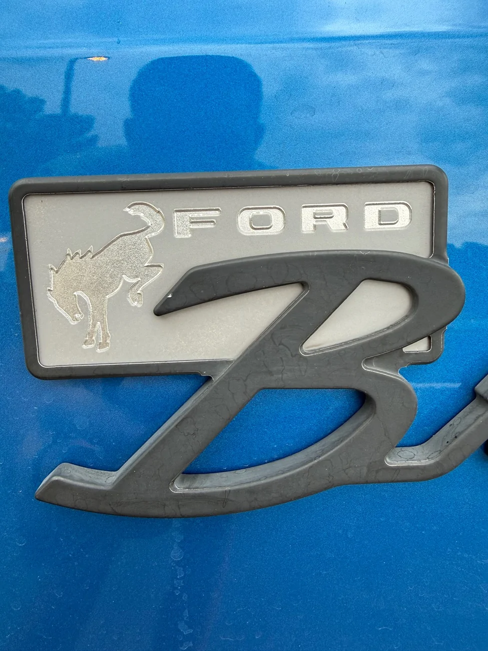

I’m thinking of removing my Archetype Racing script badges. If you all remember from a couple years ago, these took forever to get and were claimed to be of such high quality, but then Archetype Racing went out of business and now I’m left with faded badges. I’m thinking of removing them and replacing with another badge type from Etsy.
What damage to the paint do I risk when I remove them? They are rather large and have 3M VHB adhesive behind them. They are stuck very well. I’m aware of the basic procedures to remove them (heat gun, floss, etc) so not worried about the process but rather the potential paint damage from the adhesive. Will my clear coat be stripped and left with a “ghost” script on the paint?
Thank You
