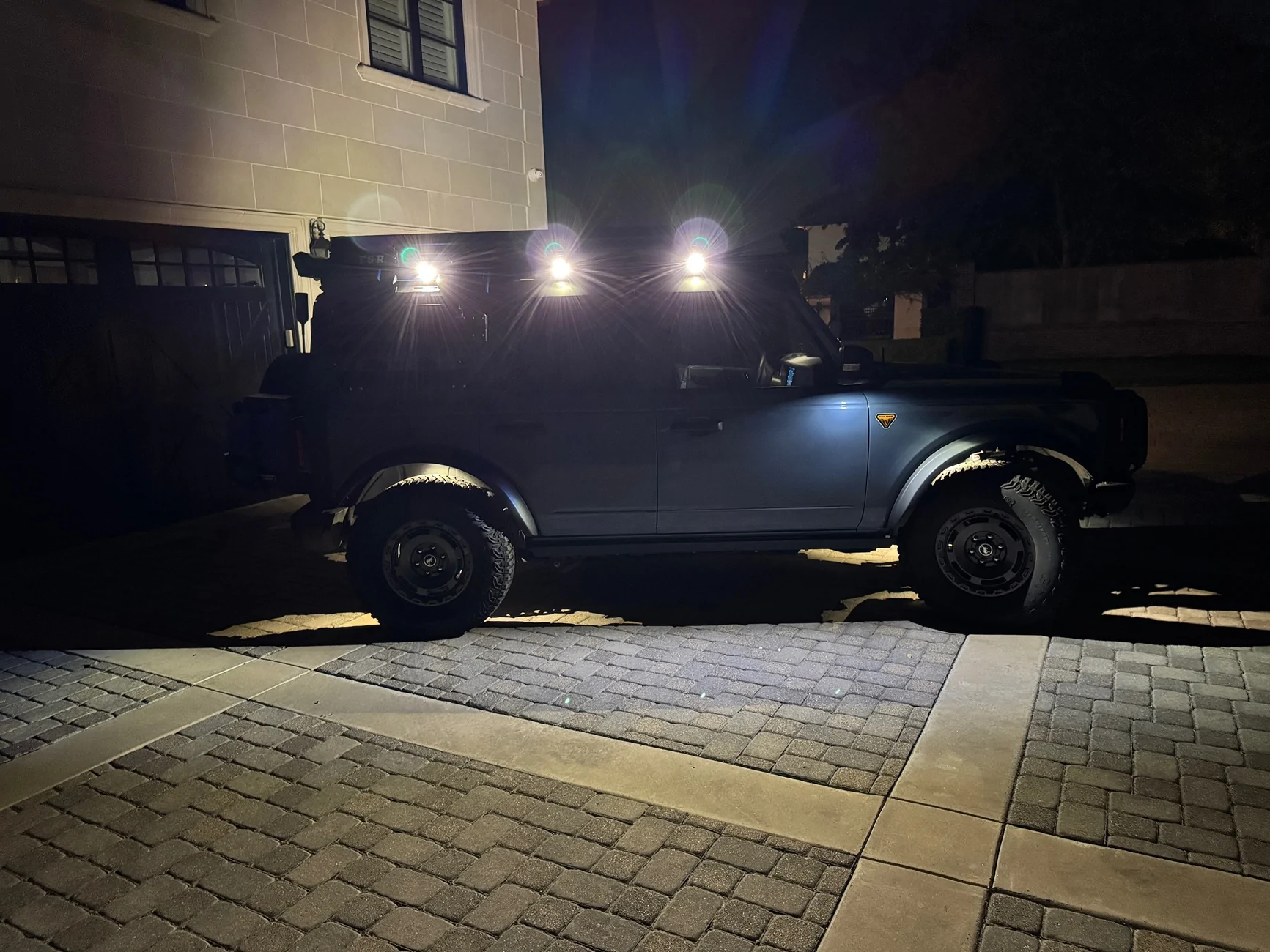

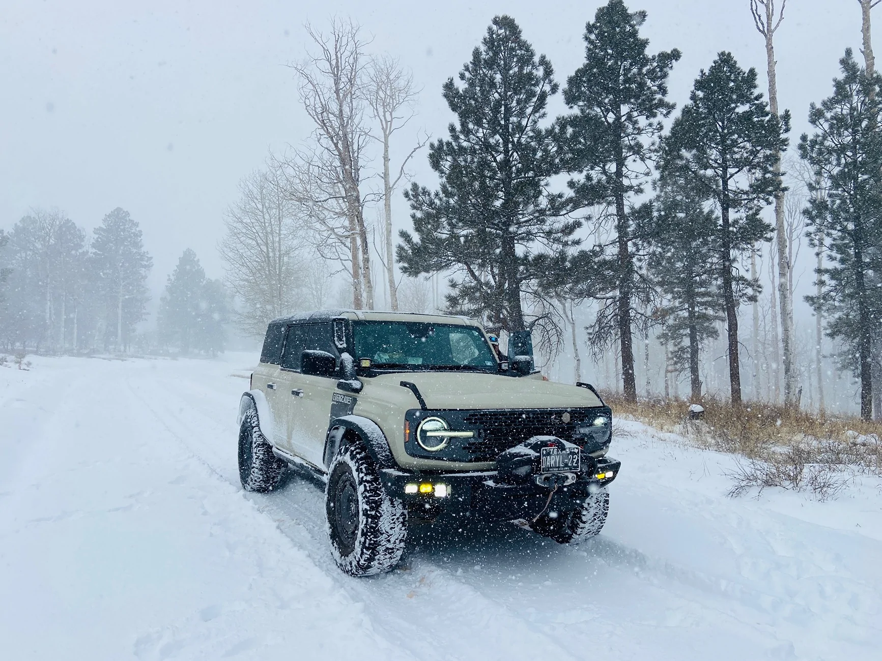

I’d get another set of yellow fog lights that aren’t street legal. The ones you have wired are probably the SAE approved ones which in my experience were kinda useless last time I drove though a blizzard. I’d rather get a ticket for offroad light use on the street than not being able to see more than 5 feet. (I live in the Colorado mountains)
Other ideas are rear facing dont tailgate me lights, side mounted marker lights that also double as area lighting, and some lights in the trunk area. Just keep in mind the aux switches only work when the vehicle is on, so you’ll want to wire the trunk lights to the battery or always on fuse instead.
Also I have the tailgate air compressor and it’s awesome. Even if you’re not off roading a bunch, it’s nice to be able to top your tires off whenever and I’ve helped two people now with patching their flats and filling the tires with it.

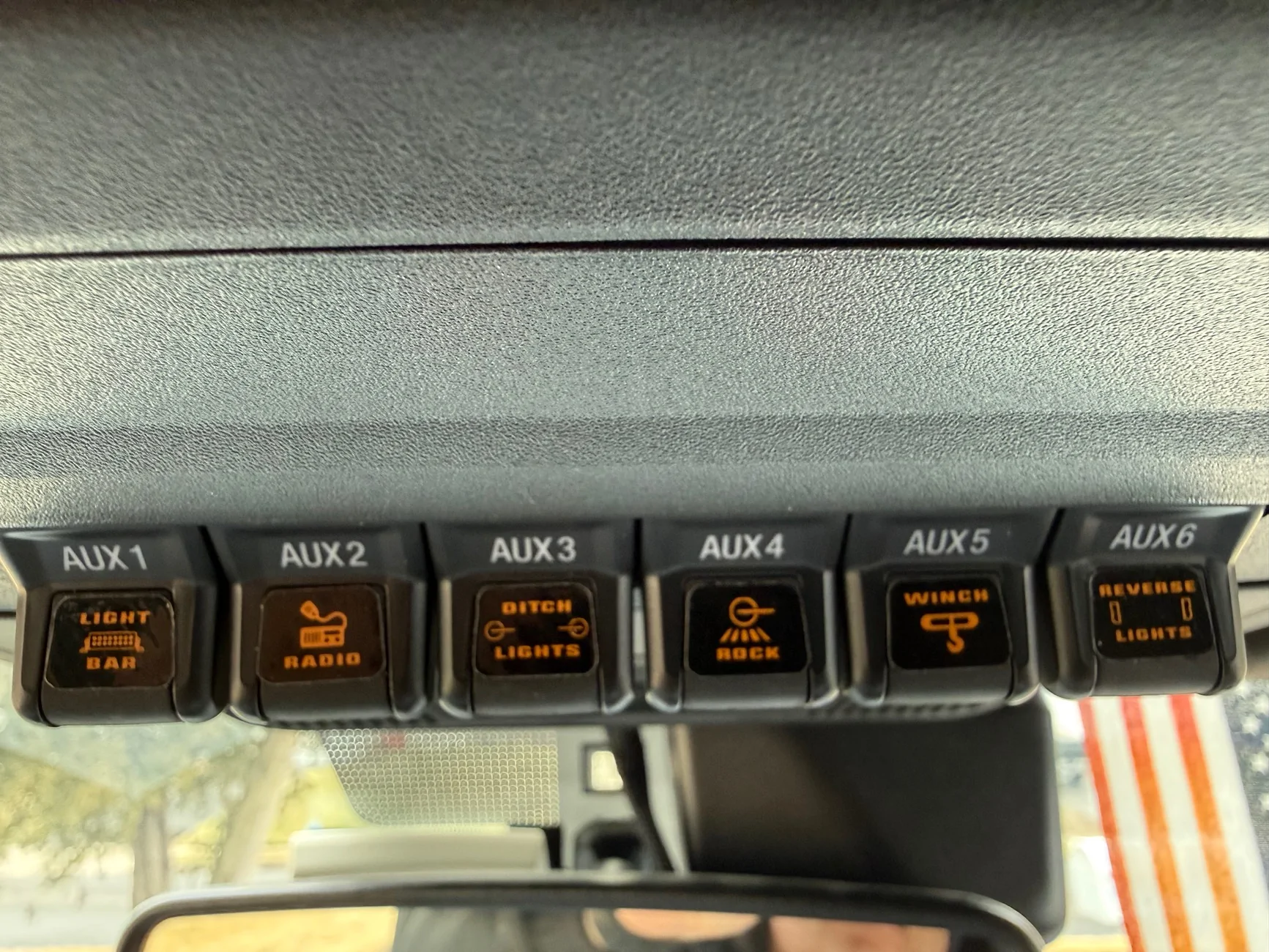

I asked the same type of question back in late 23… now they are all used…

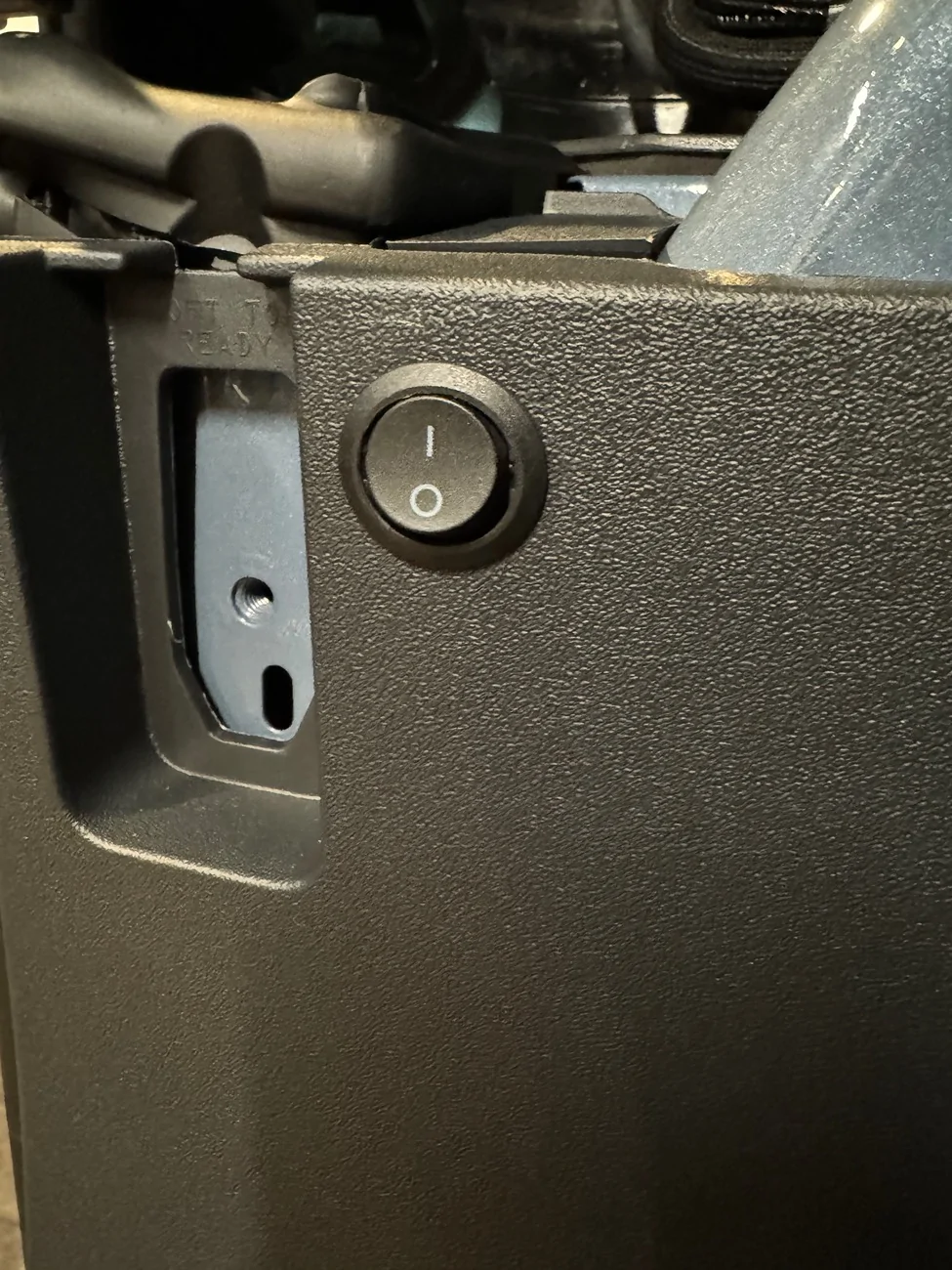

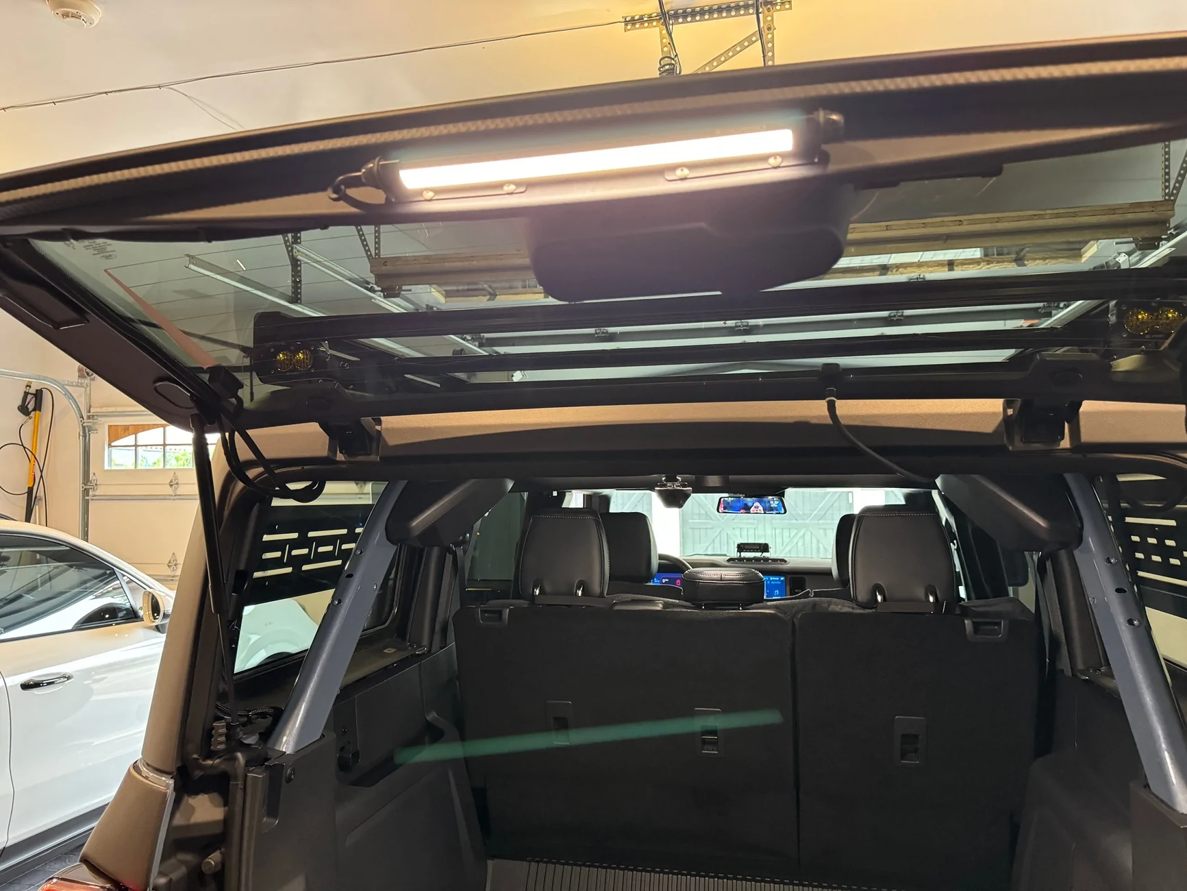

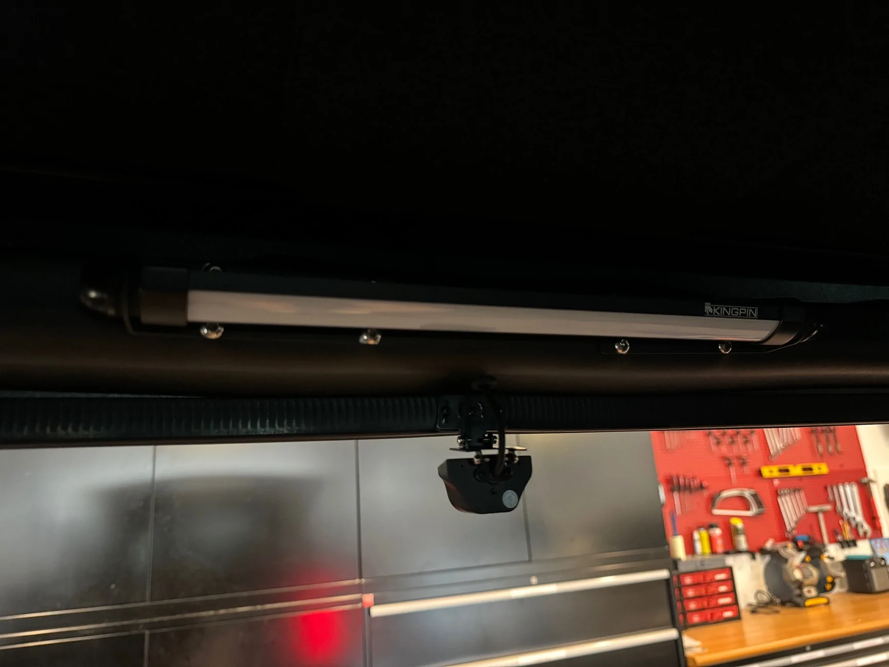

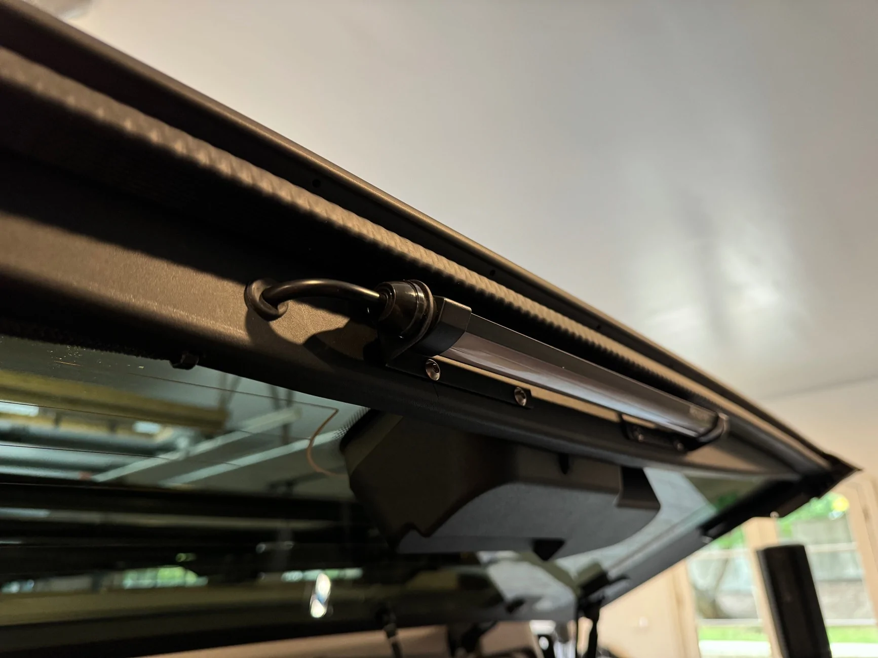

What's that rear hatch window light?
That’s a kingpin light. I mounted one on the window that you see, and another on the cross bar of the ceiling in the trunk, all wired to a switch and then to an always on fuse under the steering wheel.
