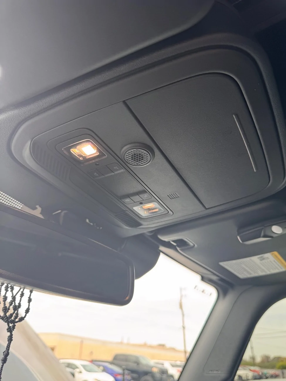

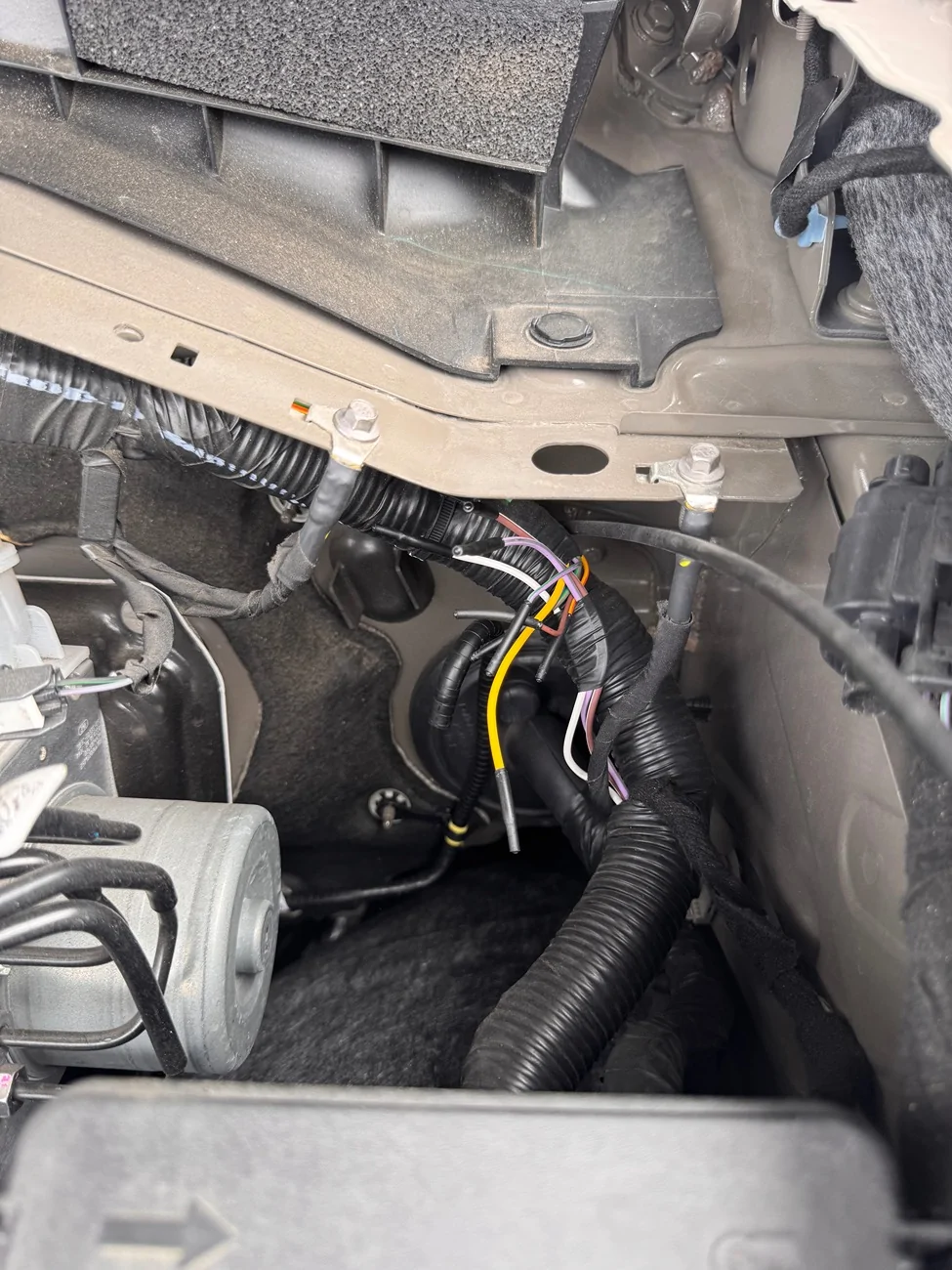

Hey Bronco fam. I noticed my Bronco has the aux switch wires pre installed but no auxiliary panel. Are some Bronco pre wired? Not sure how easy or difficult it would be to add the panel and replace the glasses case.

If you want the oem kit from ford, it’s in the link below.
https://performanceparts.ford.com/part/M-9100-BR
I’ve installed this personally and it takes about 3-4 hours if you’re handy and have all the tools you need. This kit has its own wires and abandons the factory pre-ran wires. You only get 4 switches though.

Yes the wires are there but there is some work besides just adding the Upfitter switches. Here’s a prior post from the forum.

I installed the OEM Upfitter switches on my 25 OBX. I bought the complete kit from Middleton Motorsports. When ordering, I overlooked that the kit was only for 21 - 24 model years. I didn't realize this until I was attempting to install the wiring harness. After contacting Middleton Motorsports, I learned that the 25s have a different harness and fuse box. They were extremely helpful had the correct harness and fuse box on the way the same day. All things considered it was a straight forward install. However, you may find that reinstalling the sun visors are an absolute PITA.

Ha! That’s something I would have overlooked. Mine is a 25 Outerbanks. I’ll definitely check the part# when I place the order Thank you for that info
