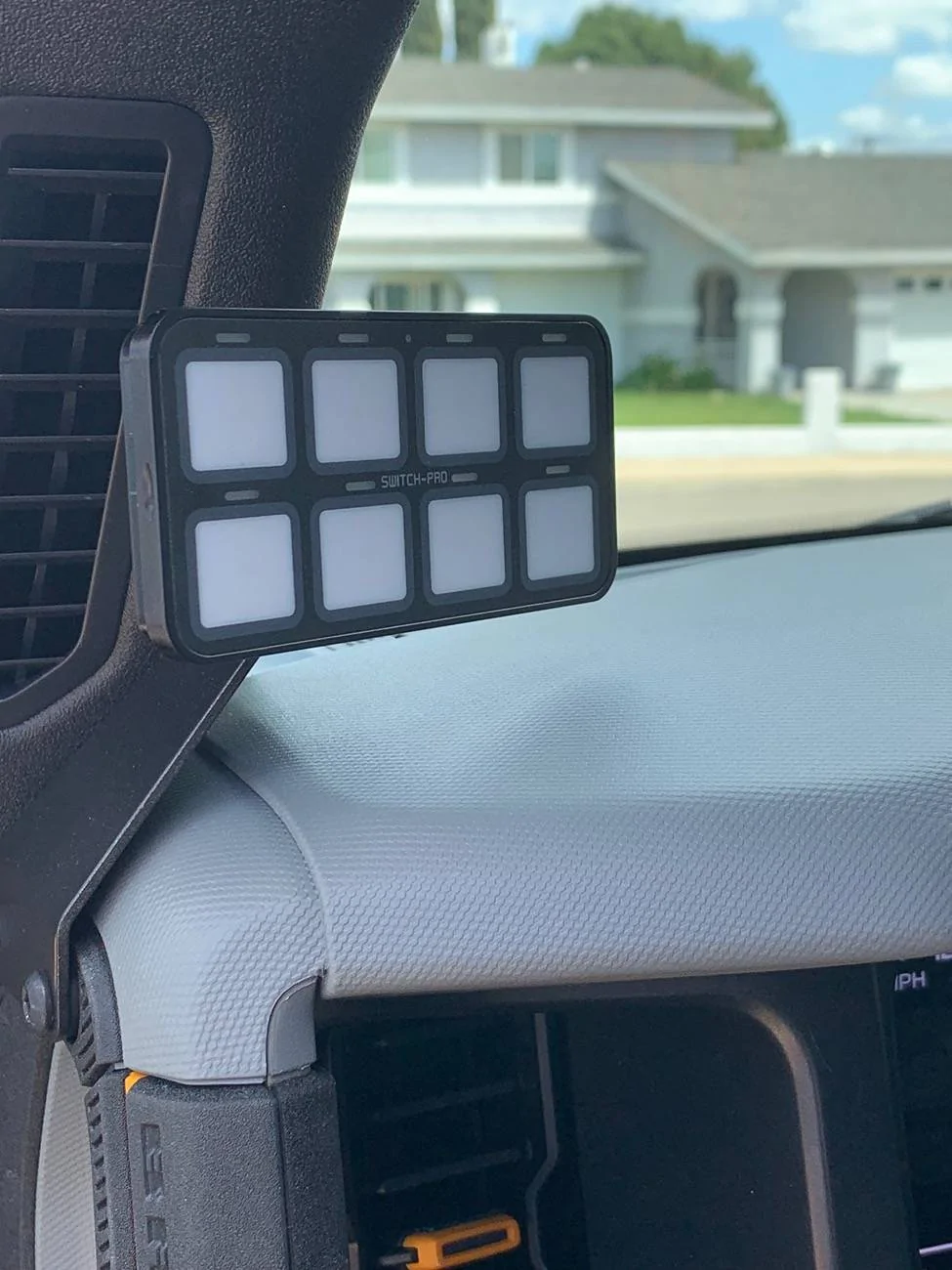

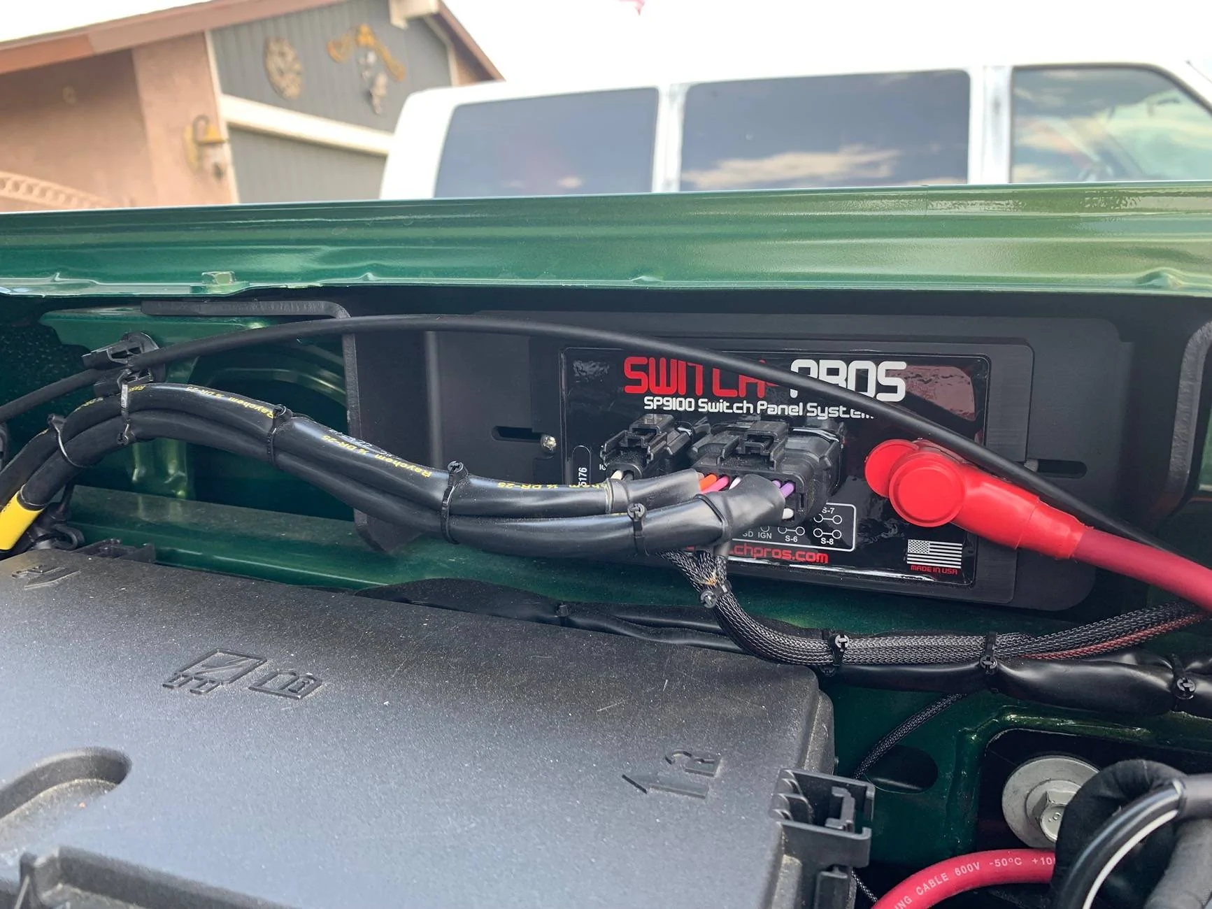

I added the Switch Pro.

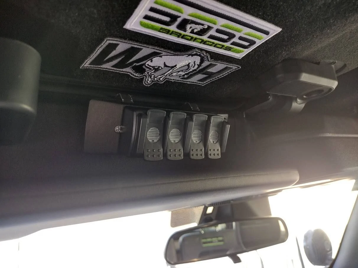

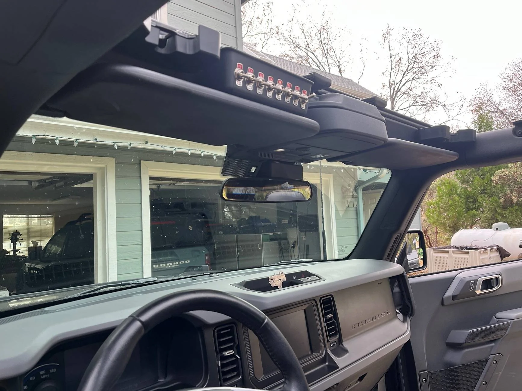

I wanted an old school look for mine with the old snap toggle switches. The case was ... something I found that fit the location I wanted without going directly into the upper trim panel. It's held up pretty well so far.
I used a pre-wired 6-relay panel from amazon, so I have 6 relayed switches that can go up to 40A and 2 direct low-current (<= 5A) switches.
Currently only using 4 (Rear locker, Driving Lamps, Aux Lamps, Lamp backlights/Lighted Bronco grill letters).
Figured I'd probably want one for a Front locker if I ever upgrade to that. Saved a low amp one for an interior light kit I have but haven't installed yet... that gives me two more. May run a second high-amp rear power point, a stinger for a winch, the swaybar disco, or an onboard air compressor if I ever do any of those upgrades later on.
