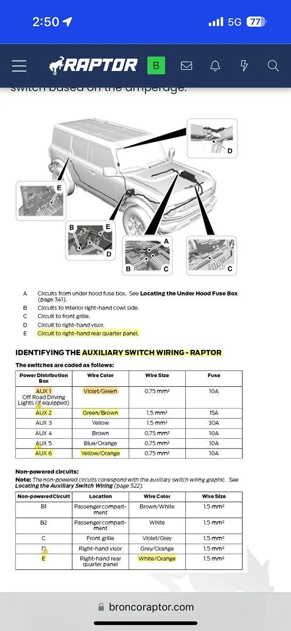

The OP didn’t make it obvious, but he has a Raptor….. so all those that have commented prior on this thread (and don’t have a Raptor) don’t know that the Raptor Fog lights come wired to the AUX 1 switch from the factory.
I have included the info you need (which is different for the Raptor than the regular Bronco AUX switches.) AUX 3 has the biggest amp allowance if you need it for your light bar.
That's exactly what I needed to know! And it's my own fault for not stating at the git go that it's a 23 Raptor and since it's only a month old, no one else has worked on it. I installed some ditch lights that have an amber as well and used 2 for the lights and 4 for the amber, saving 3 for a light bar and then 5 for the amber. 6 will power the Valentine 1 and I'm all set (for now, we all know it's never done)I'm 75 now and been doing this since I put aircraft landing lights on the roll bar of my 72 Silverado 4x4. I have to get older but I don't have to grow up!! LOL

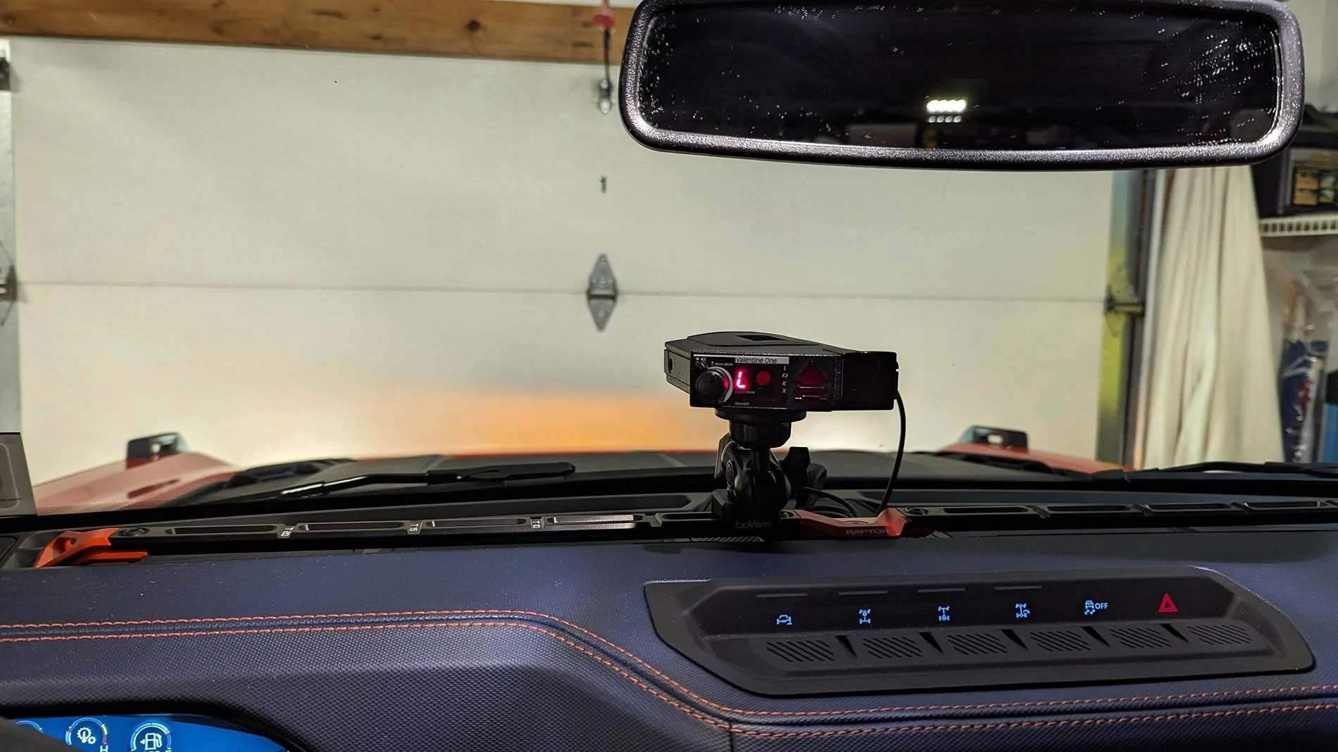

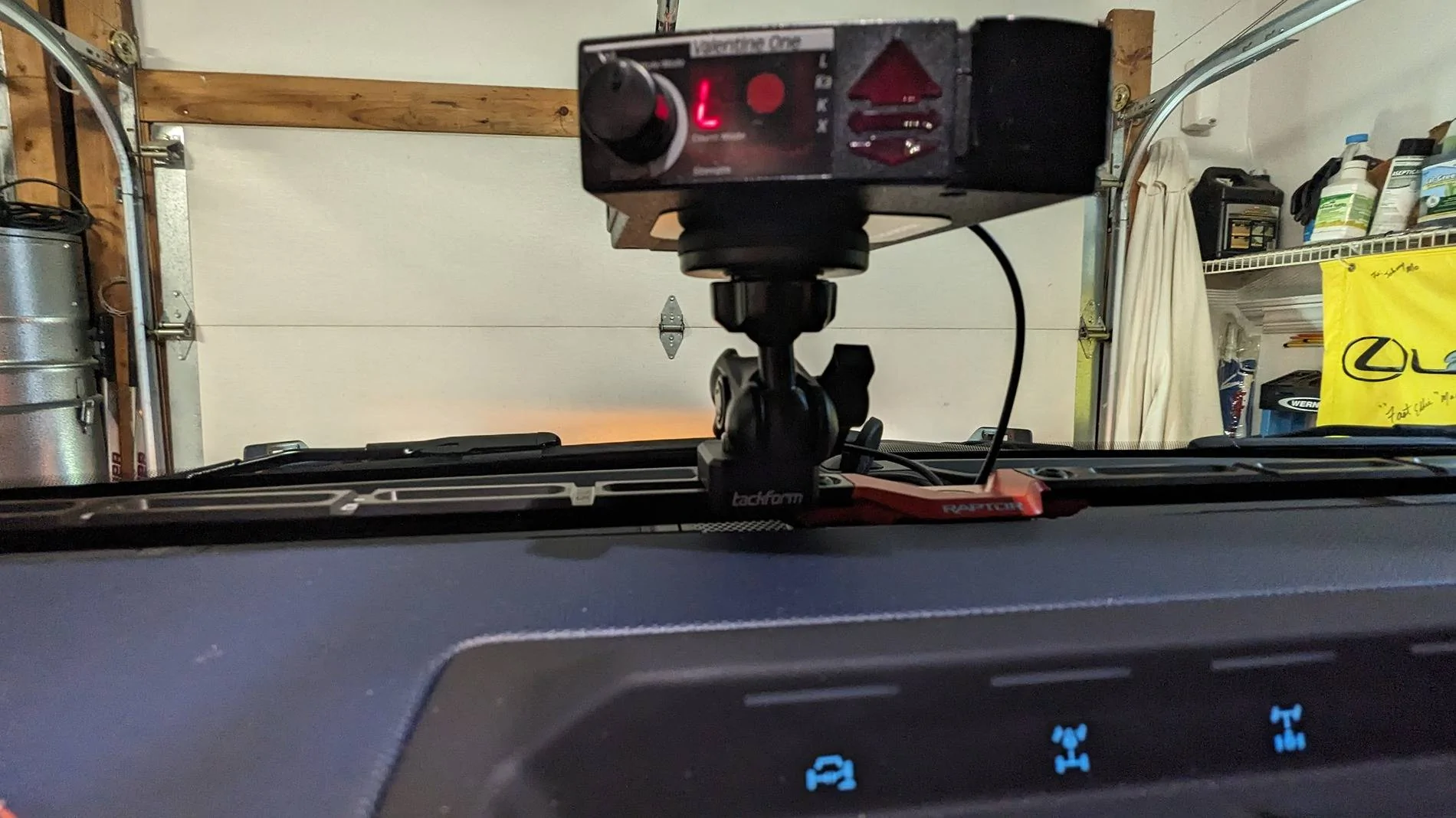

Mount your V1 to the rear view mirror stalk with a Blendmount mount and power it there with Blendmount Power taps.
Professional installation with No need to waste a switch on it.
Good luck
Or mount it on a BYOD rail and power it from the USB-C. They make an adapter now that works.
