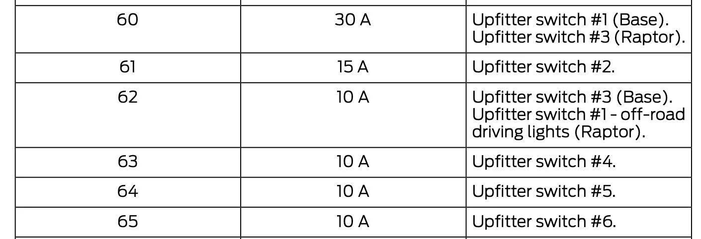

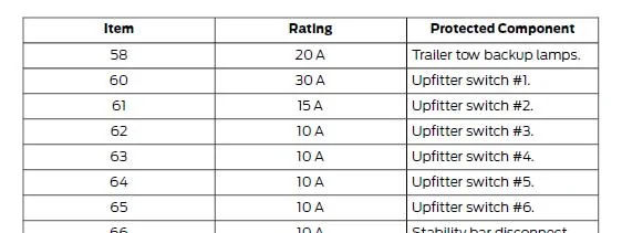

From Owners Manual:
Ford Bronco Aux switch fuse location 1736434041901-2f
Ford Bronco Aux switch fuse location 1736433945379-u

From Owners Manual:
That is NOT correct. The OP asked about the Bronco Raptor...
The Bronco Raptor 1-6 AUX switches are:
AUX1 10A Violet/Green
AUX2 15A Green/Brown
AUX3 30A Yellow
AUX4 10A Brown
AUX5 10A Blue/Orange
AUX6 10A Yellow/Orange

yeah... i found what i need from the manual.... found the blown fuse :)
Ford Bronco Aux switch fuse location Screenshot 2025-01-09 at 10.49.00 AM
