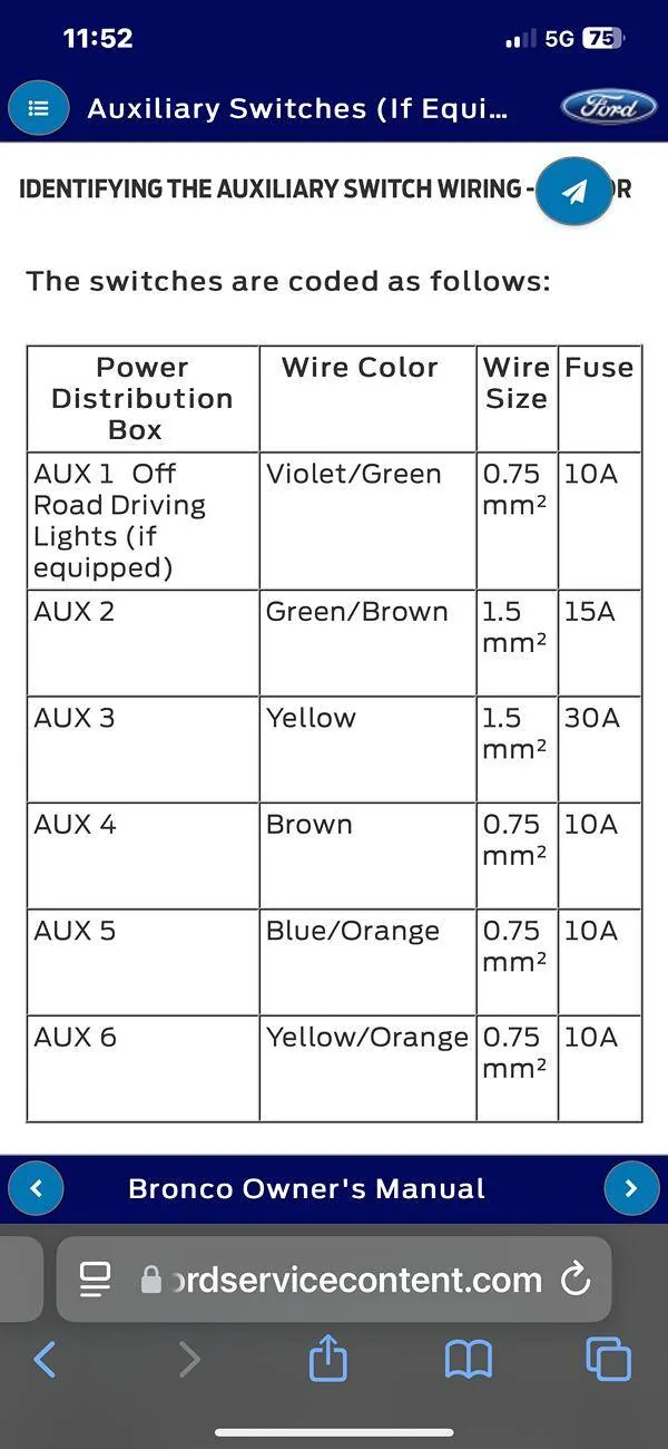

Getting ready to install a 40" light bar and I see the circuit I want to use (highest amp) is AUX 1. Isn't that already in use by the Rigid lights from the factory?
The Bronco Raptor has a different wiring diagram than lower trim level Broncos. Here is what’s connected to each switch.
Aux1-10amp, Aux2-15amp, Aux3-30amp, Aux4-10amp, Aux5-10amp, Aux6-10amp.
