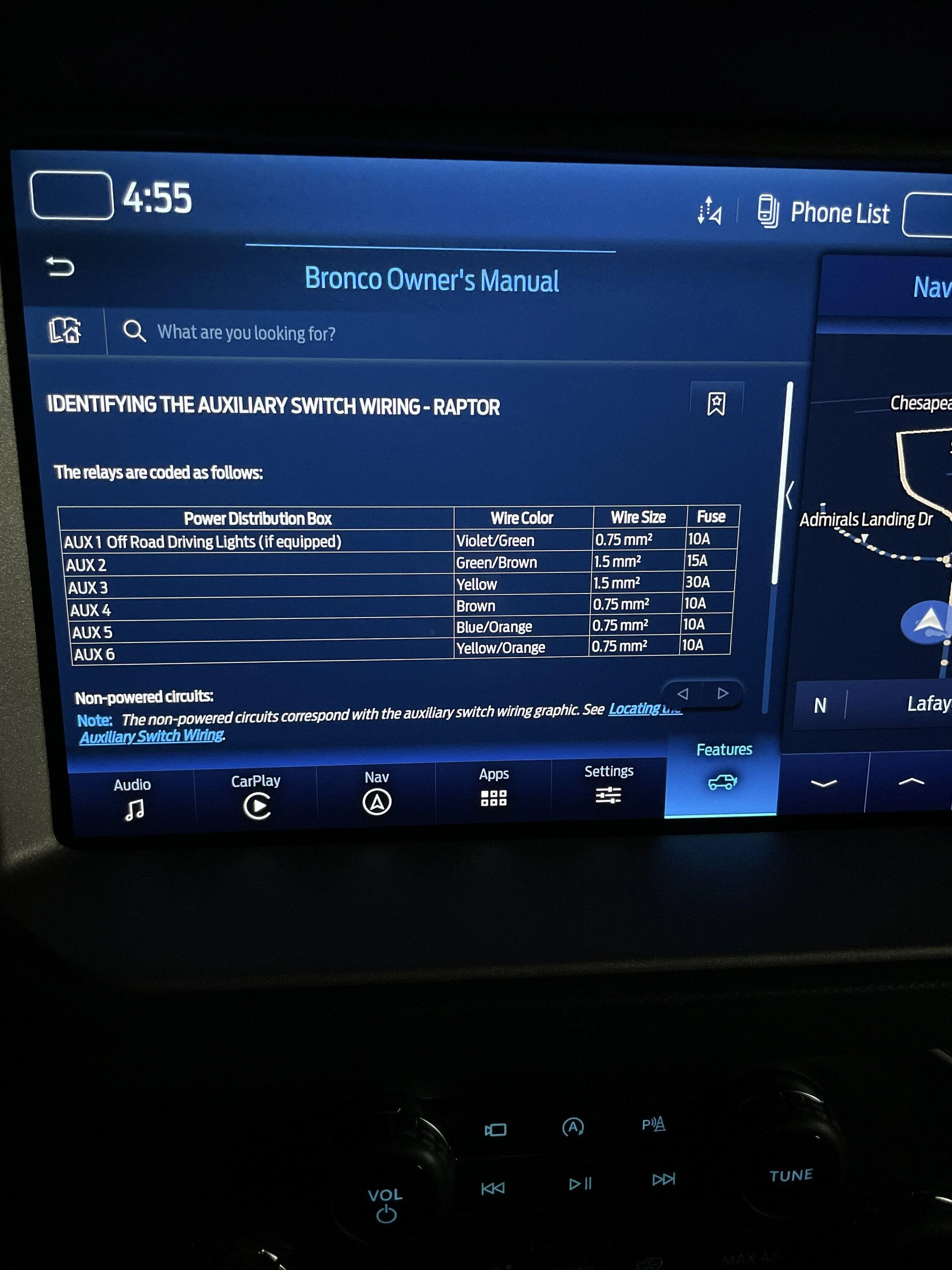

Looks like AUX 1 for the Raptor is 10 AMP and AUX 3 is 30 AMP.

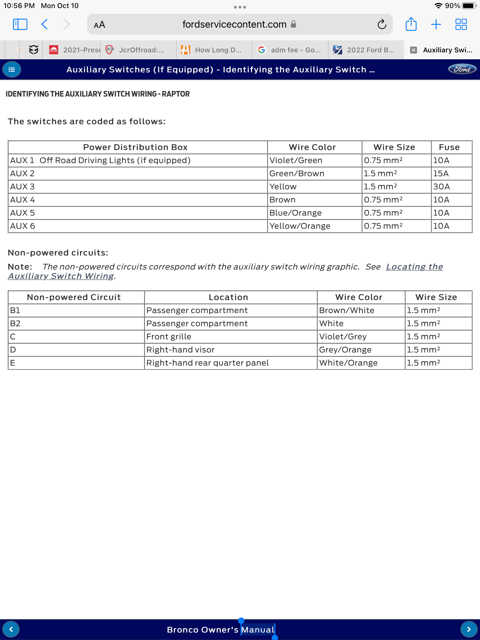

Exactly what I was looking for!
Good to know I don’t need to rework anything beyond connecting the light bar to Aux 3.

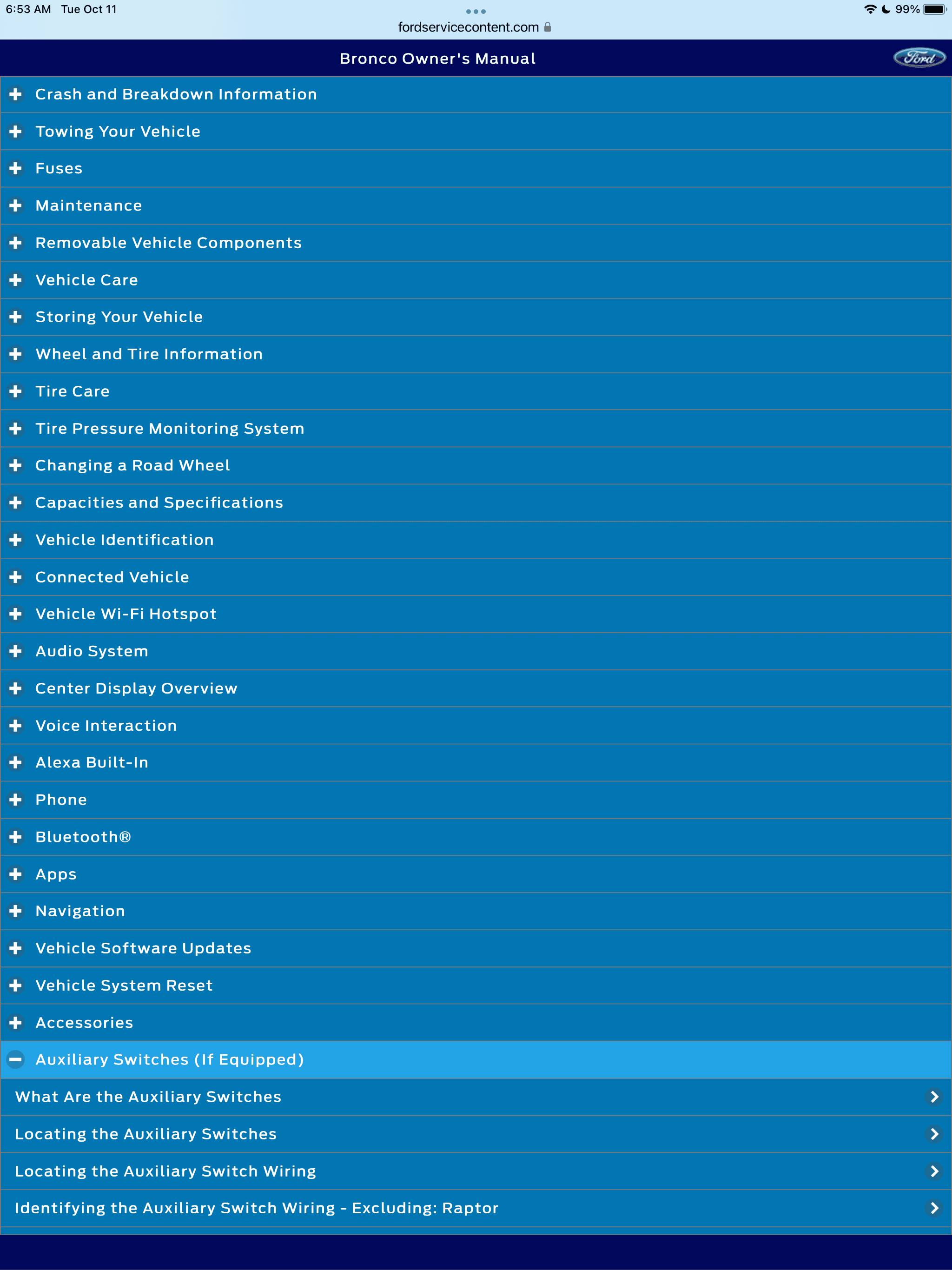

I was curious too when I saw your question. I’ll be adding a light bar soon and possibly other lights as well. (I’ll be adding the 20” Heretic light bar and was advised to connect to AUX 2 [15 AMP]).
I looked in the manual which is also available on line And found that info. No need to sit in vehicle.

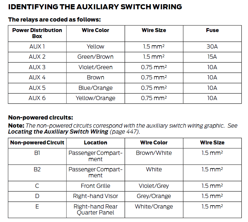

I’d double check that chart
I’ve seen this online also
Always a good call to trust and verify.
Your chart is for the Bronco (excluding Raptor).
The chart posted by NJBronco is the correct “ Raptor)” chart. I confirmed this on the service content website that was where his screen shot came from.
Nice find. I spent some time under the hood and located all the wires. Expecting my wire connectors from SPV tomorrow. I haven't looked at the in-cab manual yet, but I hope it says the same thing.

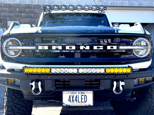

Actually a 40" Bar fits better and we already have brackets for the 40" Baja Designs bar
https://www.4x4truckleds.com/kr-off-road-30-42-light-bar-bumper-mount-for-2021-ford-bronco/
Ford Bronco Aux 1 - Lighting  Use Questions 1667360600775
With that said.. one pair of your factory RIgid fogs is on the fog light switch on your dash. The 2nd pair is controlled from Aux1, which is the higher amperage upfitter.
Ford did this on the Gen3 Raptor... waste of the aux1 if you ask me.
The 40" OnX6+ is 33.6amps, so you would not be using any of your aux switches to power it direct. So you can honestly use any aux you want as you'll be using it to trigger a relay harness for the light bar (which is part of our kit when a 40" bar is selected from Baja Designs).

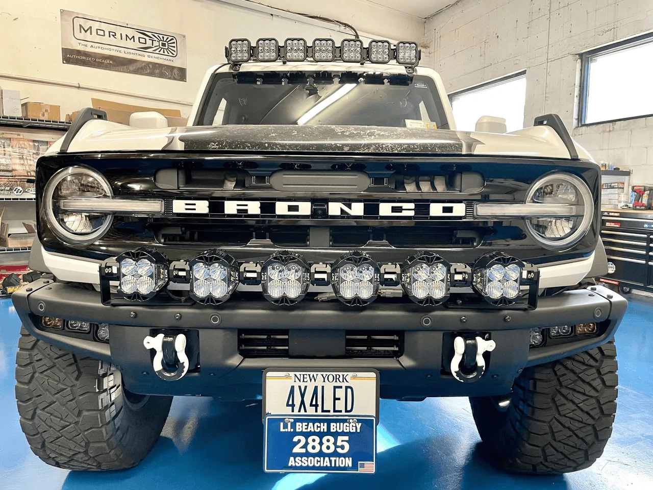

NOW, if you wanna go REAL NUTS, you can do our 6x LP4 Linkable system. We designed this for a Bronco Raptor we are working on this week. We have a few extra kits in stock (it's our own bracket design and we built a few extra).
Here is a photo on our shop truck, but as I said, we'll be moving this to a Bronco Raptor this week
https://www.4x4truckleds.com/baja-d...4-pro-for-2021-ford-bronco-hd-modular-bumper/
