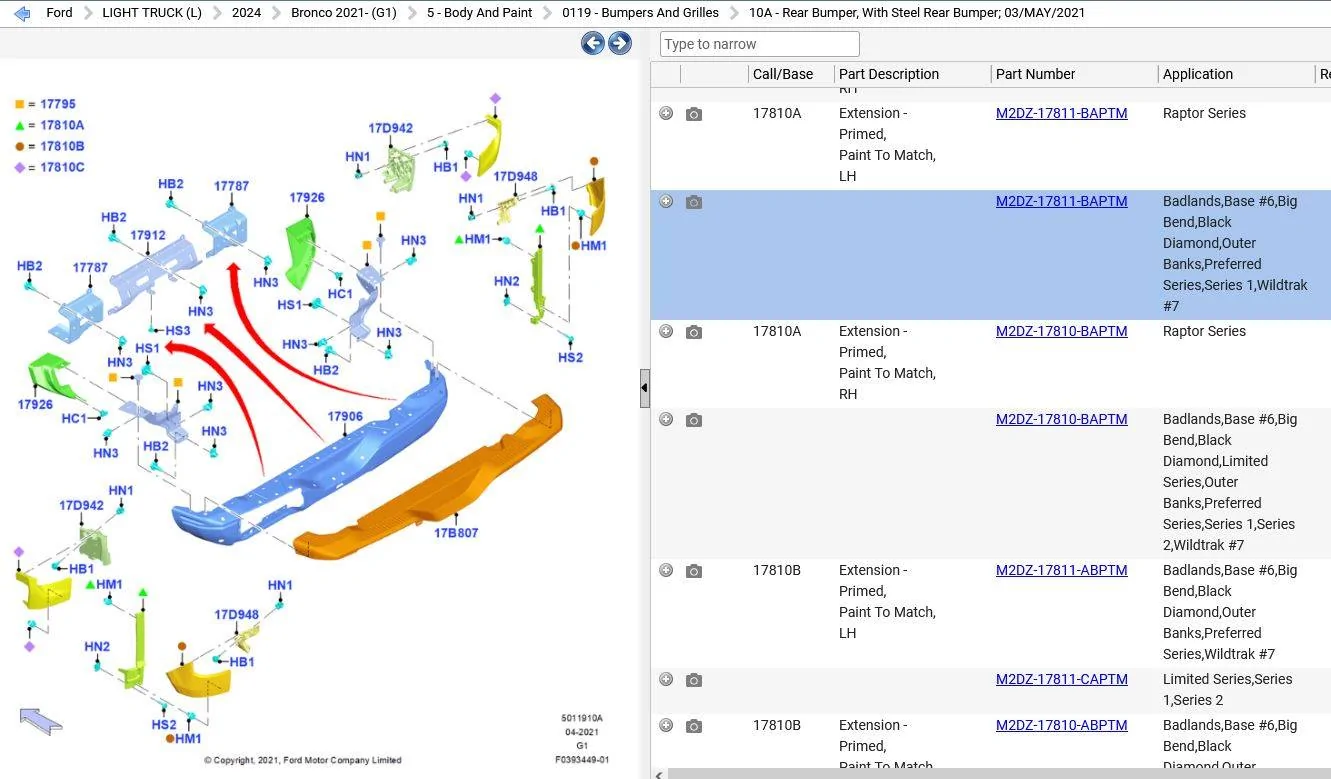

The rear is either going to be the MIC or steel. The Raptor has the steel bumper and that is also used on a number of other Bronco variants, each with some different hardware. Here's a quick screenshot that shows a snippet of differing trim pieces for it.
Ford Bronco Bumper Questions bronc rear bumper

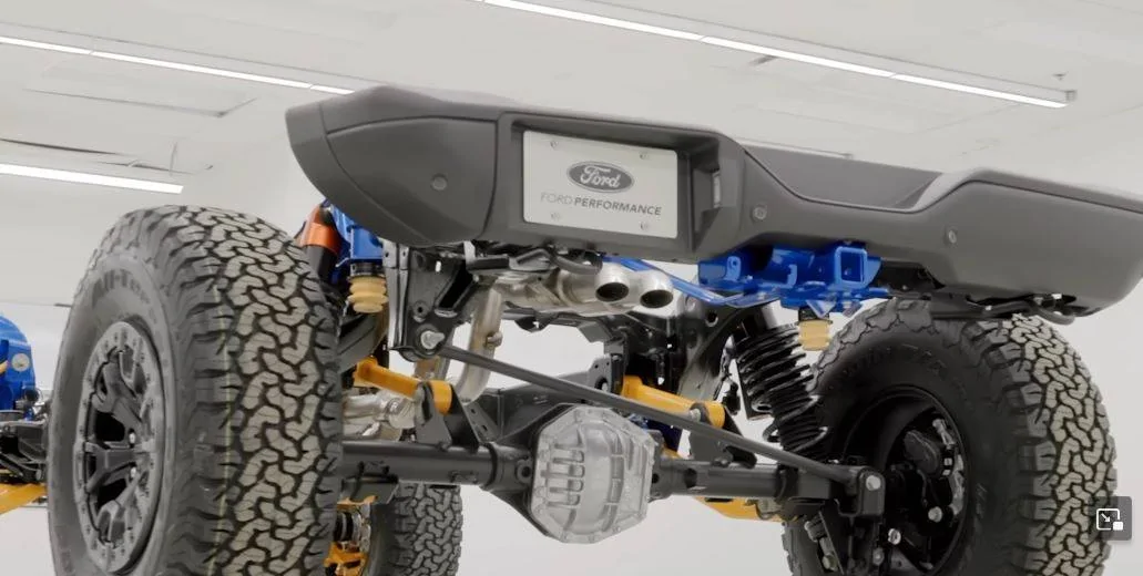

Notice the end cap on the Braptor rear bumper...
Ford Bronco Bumper Questions Braptor i

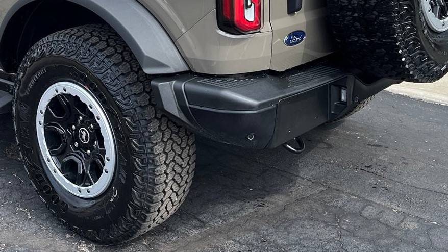

And on the non-Raptor...
Ford Bronco Bumper Questions IMG_7356 crop for bumper

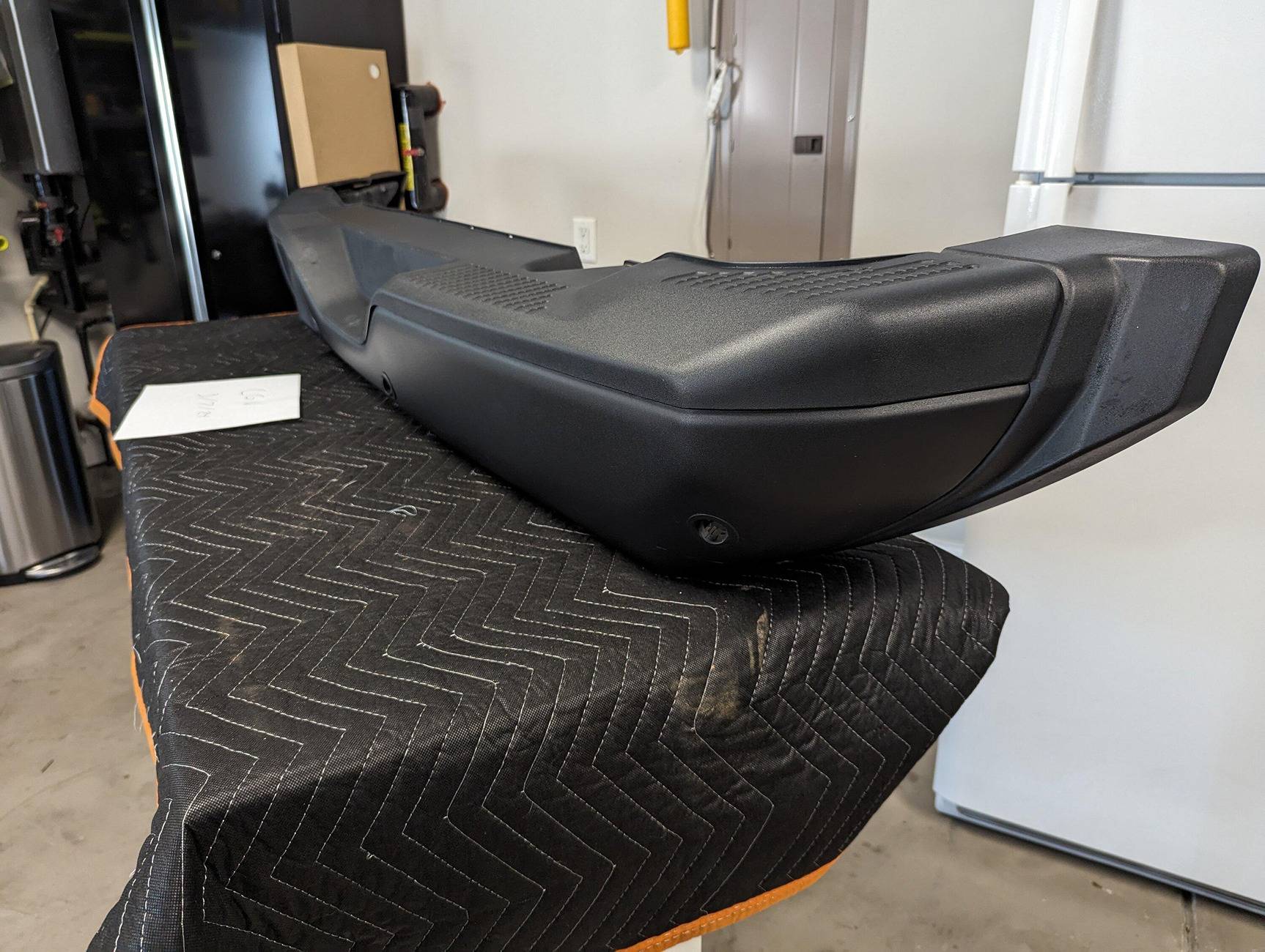

Ford Bronco Bumper Questions PXL_20240307_221433962
