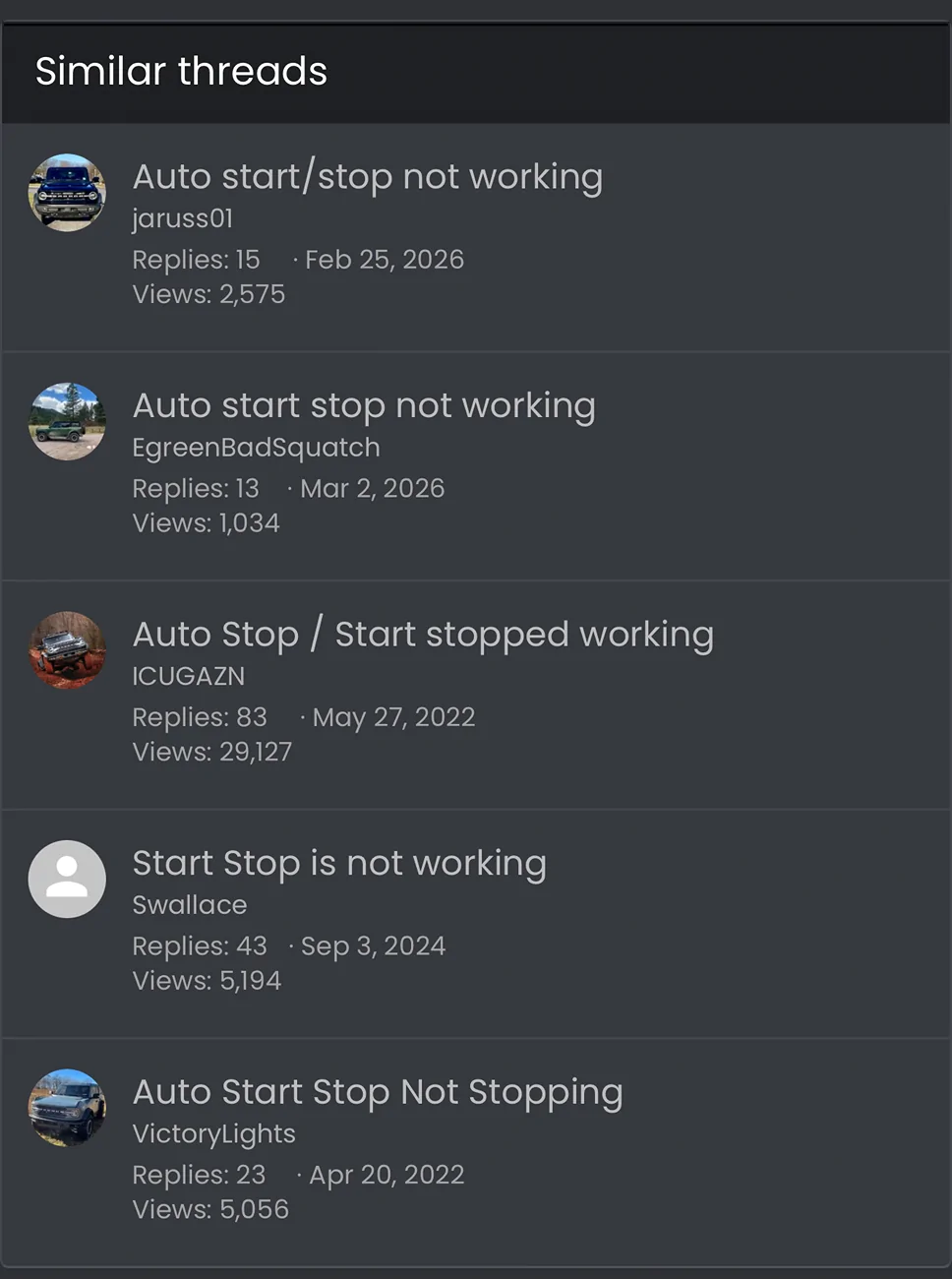

Lots of reasons for it to not work. Many that wouldn’t indicate any type of issue.
I recommend looking at all the other similar thread.
Ford Bronco Auto Stop/Start not working IMG_1306
