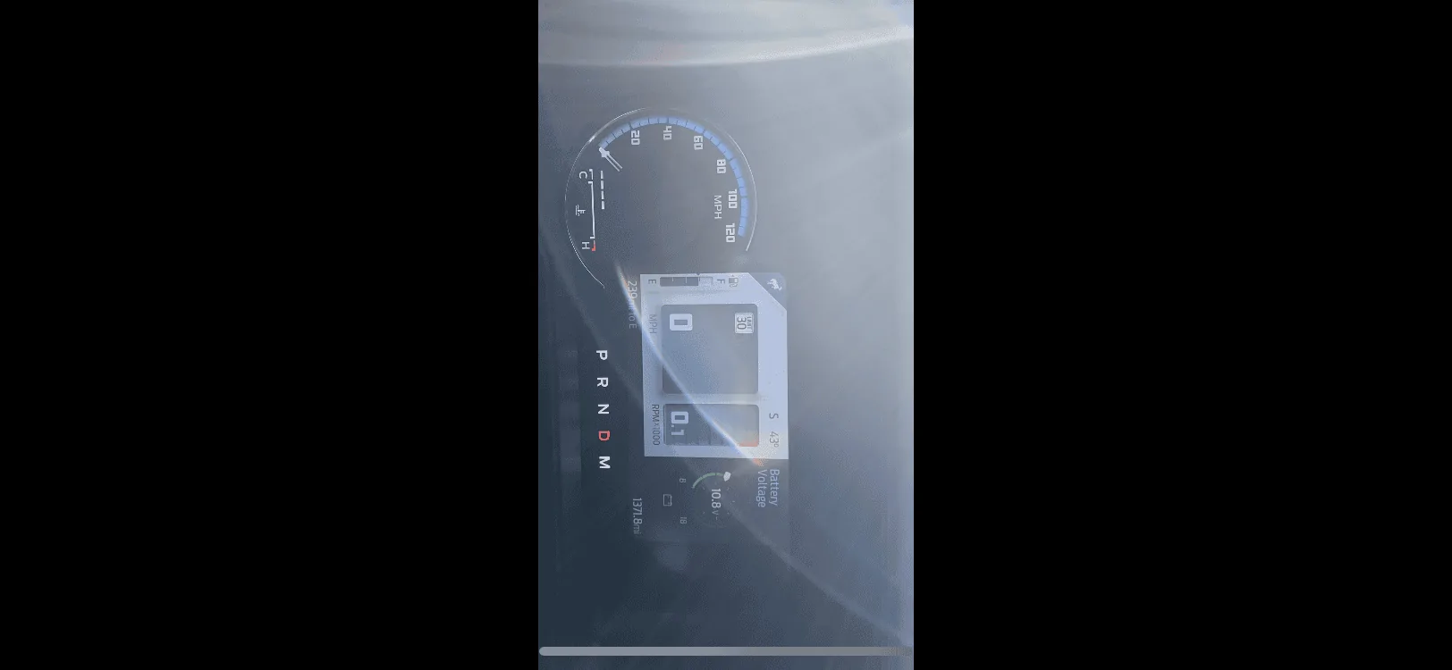

My battery voltage drops to 10 volts every time auto stop kicks off. What’s going on?

If your battery is dropping to 10.5V or lower under load, one of the cells in your battery is damaged, a cell is opening up internally, has higher internal resistance. It won't get better, it will strand you sooner rather than later. Hard starting and the auto stop start stem being inactive are further clues. As the internal resistance gets higher, will also beat up your alternator as it has to push harder to 'fill' the battery. I suggest you get the battery tested and changed as needed.
