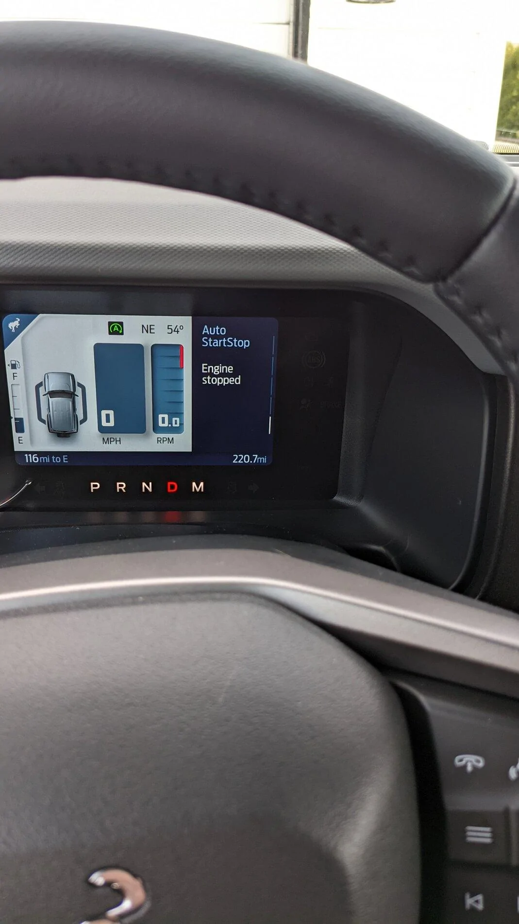

someone may have already said this, but there's actually a screen (I forget how to get to it exactly) but it'll tell you why the auto start/stop is or isn't active.
i.e. the other day it didn't come on for me and I happen to come across this screen and it said it was because the car was still heating up.

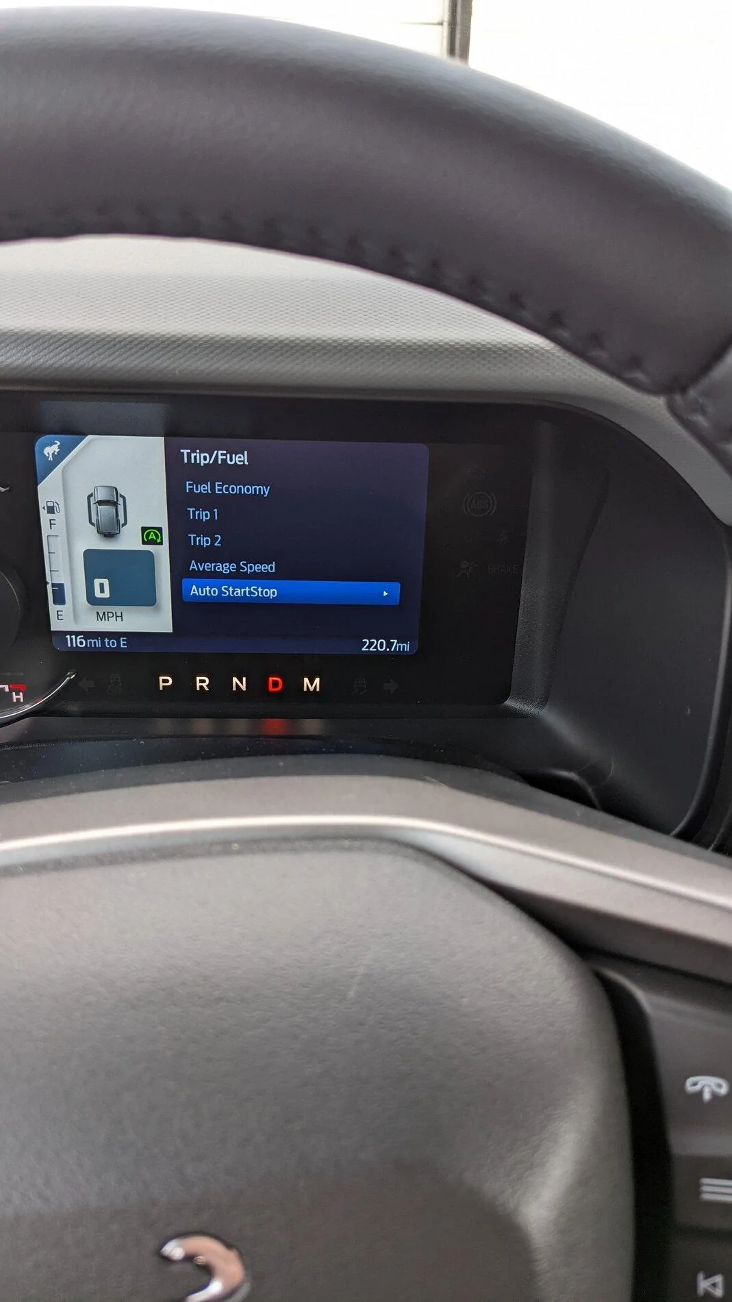

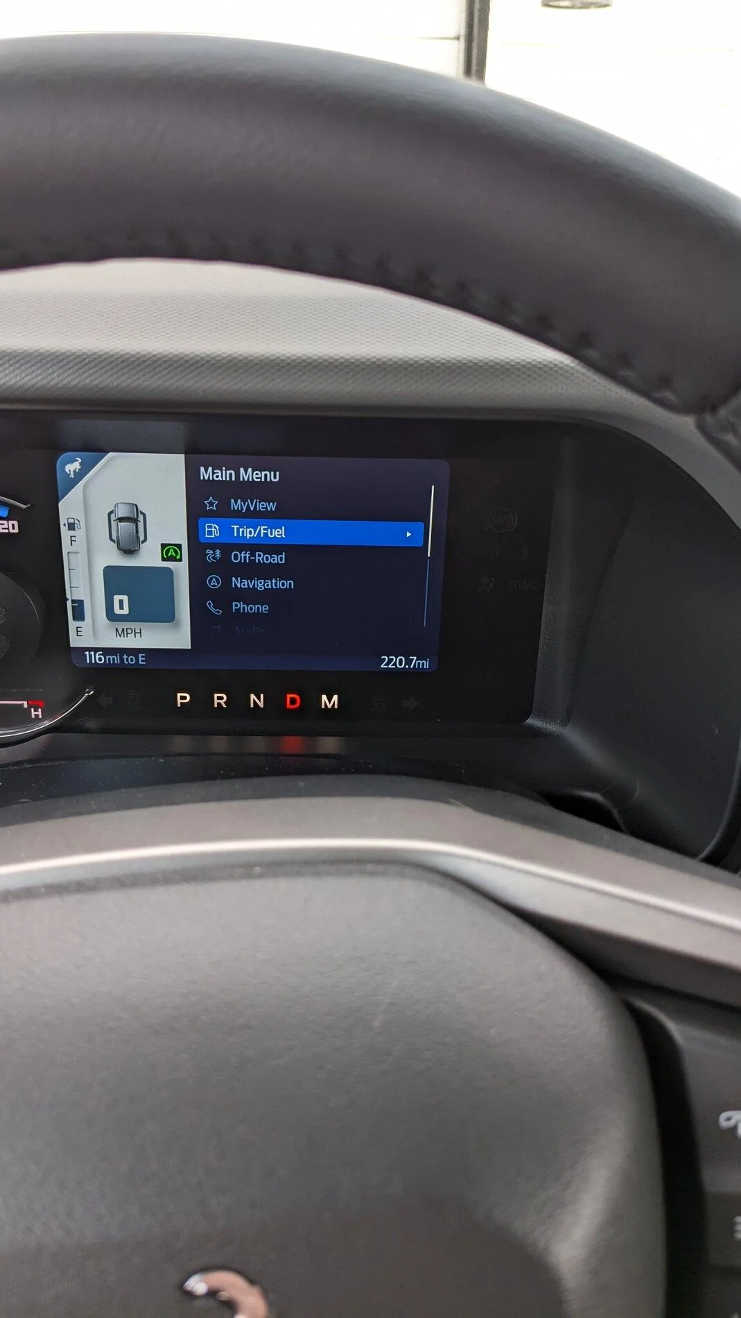

if I get in the car later, I'll see if I can find it again and let you know!
@ICUGAZN here ya go!
Go into menu (3 lines on steering wheel)
Ford Bronco Auto Stop / Start stopped working PXL_20211117_164849455
Ford Bronco Auto Stop / Start stopped working PXL_20211117_164853826
Ford Bronco Auto Stop / Start stopped working PXL_20211117_164858687

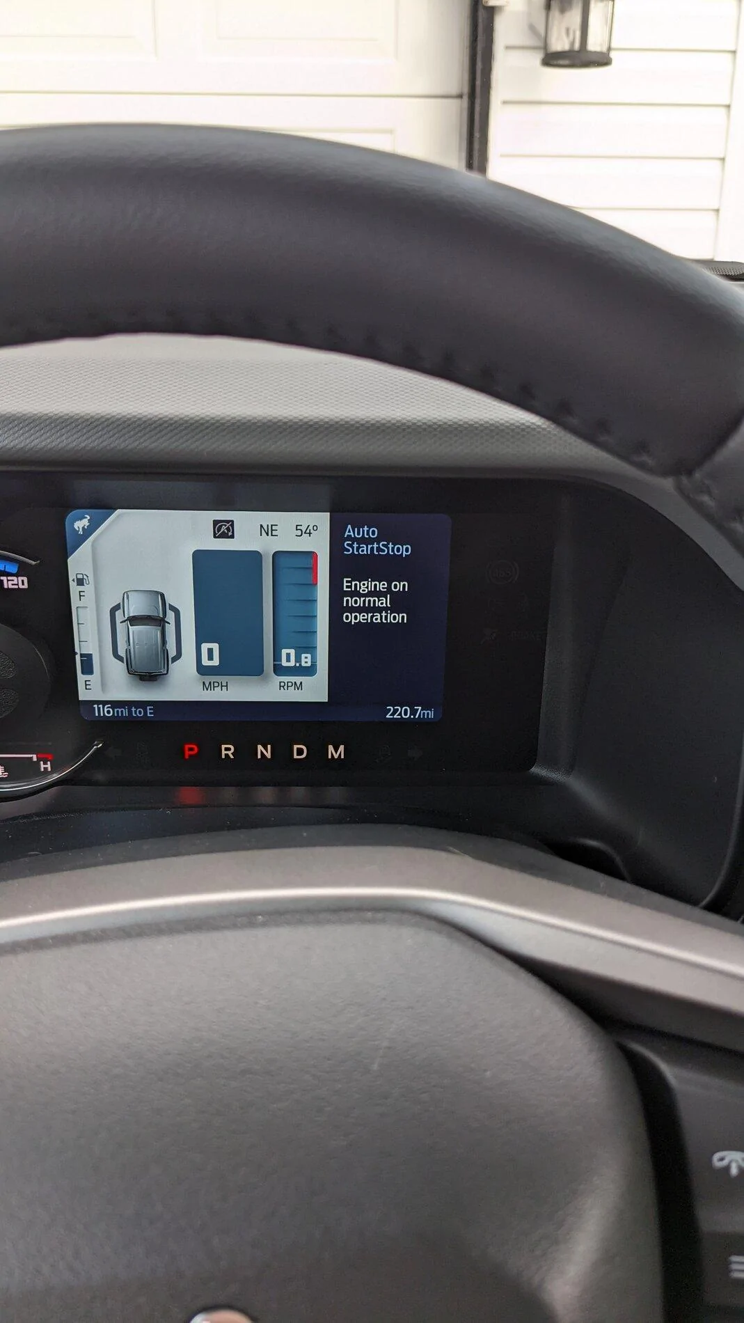

And then I put the car in park and it showed this.
Ford Bronco Auto Stop / Start stopped working PXL_20211117_164906356
