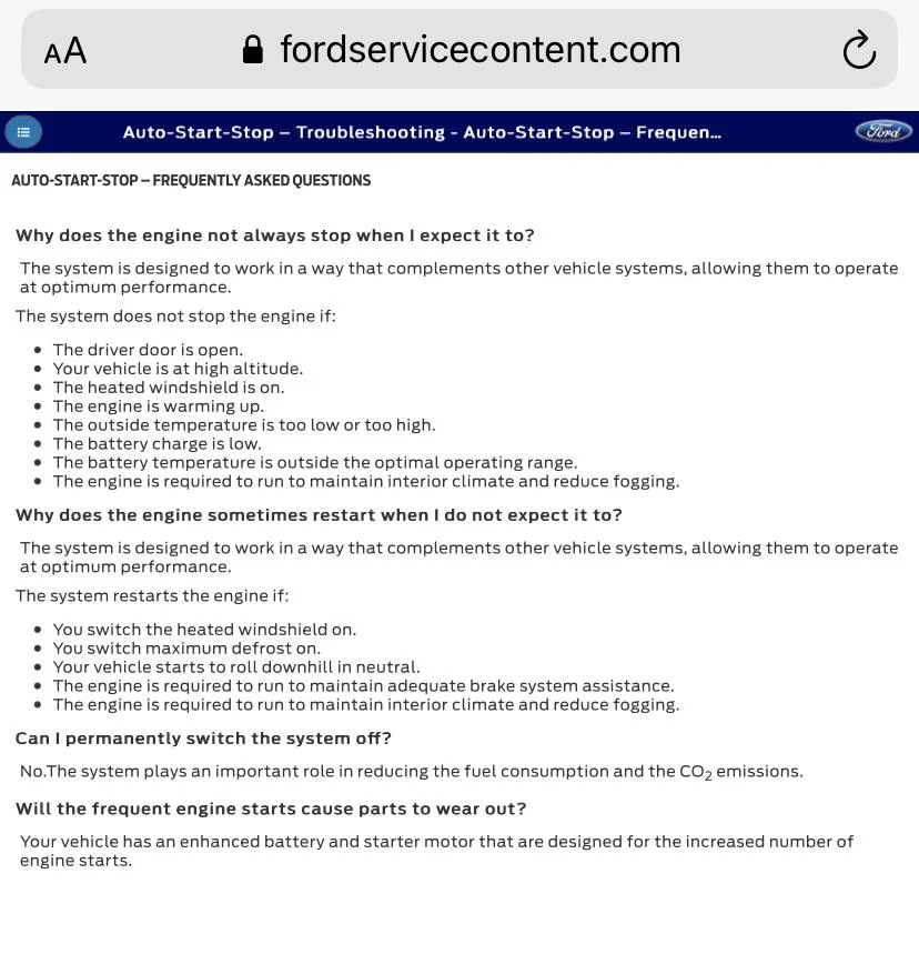

Has anyone noticed that their Auto Stop/Start has stopped working? I got my Bronco on 11/4 and it was working. The other day I noticed that when the vehicle was stopped, it was no longer cutting off. The little light in the instrament panel comes on when I'm stopped but it is greyed out. The same behavior as if it was disabled via Forscan. The only thing I was have done was wire up lights in the bumper to the AUX switches last thursday. I think I noticed the change on Saturday. I'm not really complaining about it, but I would like to know what caused the change.
My current car does this.. according to the manufacturer outside temperatures also affect it? They could totally be full of shit but I do notice it (could all be in my head at this point) changing when the weather was more spring like in Houston. Again… they could be full of shit but maybe I made you laugh 😂

If the engine is cold the feature won’t work until it gets to operating temperature.

Read the Manual. There are preset scenarios that may or may not change how your vehicle behaves.
