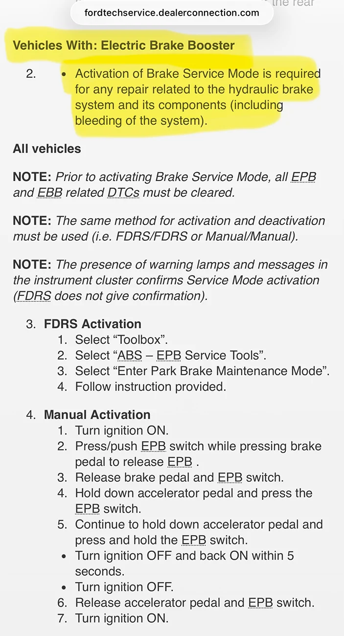

Unless the Bronco EBA is different than the Maverick (I don't think it is), the EBA is off when the key is off, and has no effect on brake bleeding. Can anyone show evidence the EBA systems operate differently?

Any thoughts on disconnecting the battery? It seems like when I used BSM the computer was still a little unhappy after returning it to normal mode. The code could be cleared but we’d still get a soft code that would resolve itself after driving for a bit.
Whereas when disconnecting the battery, I could replace and bleed all four corners without any lights or warnings.

I don’t really have any opinion on it, mostly just because I’ve never tried it that way or personally had any issues with the BSM when bleeding brakes, so it’s hard to say for sure. I also rarely bleed things manually, since I have quick access to a pressure bleeder/brake flush machine.
Usually I’ll go into FDRS and activate the mode, which I’ve noticed is typically more reliable/cause less issues than doing the cheat code way with the pedal and key cycles or through forscan.
But If it seems to work better that way, I would keep doing it that way. I don’t see it causing an issue or anything.

Maverick service says the same thing, but it's not necessary to bleed the brakes, I've done it with no issues. There are some early year Mavericks that will not go into brake service mode (DIY), and Ford has no fix. Thus, the manual method of retracting the EPB. I've done that too, works perfectly fine.
Ducati1098
10,000
23,252
Midwest
It’s for any type of hydraulic brake repair. The EBB is never necessarily “off” which is why the brake service mode exists and purposely disables the EBB. It’s not only to retract the rear pistons for repairs.
On a vehicle with vacuum brakes, I would agree that the main purpose is simply to retract the rear pistons for repairs.
But on a vehicle equipped with an EBB, it remains partially powered and ready for inputs. It can detect pedal pressure and activate the booster motor if you press the brake pedal hard enough without the key on, or even a key nearby. Brake service mode puts the whole EBB into a non-responsive state to prevent any issues.
That being said, yes there are things you can do sometimes that won’t cause an issue outside of brake service mode. You’re just not supposed to, that’s all.
Some 2.3 Bronco’s also have an issue with the DIY brake service mode procedure.
