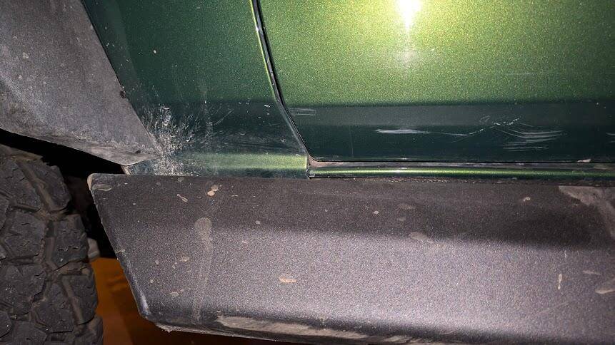

Installed December of 2023 after coming back from Moab. First real test was Prairie City Wild Horses and I bent both sliders upward at the front body mount. They slowly kept moving so I contacted ARB customer service last month and I apparently forgot to install spacers. If they where perfectly level before wheeling did I really need to space them back down?

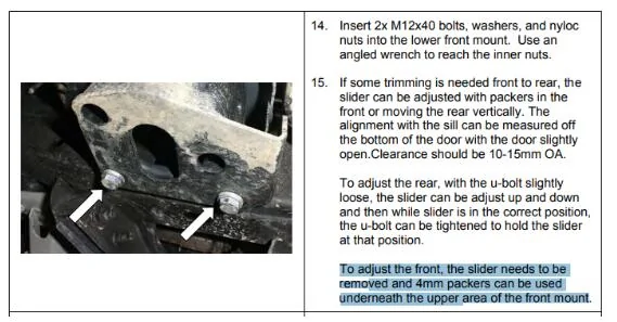

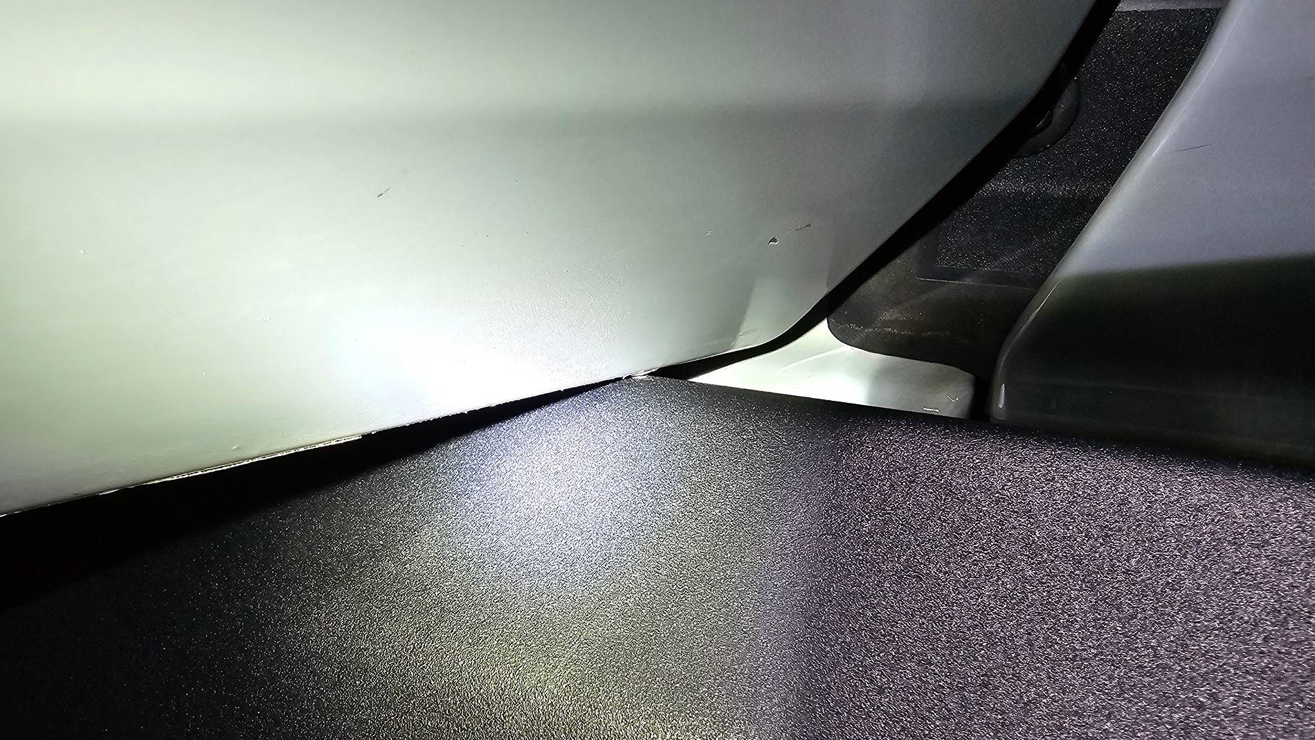

Running a 1/2" body lift and rubbing the doors last month.
Ford Bronco ARB Rock Sliders are junk 1725978986999-gm
Post 2nd real trail run the addition deflection is finally visible in the brackets. We will start with the washer, the band aid pretty much bent the lower bracket plate. If ARB had used a thicker bottom plate the washer might have worked. The science behind not let the bracket sit flat is the sole reason this deflected permanently. The 1/8" of deflection is enough to put the sliders into your door as it is a lever and you get more movement on the outside edge.

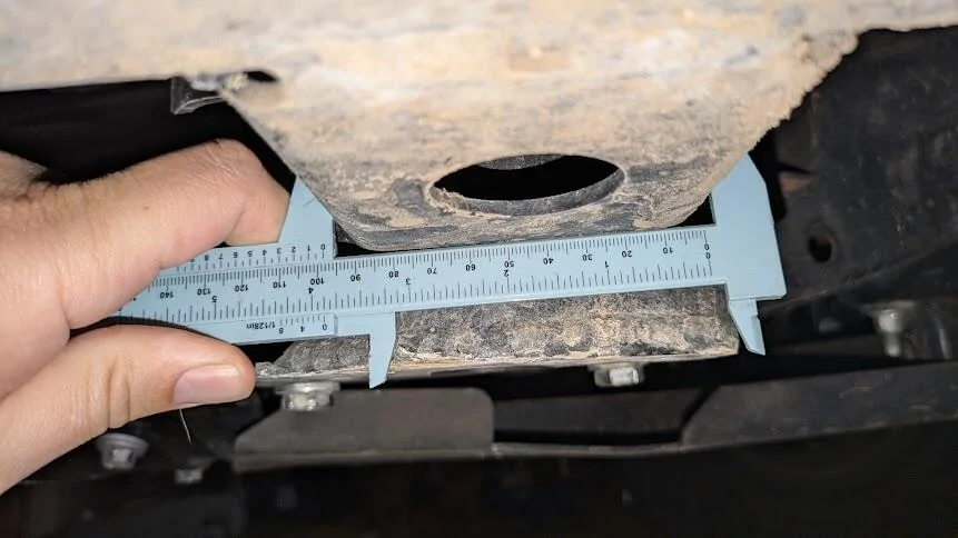

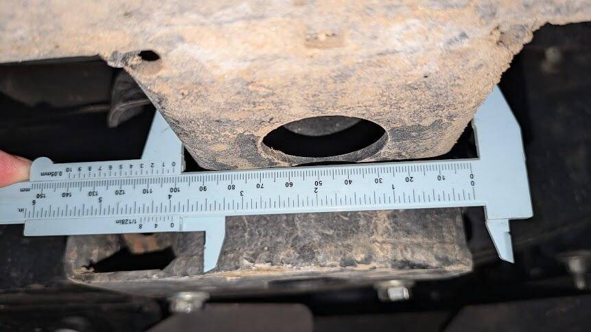

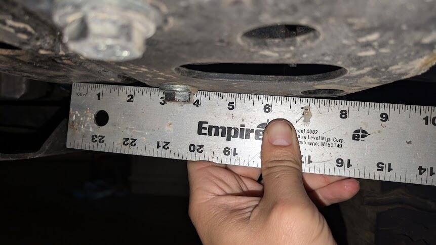

Next is the smoking gun, the channel is spreading. Here it is at 3 7/8" at the weld and it gets wider in the center.

Its also got a nice rainbow effect going on but I am really upset about the Bracket.
Ford Bronco ARB Rock Sliders are junk 1725979801071-w6
I am calling them junk at this point, my factory rails took a beat down. These are a massive disappointment. ARB quality and lack of customer service are a good enough reason to write them off. Nothing like the ARB products I use to run on my Landcruiser.

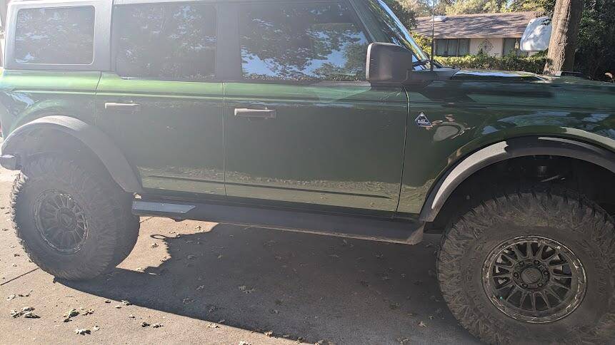

Original plan was to weld some flat steps/grating on. I thought ARB was going to be the longest lasting option.

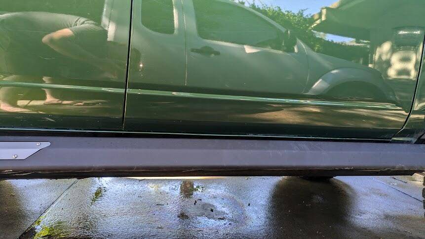

Now that the front brackets are bent I might cut the bent channel out. Not sure if it is worth the effort and time. The passenger side is making a frowny face which is kind of the nail in the coffin as far as trying to save these. Now I am just shopping LOD/RCI/Metaltech or something homemade.
