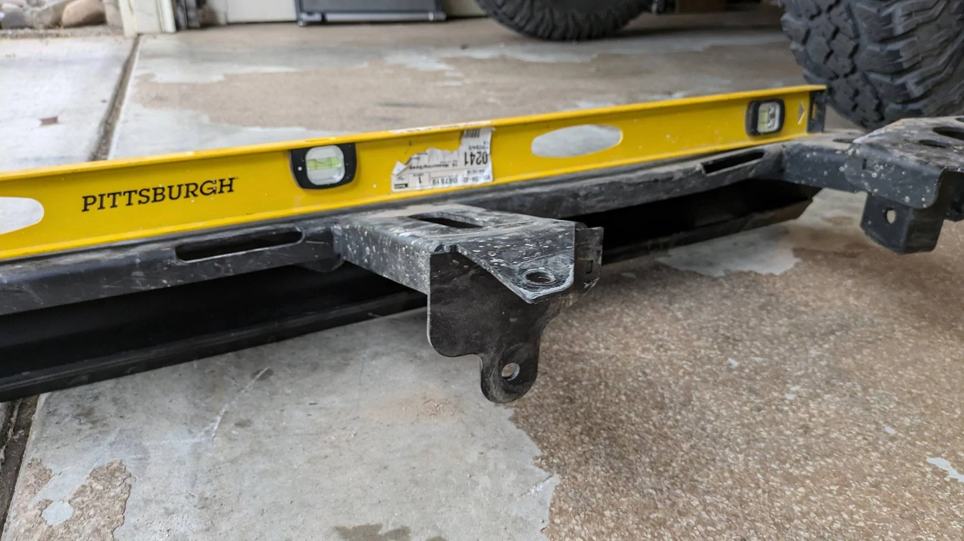

Well after 2 real uses I am calling them junk. I would call them something else but they are not a step, helpful or a long term product.
Installed December of 2023 after coming back from Moab. First real test was Prairie City Wild Horses and I bent both sliders upward at the front body mount. They slowly kept moving so I contacted ARB customer service last month and I apparently forgot to install spacers. If they where perfectly level before wheeling did I really need to space them back down?
Running a 1/2" body lift and rubbing the doors last month.
Post 2nd real trail run the addition deflection is finally visible in the brackets. We will start with the washer, the band aid pretty much bent the lower bracket plate. If ARB had used a thicker bottom plate the washer might have worked. The science behind not let the bracket sit flat is the sole reason this deflected permanently. The 1/8" of deflection is enough to put the sliders into your door as it is a lever and you get more movement on the outside edge.
Next is the smoking gun, the channel is spreading. Here it is at 3 7/8" at the weld and it gets wider in the center.
Picture stolen off the internet of the culprit.
Its also got a nice rainbow effect going on but I am really upset about the Bracket.
I am calling them junk at this point, my factory rails took a beat down. These are a massive disappointment. ARB quality and lack of customer service are a good enough reason to write them off. Nothing like the ARB products I use to run on my Landcruiser.

No additional skid. The deflection is nothing to worry about, steel can handle quite a bit of movement before permanently bending.
I am wondering if ARB used that world famous Chinesium Steel that never meets engineering specs.

The best design in the world doesn't typically stand a chance against inferior raw materials... I can't tell you how many times I've seen an aftermarket component straight up fail due to the metal itself literally tearing apart. The welds were fine, but the base metal was just absolute crap.
That said, I do have to agree with what someone else already mentioned about the leverage and relatively small outrigger design on these mounts; I'd say it was destined for failure from the get to be honest.
