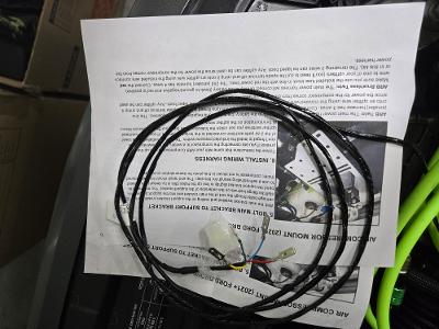

2. The 2 red power wires will reach my connection point at the battery. The 2 short black wires clearly will not. Do I need to extend them?
3. The 4 wire connections on the same harness, the Red wire attaches to the Upfitter switch?
4. The short, seperate harness with 3 wires at one end,red, blue, and black, and Isolating Switch, Switch 1, and Switch 2, are for lockers, and not used on my Badlands, correct?

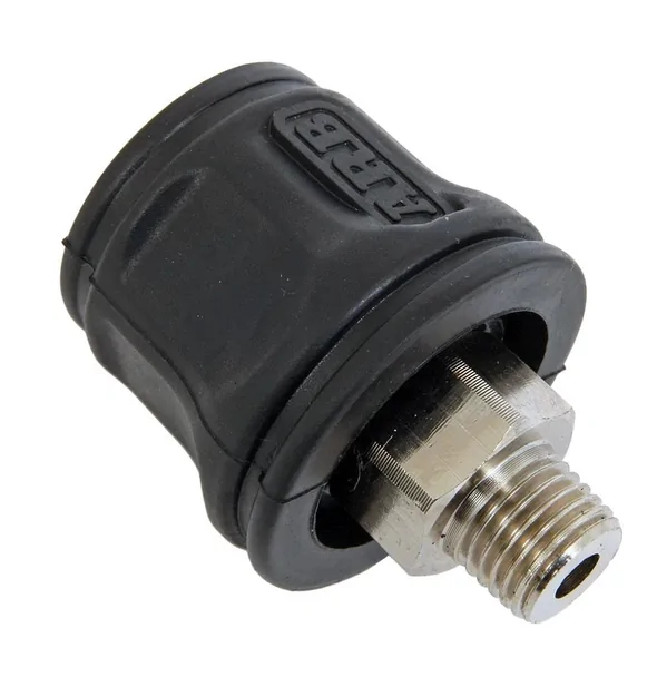

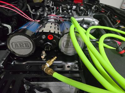

1. Extension air hose. Female quick disconnect on one end to connect to the pressure gauge on the Morrflate system. How does the other end connect to the compressor? The extension hose has a Male QD fitting. The chrome fitting will thread in to the compressor output. There should be a Female QD instead of the chrome fitting, to thread in to the compressor?
You need to screw in the air hose coupler. It screws into the air outlet on the side of the compressor (where that red cap is). You didn't install it in your photo. Once the air coupler is screwed in, the extension (or any air hose with a standard connector for that matter) plugs right into it.
Yes the red wire on that 4-wire bundle goes to any upfitter of your choosing.
The additional wires/adapters provided are not needed unless you plan to install air lockers. For a simple compressor installation see question #3 above.

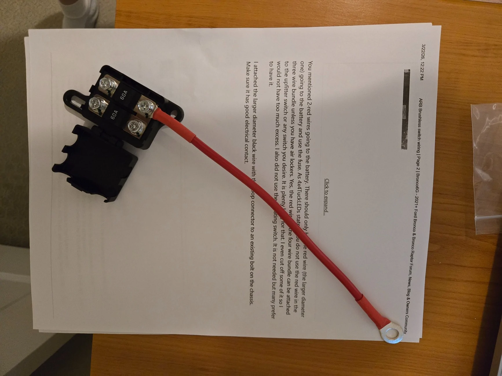

You mentioned 2 red wires going to the battery. There should only be one red wire (the larger diameter one) going to the battery and use the fuse. As 4x4TuckLEDs stated, you do not use the red wire in the three wire bundle unless you have air lockers. Yes, the red wire in the four wire bundle can be attached to the upfitter switch or any switch you desire. It is plenty long for that. I even cut off some of it so I would not have too much excess. I also did not use the Isolating switch. It is not needed but many prefer to have it.
I attached the larger diameter black wire with the loop connector to an existing bolt on the chassis. Make sure it has good electrical contact.

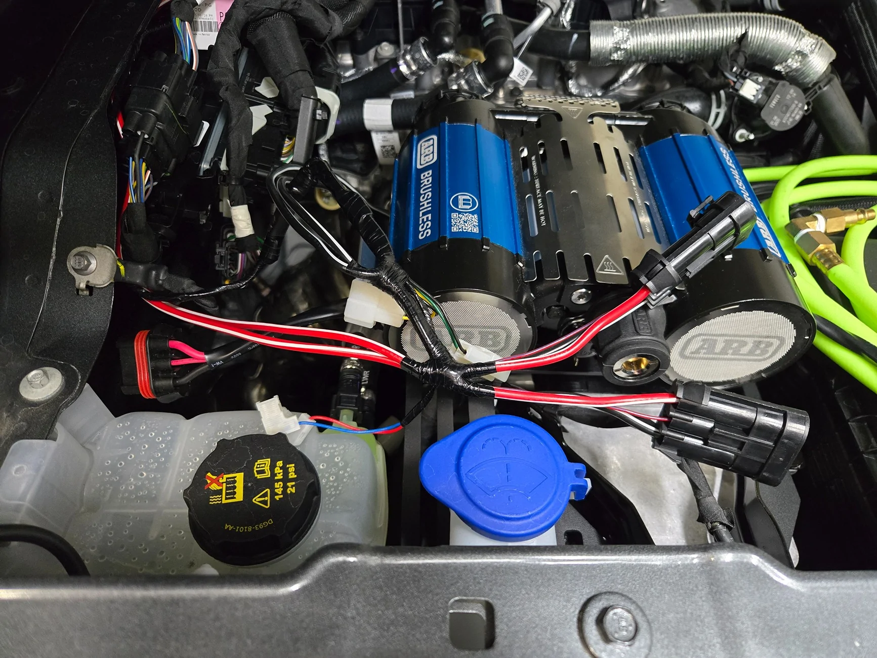

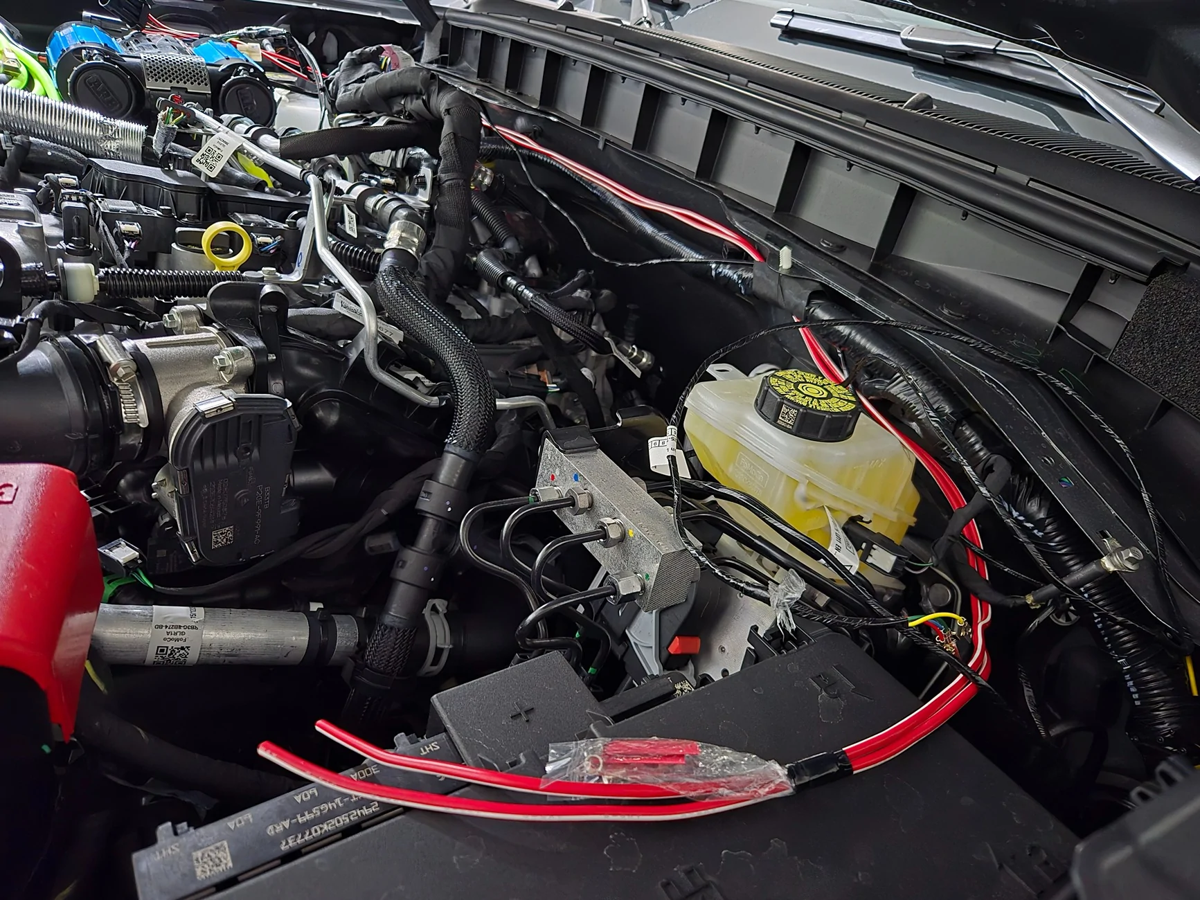

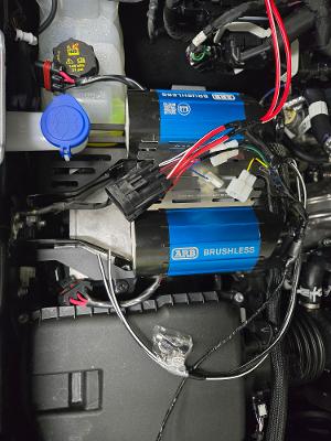

There are 2 large red wires with white stripes, one from each of the motor plugs. These appear to go to the 2 connectors on the included (2)60 amp fuses. A bus bar connects the input side of these 2 fuses together, with 1 wire going to the positive battery terminal. The small solid red wire in the 4 wire group can go to the upfitter connection. Is this correct?
2 pics included.
2 pics included.

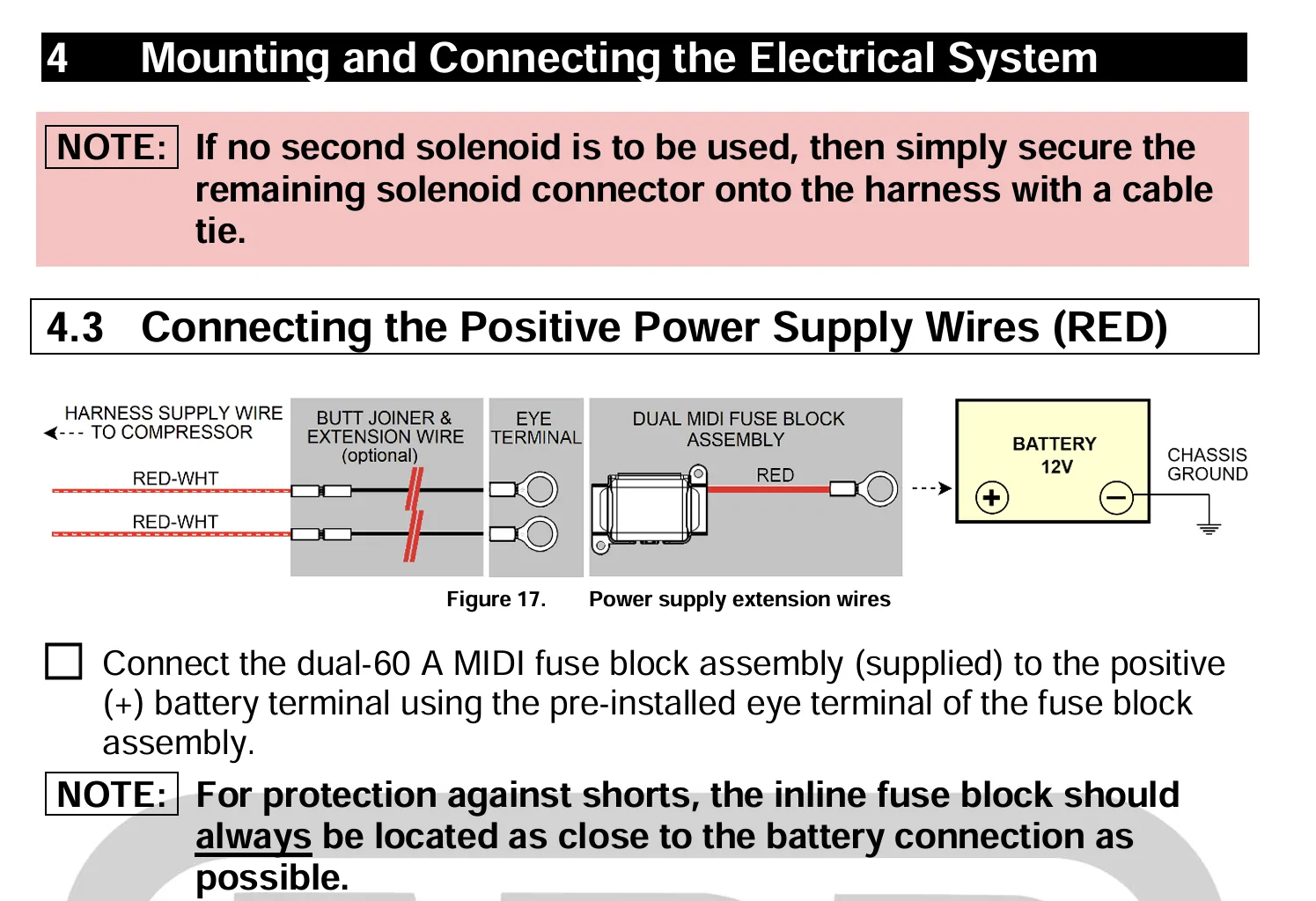

I'd recommend follow the instructions included with the bracket along with the ARB Brushless, which can be found here: https://store.arbusa.com/content/CKBLTA12 INST.pdf
2 pics included.
I see you have the double compressor. I did not notice that before. Mine is the single. That must be why we have a different number of large red wires.
