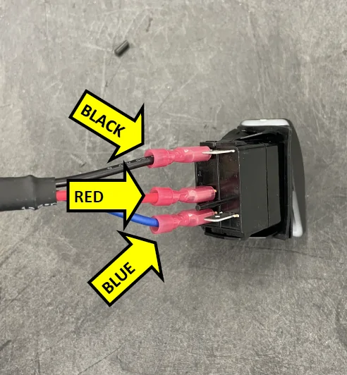

I have a ARB Brushless and I want to wire it to the factory ARB switch. Has anyone done this with their brushless? If so, how'd you do it? Most of the videos and articles I've seen show the twin brushed version, not the brushless. The few videos and articles I have seen, those people wired it to their upfitter. I want to wire it to the ARB switch under the hood so it doesn't use up an upfitter AUX slot. Hopefully someone could steer me in the right direction. Thanks!

Pretty easy.
On the brushless air compressor is a harness that has 4 small wires. The red wire is your TRIGGER wire.
You need to provide power to this to turn the compressor on.
So you would use a Switch to do this. The switch needs (at a minimum) +12VDC going into it, so that when its switched ON it sends that voltage to the trigger wire. You should also run -12VDC to the switch so that the switch light turns on when it's active.
Here is your switch diagram taken from our harness:
Ford Bronco ARB Brushless switch wiring 1771895564685-vv
In this example the BLACK wire is -12VDC. The RED wire is +12VDC. The BLUE wire is your trigger wire (so that goes to the compressor, in your case that's the red wire on that 4-wire bundle).
Thanks for the advice. I asked ARB and they said to wire it to the spot that says isolation switch. Apparently there’s different way of accomplishing the same thing. If I wire it the way you are saying, can you cut off the locker and isolation switch parts? Hoping to clean up the wiring a bit.
Did you buy your kit from us? If so, follow the instructions that came with our kit only use the information provided above to wire a switch in.
You don't need to follow the confusing ARB instructions if you are not running lockers or any of those other things. I usually cut/tape off the other 3 wires not used on that 4-wire harness and just focus on that red wire as it's the trigger wire. The rest are not needed unless you are doing lockers.

Also if I wire this way will the error detection still work on the compressor. I’m not worried about the lights because the switch will be under the hood and I won’t be seeing that while driving but having it beep the error codes would be helpful.
Just follow our instructions. Instead of running that red wire to the upfitter you'll just follow my instructions above and wire it to the ARB switch. Then bring in +12VDC and -12VDC to the switch as well and connect it accordingly.
