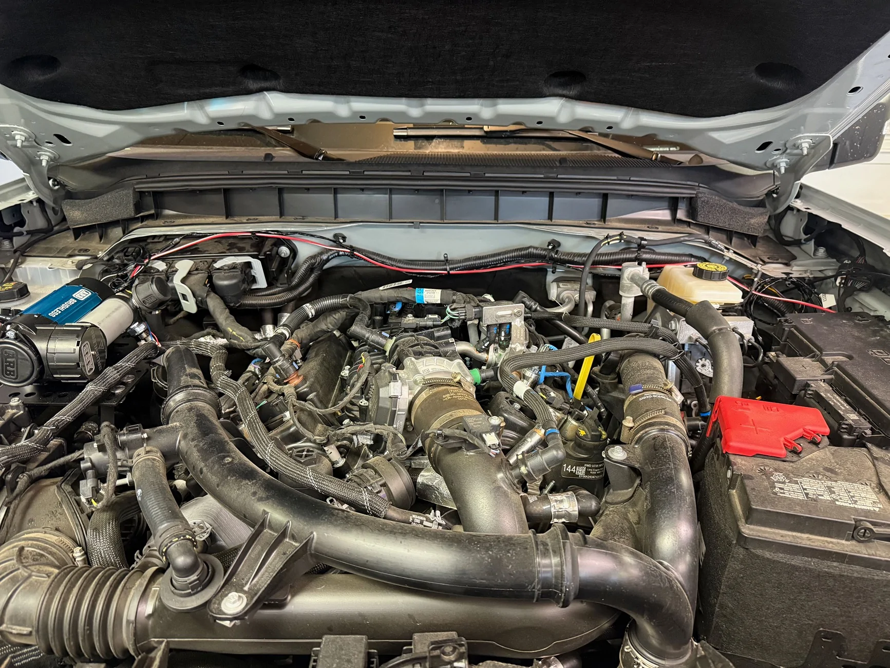

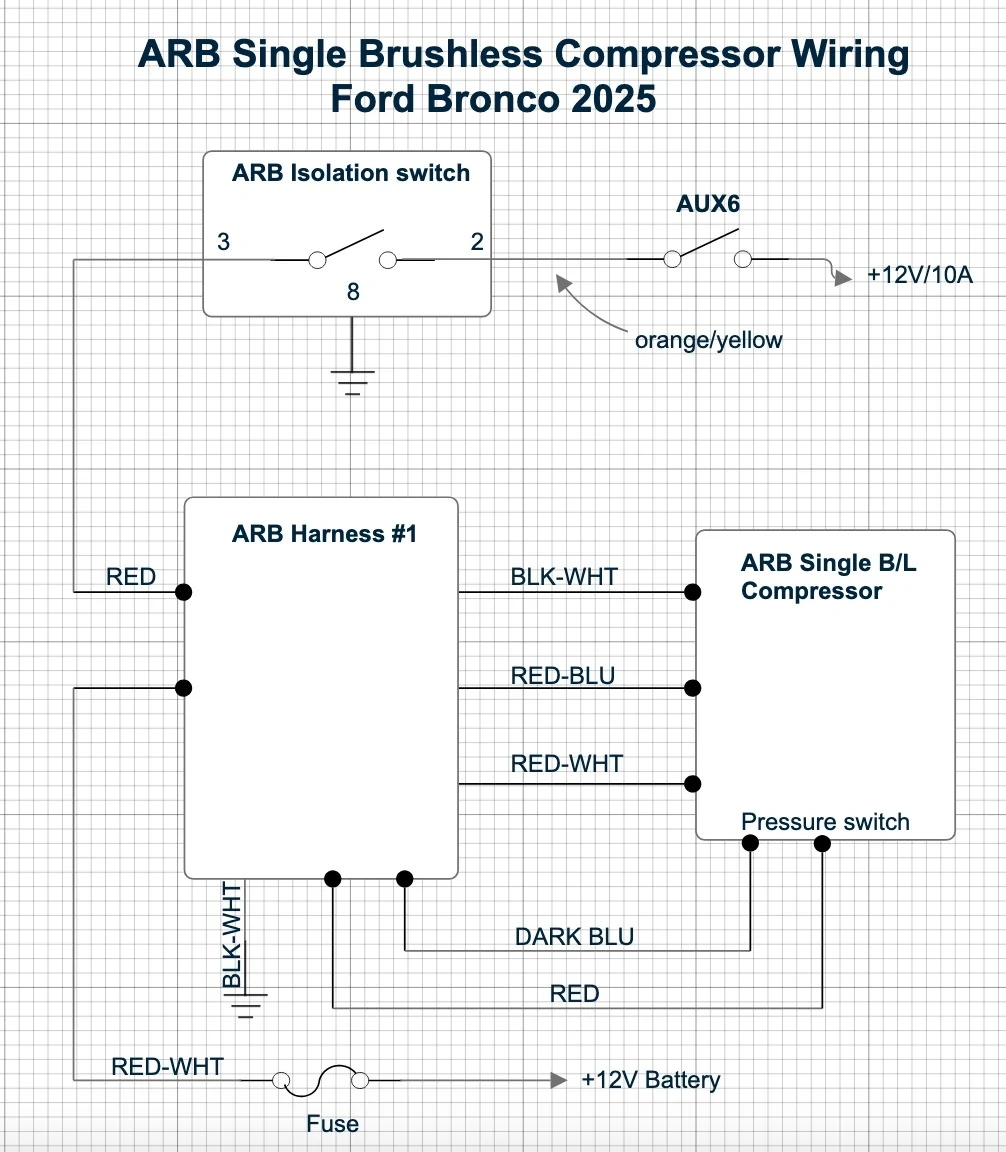

So, I finally installed my single brushless compressor and wanted to share some details about my setup: KR Offroad mounting bracket and an ARB isolation switch mounted on the bracket under the hood, connected to AUX6. The idea behind having two switches is to be able to turn the compressor off from the driver’s seat.
I found the ARB harness and wiring diagram to be confusing and overcomplicated for an average setup. After reading through this forum and watching a bunch of YT videos, I realized I’m not alone. So after speaking with ARB support, I created my own wiring diagram and simplified the first part of the ARB harness quite a bit. Hopefully it helps someone.
Ford Bronco ARB Brushless Single Compressor Install arb compressor wiring
Please use this at your own risk. The diagram has not been reviewed or approved by ARB.
I’ve also included a couple of photos of the final setup.

Thank you for providing a simple diagram. Do you think the Aux 6 switch and wiring will handle the amps for the compressor. I planned to have one of the Aux switches control a relay that is capable of more amps.
I see there are two wires going into the ARB Harness #1 from the battery. Does that eliminate the need for a relay on the Aux switch?
I have no need for an isolation switch so I can eliminate that.

Aux 6 sends current to the compressor control wire. The current there is minimal, sub-amper, I believe (I can measure it if needed), so it should be perfectly fine to use any of the aux switches.
The compressor motor itself is powered separately through the RED-WHT and BLK-WHT wires. The fuse there is 60A.
Part of my initial confusion came from the fact that the ARB harness is not just a coil of wires with sockets. It also contains electronics ("relay") that monitor the pressure switch, turn on/off the compressor motor through the control wire, and beeps error codes.
It appeared that the ARB isolation switch is also a bit smarter than just a simple switch. It has backlight with deeming support and the "relay" can send error codes through the switch LED. I didn't really need both of these features.

Great. Thanks for the explanation. That eliminates having to install a separate relay.

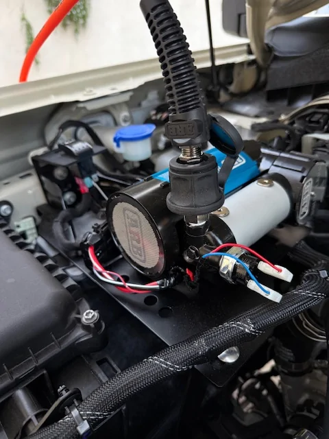

I am finally beginning the install of my single brushless ARB compressor. I have noticed most are installed with the filter toward the front with the air port at the rear. When I got mine laid out, I did it with the filter at the rear and the air port at the front. I like it that way. It is much like that way mcseem installed his but mine has the air tank and port on the opposite side (passenger side) of the compressor.
Is there any advantage to how the air compressor and air port is oriented? I know everything must clear the hood but I will figure that out once I get everything in place. I am using the JCR Offroad mounting bracket, but that doesn't appear to make any difference. I do have to drill my own mounting holes but hat is easy.

which details the install of the BRUSHED compressor SINGLE, but i bought the BRUSHLESS compressor... I have the dual BRUSHED compressor in my van, so I have a little comparison between the two...

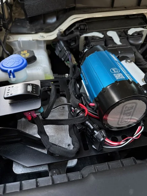

I wanted to post a few points on the install of the BRUSHLESS (because of some form factor differences between the brushed and brushless single compressor) that are a little different than the BRUSHED compressor.
1. I went with the single compressor not because it was a little cheaper but because I figured I didn't need the faster fill rate but rather wanted to be more economical with space inside the engine bay. Wrong. The mount basically occupies the space whether it's Double or Single. So don't let that bug you much. Trivial point my dual brushed compressor SOUNDS much better than the single brushless. The single brushless sounds strained and high pitch, but works fine.
2. The install is pretty straightforward. I loosened that inside shock mount bolt quite a bit and it was pretty easy to slip the medial bracket underneath there with it that loose(but not too lose). Torqued it up to spec with torque wrench (if you don't have one of these and have bikes or cars you work on, get them. I have a small 0-20lb/ft and a large 10-90lb/ft torque wrenches.)
3. The only way I could get the configuration of the compressor to fit is fully on its side in this configuration.
4. I got a little lucky because you need to mount the ARB bracket to the KR off road bracket first without really knowing how the compressor will fit in there. If you mount the ARB bracket too far to the side of the passenger wall, then the pressure control port will hit the KR bracket on the engine side and you can't rotate the compressor "sideways" enough. But if you mount it TOO far to the engine side then it seems it gets in the way with the wiring harnesses near the engine. I would say favor mounting the ARB bracket somewhat but not all the way to the engine side of the KR mount.

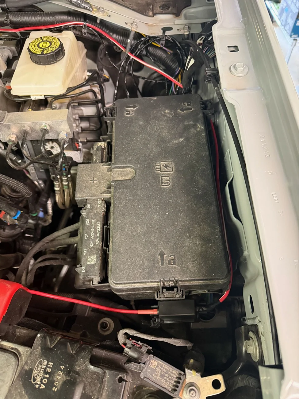

5. I ran the wiring harness and + power along the firewall and had JUST enough positive wire to reach the battery... ( not my cleanest wiring job in the world but it works).
6. My dog really laid down on the job on this install..."can you pass the wrench..."[no response from dog]

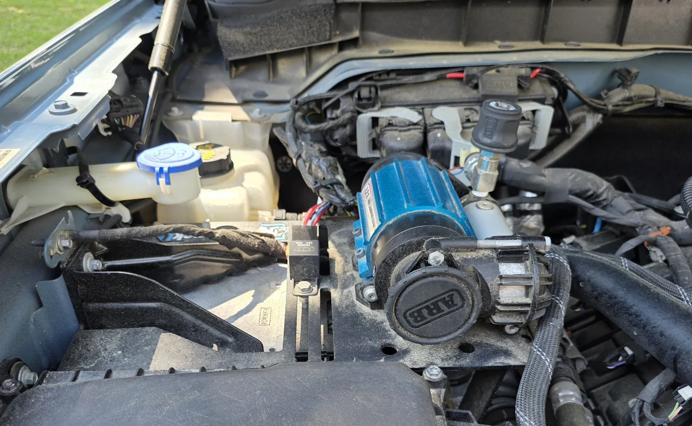

For comparison, here's how the original single looks on the 4x4LED bracket, rotated to fit. Been in there 4 years.
I found this thread: https://www.bronco6g.com/forum/threads/arb-single-compressor-install-video-helpful-hints.71700/
Ford Bronco ARB Brushless Single Compressor Install IMG_2450
Ford Bronco ARB Brushless Single Compressor Install IMG_2446
Ford Bronco ARB Brushless Single Compressor Install IMG_2479
Ford Bronco ARB Brushless Single Compressor Install IMG_2478
Ford Bronco ARB Brushless Single Compressor Install IMG_2444

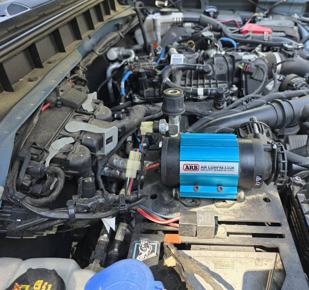

For comparison, here's how my original ARB single fits on the 4x4LED KR bracket. It's been in there about 4 years.
Ford Bronco ARB Brushless Single Compressor Install 20260327_134011
Ford Bronco ARB Brushless Single Compressor Install 20260327_134042
