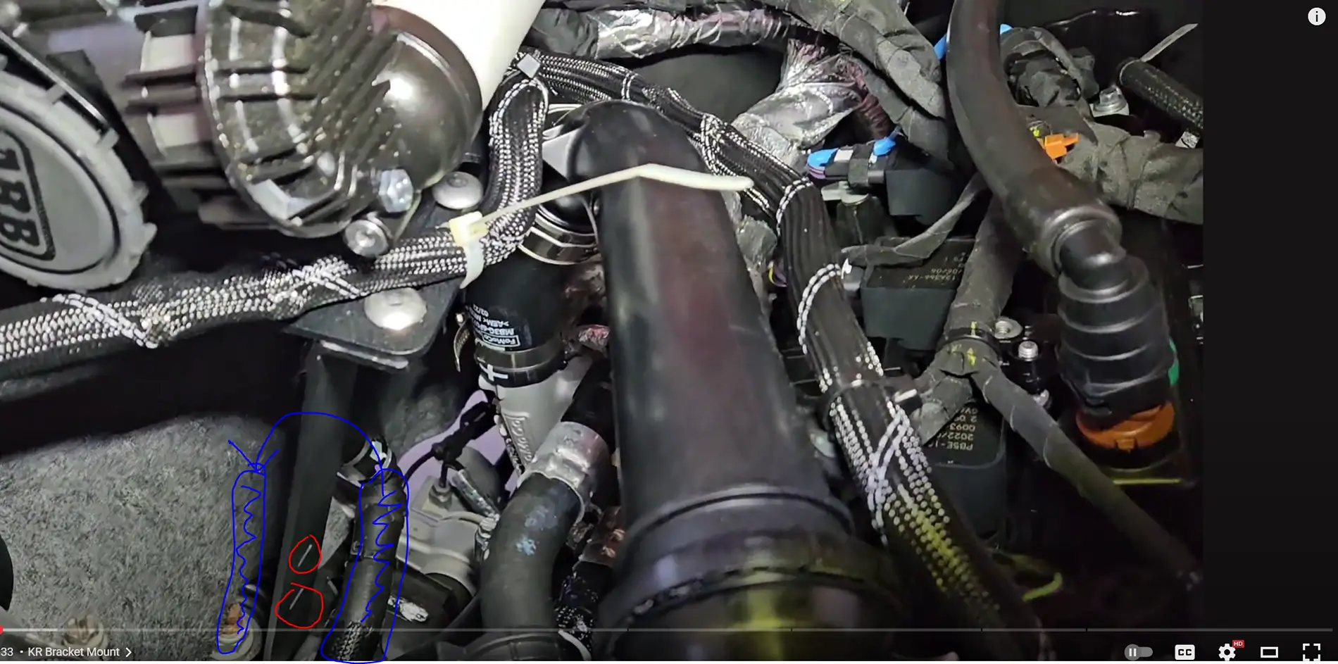

Looks good. BTW. your hose is in the wrong spot... i mean it'll work BUT if you look at your video... the hose is just hanging there. We have 2 slots on the support bracket for an included zip tie to hold that hose in front of the bracket (essentially UNDER the compressor). That keeps it out of the way and secure. With it installed on the other side, you have free access to torque down your bolt.
Shown in blue... move it from one side to the other and use the (red) zip tie holes
BTW, sorry late to the party here. This post popped up and I saw it/responded. Then saw it was a few years old :)
