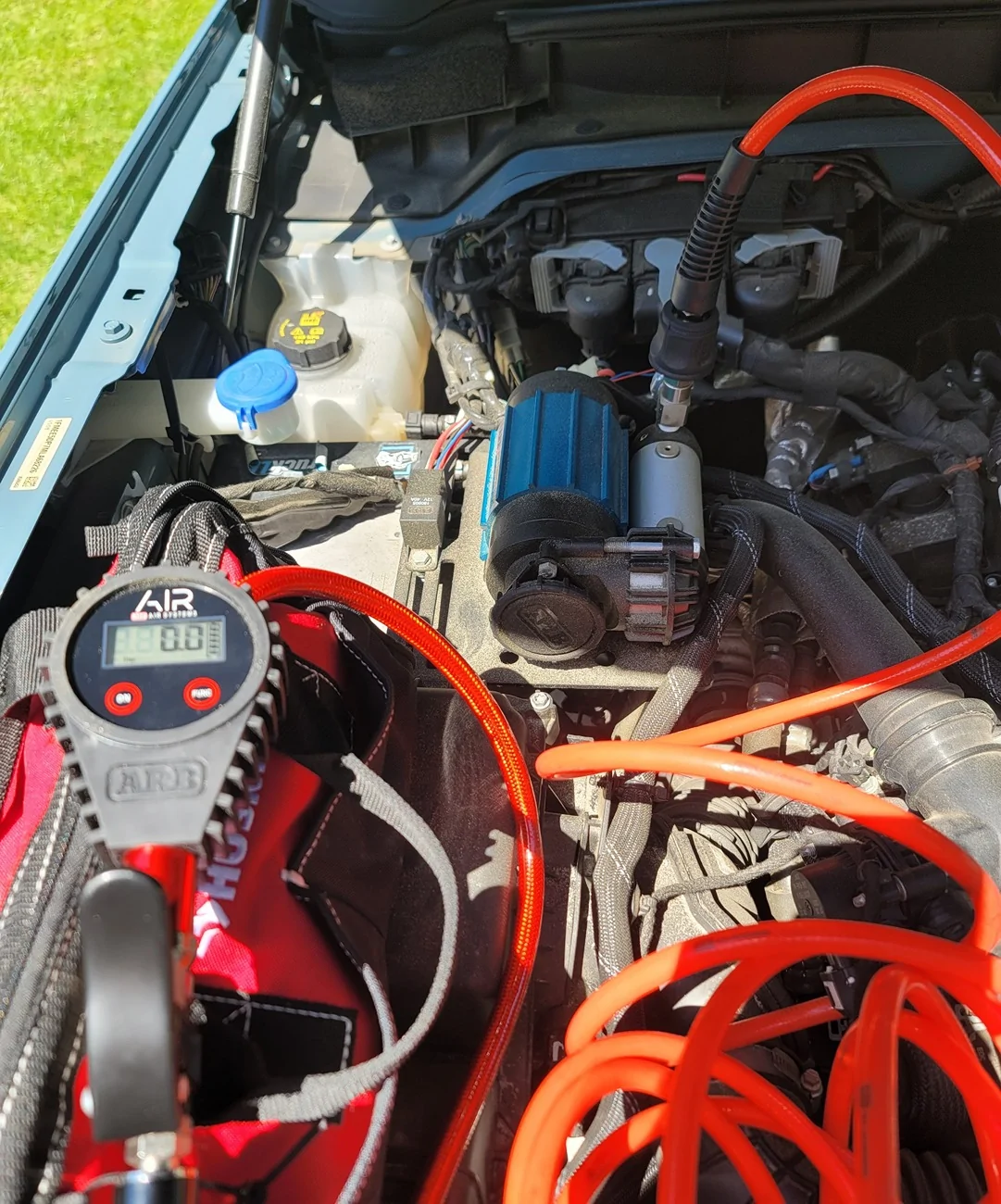

I found this thread: https://www.bronco6g.com/forum/threads/arb-single-compressor-install-video-helpful-hints.71700/
which details the install of the BRUSHED compressor SINGLE, but i bought the BRUSHLESS compressor... I have the dual BRUSHED compressor in my van, so I have a little comparison between the two...
I wanted to post a few points on the install of the BRUSHLESS (because of some form factor differences between the brushed and brushless single compressor) that are a little different than the BRUSHED compressor.
1. I went with the single compressor not because it was a little cheaper but because I figured I didn't need the faster fill rate but rather wanted to be more economical with space inside the engine bay. Wrong. The mount basically occupies the space whether it's Double or Single. So don't let that bug you much. Trivial point my dual brushed compressor SOUNDS much better than the single brushless. The single brushless sounds strained and high pitch, but works fine.
2. The install is pretty straightforward. I loosened that inside shock mount bolt quite a bit and it was pretty easy to slip the medial bracket underneath there with it that loose(but not too lose). Torqued it up to spec with torque wrench (if you don't have one of these and have bikes or cars you work on, get them. I have a small 0-20lb/ft and a large 10-90lb/ft torque wrenches.)
3. The only way I could get the configuration of the compressor to fit is fully on its side in this configuration.
4. I got a little lucky because you need to mount the ARB bracket to the KR off road bracket first without really knowing how the compressor will fit in there. If you mount the ARB bracket too far to the side of the passenger wall, then the pressure control port will hit the KR bracket on the engine side and you can't rotate the compressor "sideways" enough. But if you mount it TOO far to the engine side then it seems it gets in the way with the wiring harnesses near the engine. I would say favor mounting the ARB bracket somewhat but not all the way to the engine side of the KR mount.
5. I ran the wiring harness and + power along the firewall and had JUST enough positive wire to reach the battery... ( not my cleanest wiring job in the world but it works).

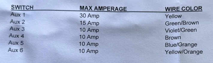

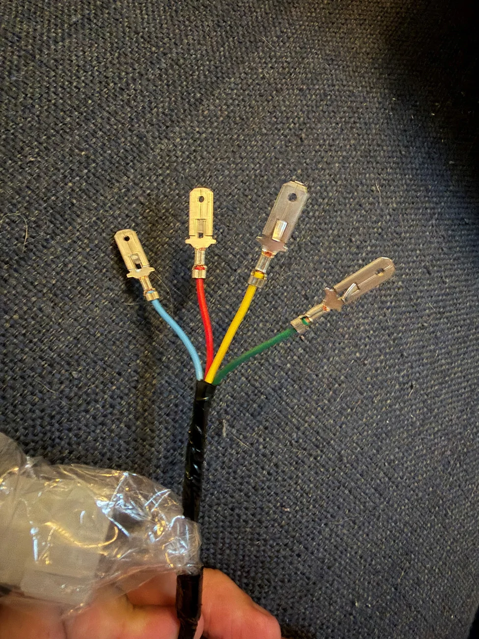

Do you have any pictures of how you wired to the aux switch? I watched some videos of installs, but they all seem to have a different harness than what i was shipped, maybe it changed with the introduction of the brushless version. I want to wire to AUX 6, but not sure which of these wires off the harness I would connect to. Thanks in advance for any guidance.

Yes, there is some guidance, saying to use the red wire. But then at the bottom it says if it is the single compressor, which mine is, that you are to consult the manufacturers instructions, which i posted above in my previous post. Just looking for a little guidance. Thank you.

You'll follow the same instructions as the Twin Brushless.
Single and Twin Brushless are the same
OG Twin uses a purple wire
OG Single uses a completely different setup

I'll try get a photo tomorrow, I understand that since there is a relay and/or solenoid, the full current is not passing through the switch, so it doesn't matter which upfitter switch with regard to wire size, I used so I picked #1. I tried to understand the wiring instructions and the use of the relay etc, and while I've done alot of boat wiring, this was too complicated for me. I installed the pump and bracket myself, and then took it down to 4Wheel Parts and paid them an hour (1.5) shop time to do it for me. I know my limits. This is an upgrade I'm really glad I did.

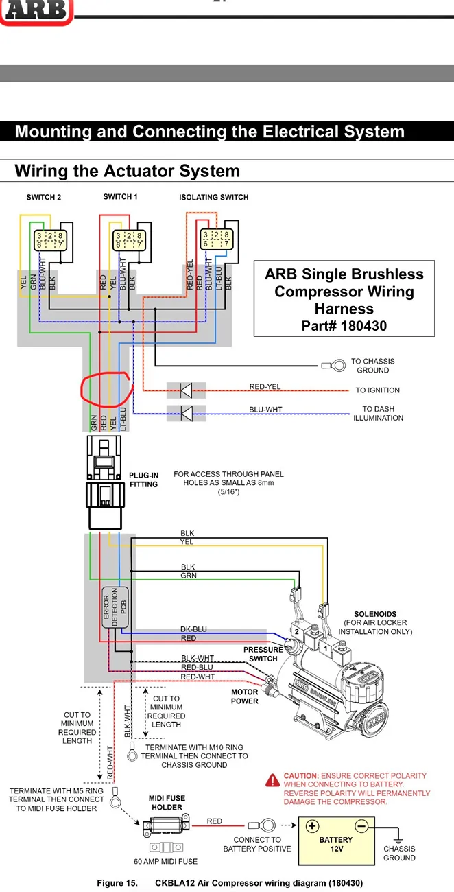

As someone who spent a couple of hours on experiments with ARB wiring diagram and 4x4TruckLEDs' instruction which is simple says "go figure with the vendor" I have to admit that both did a pretty good job of puzzling single brushless compressor owners.
I still need to find time to put together the final diagram I ended up with. For now, you need only the first, longest, harness. Then connect +(thick red-white wire + fuse), ground (thick black-white wire), and connect the thin red wire at the end of the harness marked as "isolation switch" to whichever AUX switch wire you want.
If you are using the ARB switch alone or in series with you AUX switch (like in my setup), you need to run the thin red wire through the pins 3 and connect its pin 2 to +12V or to your favorite AUX switch.
Of course, don't forget to install the pressure switch and connect it as well, see the original diagram on arb site https://store.arbusa.com/content/CKBLA12 INST.pdf
The rest of the wires on the harness can be safely removed or taped off.
