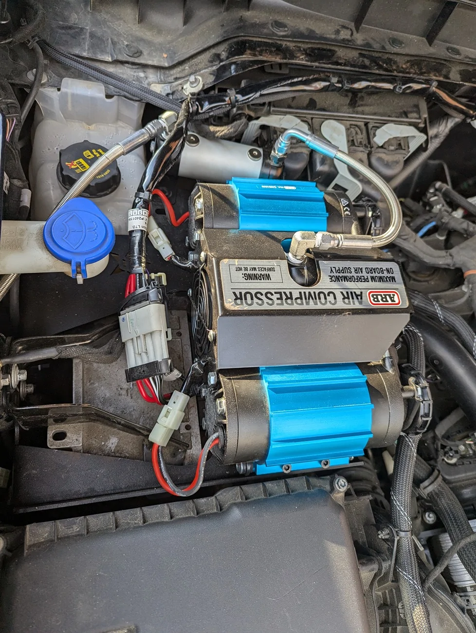

I just finished up the install with 4x4 LED's kit and the manifold. Probably could of just ran the quick connect right off of the compressor but the spot is kind of awkward compared to the original arb compressor. The extra ports will be adapted to NPT and should have a homebrew wifey air system installed soon.
You definitely don't need the manifold though.
On a side not, I am using redline hood struts and it gets close to the elbow on the manifold. Some of the other brands use a different mounting location and it may interfere.

Where is your coupler btw?
Yeah the side mounted ports on the brushless suck lol, but they still work. Our coupler/switch kit can be used with the brushless and it makes more sense to use that to allow for the coupler to be in a better spot. Although there is no plug and play switch option so you have to cut the connector off the switch and run an extra power wire. Not a huge deal though

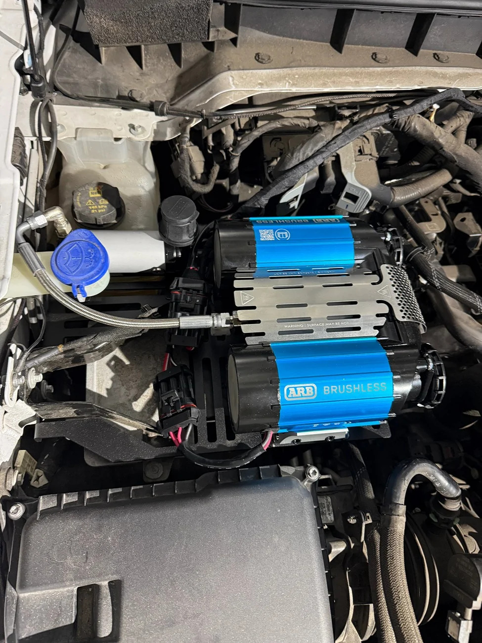

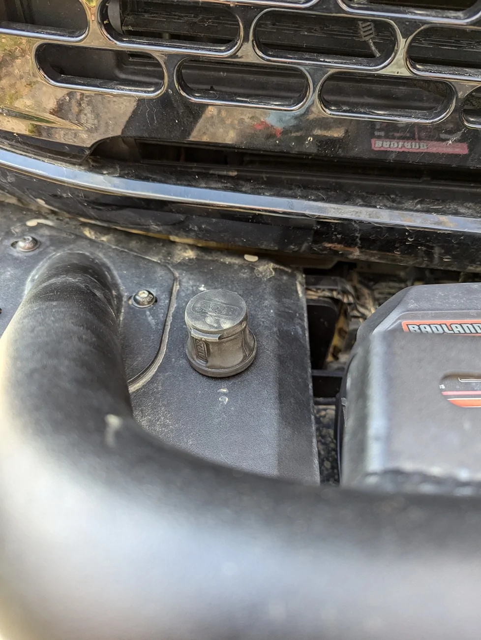

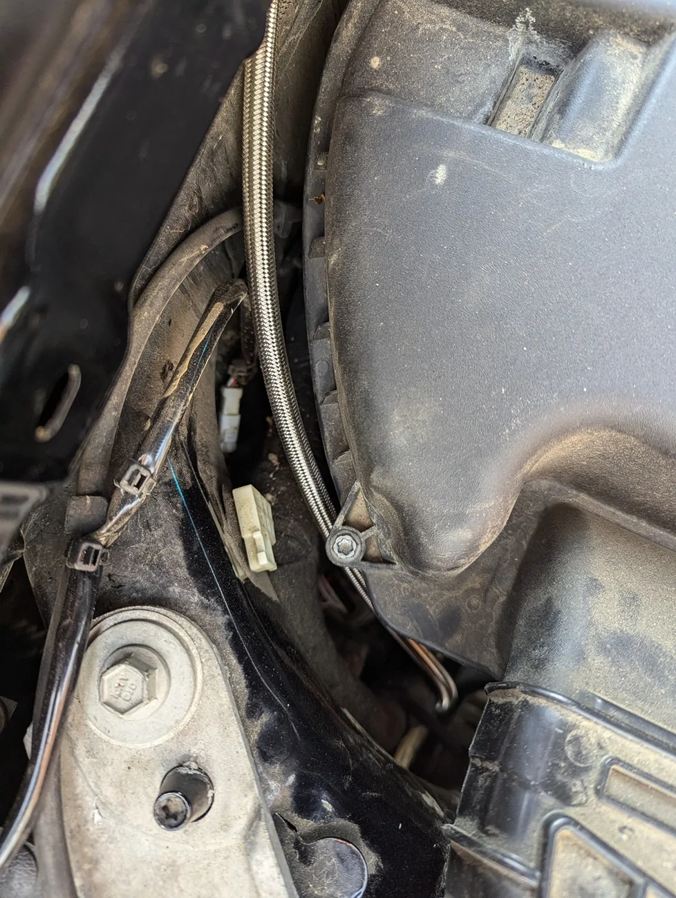

I initially installed mine (not a brushless) without a manifold.
And I promptly destroyed my air hose (a cheap HF one) the first time I filled my tires from the heat.
I then bought the ARB manifold & a 6' braided stainless line & the quick connect (all from Adam's site) & ran it to the front bumper for easy access.

Haven't had an issue with it since, still using a cheap HF air hose (they replaced the first one under warranty).

I believe I'll just order a longer SS line and mount mine in the front bumper as well! What length of line did you buy?

That's actually a great idea! Back when we had our TJ, I ran lines to both bumpers, had a Viair pump under the hood and a 3 gallon tank under the Jeep body and it worked great! I believe I'll just order a longer SS line and mount mine in the front bumper as well! What length of line did you buy?
Just looked up my order - it was a 1.5M line. It fits pretty well the way I ran it. Nothing is pulling right but nothing is loose enough to get caught up on anything either.
right side of the manifold between it and the compressor
