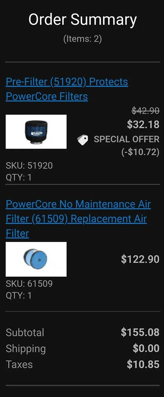

I can't say for certain how it will work with volcanic ash, but this is probably your best bet. This is what I run and has been great.
https://volant.com/products/powercore-air-filter-61509
Pre-Filter
Their website is making it difficult to search specifically for the Bronco right now. But these are the part numbers I have.
I will say the filter is super tight and a pain to install. Upside is that you really shouldn't ever have to take it out.. 😂
Ford Bronco Air Pre-Filter; Volcanic Eruption/Ash Precautions IMG_20250314_064159
