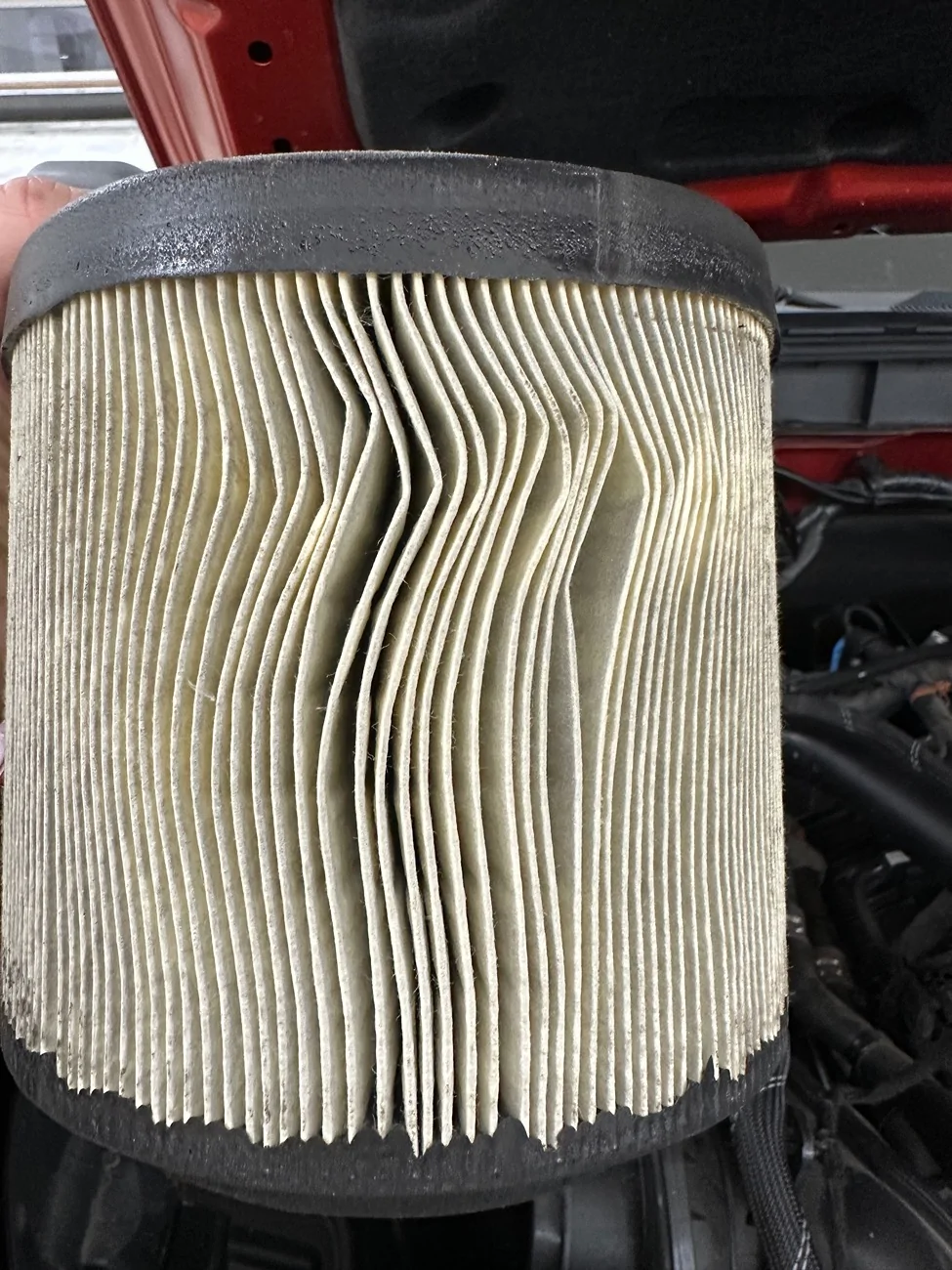

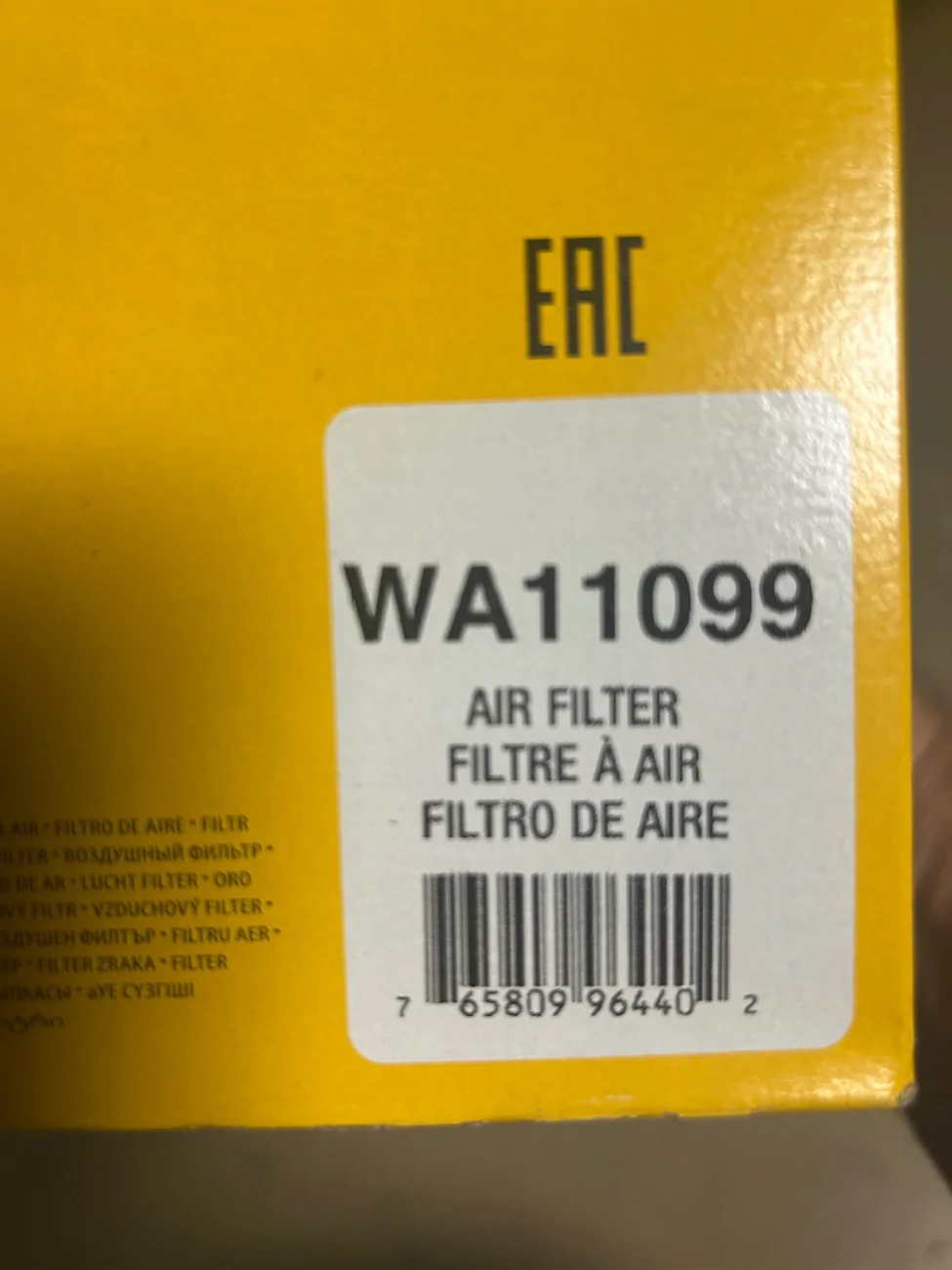

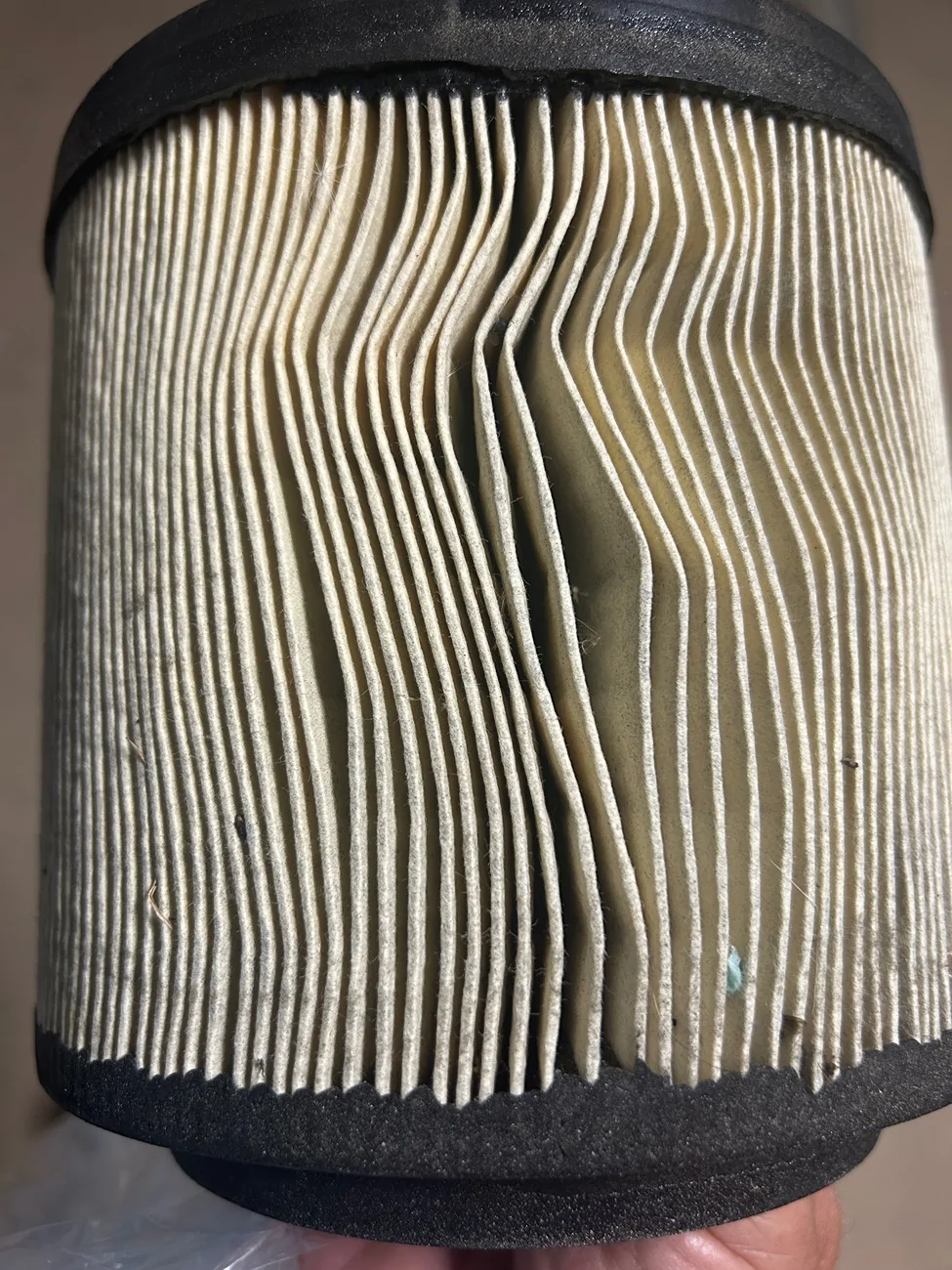

OEM after 18k. Bronco obviously sucks lots of air to burn all the fuel needed to achieve the high smiles per mile. Replaced with a WIX for $30 shipped. Nothing available locally except parts store generic.

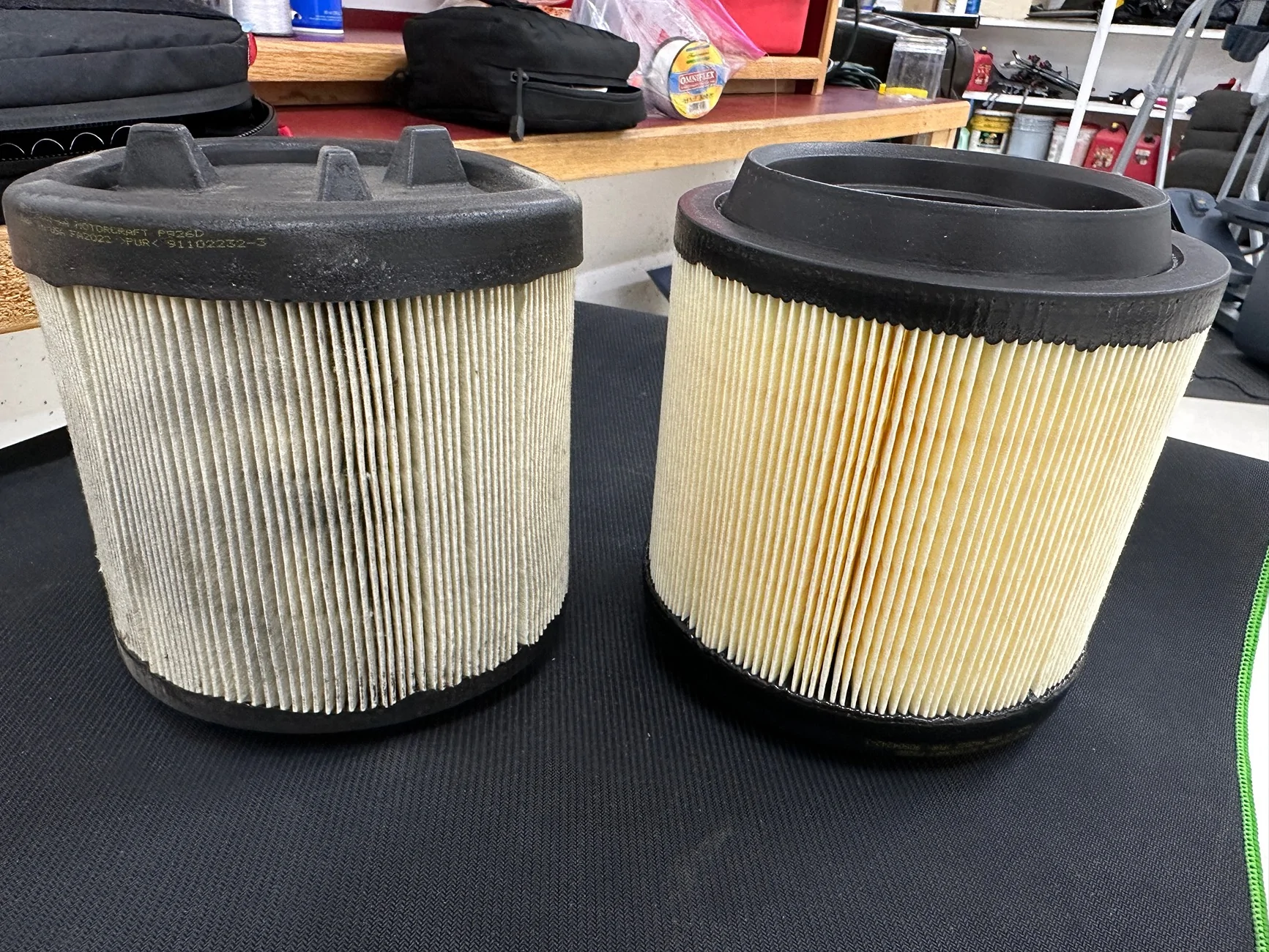

The Air Filters become more efficient (better) as they get dirty. At some point they will start to restrict intake flow too much though. I’m not sure why the OEM pleats seem to get spread apart like that, probably not ideal
Diesels have a spot for a gauge so you can tell when they actually need to be changed, unfortunately we don’t.
I change mine about once a year but I do some off-roading and hit a lot of dusty gravel/dirt/silty roads. If you don’t do that I’d bet 2 years/30k would be Ok.
Mine looked much the same as yours when I changed it out last January.
