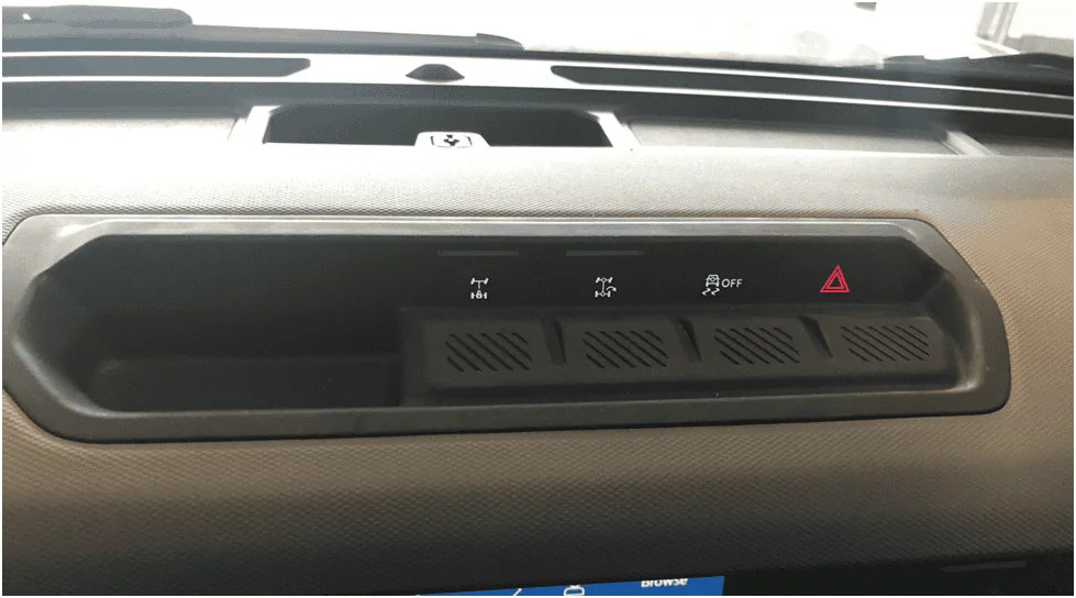

I purchased a used “Hero” switch with rear locker optinon from eBay for about $60. The install was super easy and I would suggest using some plastic interior pry tools.
Next was to work with FORScan to get the switch turning on/off- as it will not just work once installed.

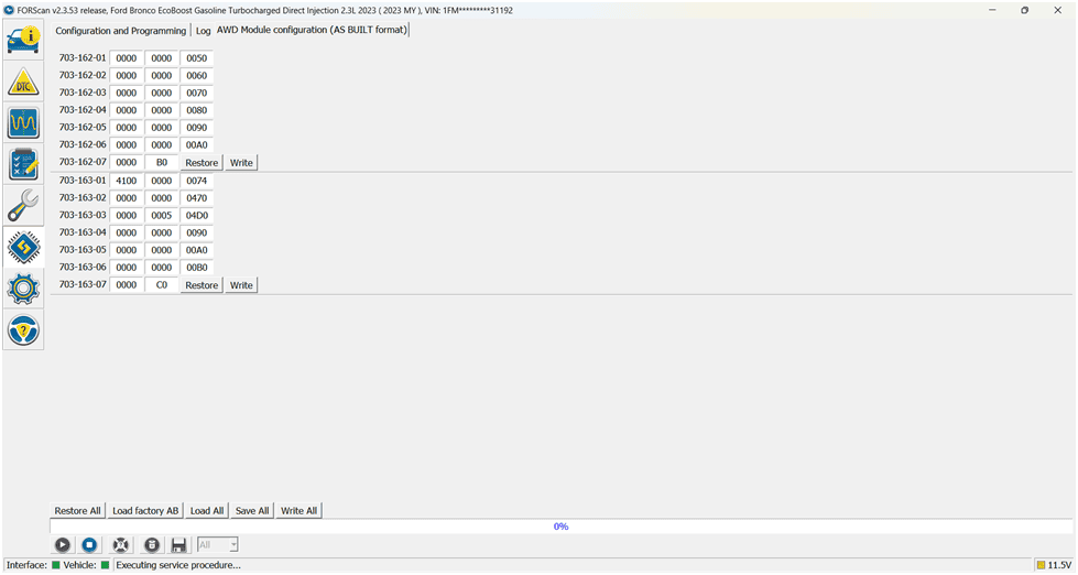

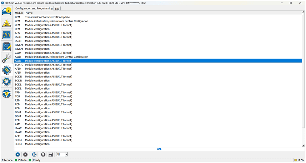

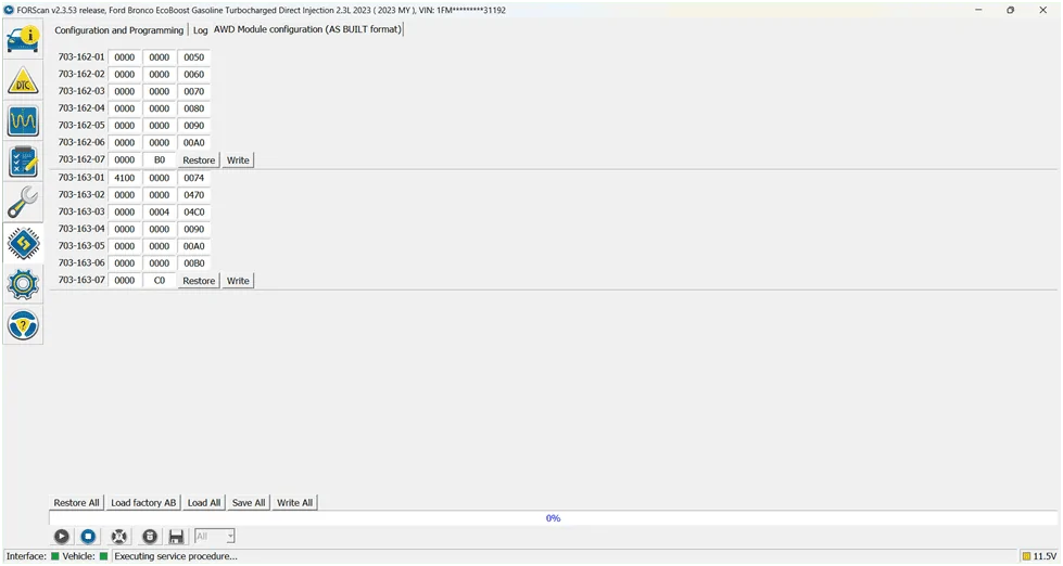

So I went into FORScan, found the AWD Module Configuration (AS BUILT format) and changed the above.
My Original:
After Change:
I then loaded the change to the vehicle and check the switch functionality- the switch lit up yellow but just for a few seconds. I suspect the computer pulls power if it does not detect a load- no load because there is no locker installed right now. I still call this a WIN!

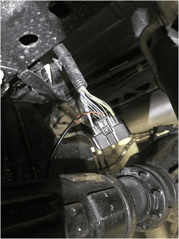

This is fairly easy now that I, unintentionally, explored all the connectors finding the simplest connector to access is all you need to access. The electrical can be done a number of different ways, again, I tried keeping this looking as factory as possible but you can also splice in your own wiring rather than running it through the below connector- this would be much easier than what I did.
If you follow the electrical harness on the driver-side outer frame-rail it will eventually begin to cross over the exhaust. Before it crosses over to toward the driveshaft there is a connector hidden on the crossmember. You can disconnect the connector and pull both ends down- they are fastened with the push-in clips that are a pain to remove.
In the connector on the frame-rail side you will see two wires that do not extend to the other connector. The ones we are interested in for the locker are Blue/Orange and Green/Brown, they are separated by two other wires.

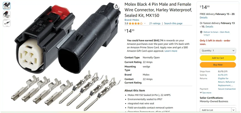

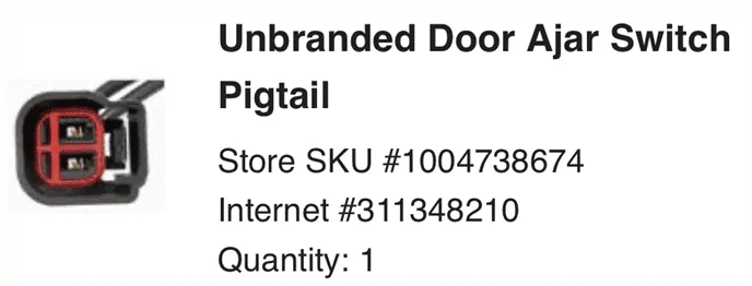

Here is where you can choose two paths; 1- cut those Blue/Orange and Green/Brown wires and splice in your own wiring to the differential or 2- Add pins to the connector that is missing the wiring- I decided the second option.
I purchased this connector hoping that the pins would work for this application. They were definitely tight but pushing them in with a very thin screwdriver worked.
https://www.amazon.com/gp/aw/d/B07HQ5FK14?psc=1&ref=ppx_pop_mob_b_asin_title
You’ll use two of the pins on the left in the below image.
With a small screwdriver, remove the black cover on the back of the connector missing the two wires for the locker. Once the cover is removed, gently pry the blue seal out of the way too. Then run your wires through the black cover and through the blue seal. If you are color coding your wires, I kept red to mate with the Blue/Orange wire as this is COIL+ and I had black to mate with the Green/Brown wire as this is COIL-. If you keep color coding consistent here it will help you later with the differential plug. Once you have the pins from the above link crimped to the wires, then you will want to seat them into the connector. I used a very thin screwdriver to press them in- they were tight.
I then reassembled everything in reverse order- blue seal, then back cover.
I then routed the wires along the harness running to the differential. I finished the wire bundle on the passenger-side of the differential.

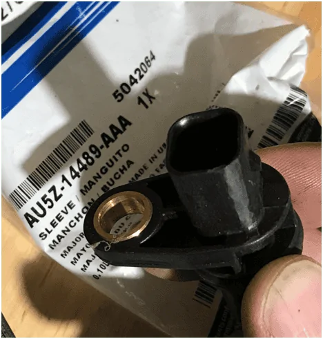

You will need to purchase the connector that attaches to the differential. The part number I chose is 645-685. You can find it on amazon for about $15.
I then spliced the above connector into my wire bundle that I routed to the differential.
I was then able to connect this pigtail to the e-locker solenoid and confirmed the Hero switch engaged the solenoid.

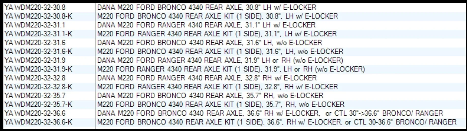

Researching the axle lengths I found that I will need different length axles. You can go to Yukon and buy chromoly axles, one of which will have to be cut to length or you can find the right size from a Bronco or Ranger.
Here is the rundown of axle lengths:
Bronco With Electric Locker: Left- 30.8”, Right-32.8”
Ranger With Electric Locker: Left- 31.1”, Right- 32.8”
Bronco W/O Electric Locker: Left- 31.6”, Right- 35.7”
Ranger W/O Electric Locker: Left- 31.9”, Right- 31.9”

Before installing the locking differential you will want to buy the differential passthrough connector, you can get this directly through Ford, I found mine on eBay for $25. I had to shave it down a little to fit with the connector routed to the differential.
Then you will have to drill the axle housing to fit this connector. The below picture is a factory installed connector, I will take a picture once I have done this mod.

Hey- thanks for the question.
if you check out my section for “differential” you will see a listing of axle lengths.
The left and right axles are different between locked and open axles to make up for the internals of the locker.
You will notice that the bronco without locker has longer axles shafts than the bronco with locker. So you will be able to cut your shafts down. I actually found a video by Dana or Yukon, I can’t remember which, where they show you the process of cutting them down by hand. I’ll look for the video if that would help.
Hopefully my explanation helps. With my summer projects always taking over I plan to jump back to this in the winter so I have no other progress to offer.
Also, I got another axle housing only so I could work on this project on the side then do a bolt-on swap of the entire axle when I’m complete.
Good luck!
Just a clarification - they aren’t both longer
The axle overall length is the same, but the pumpkin sits about 1” different between the two. So one axle is about 1” longer and the other 1” shorter.
If you tried to take a set and just cut them down, you’d have one that’s fine, and one that’s possibly a bit too short even without cutting

Thank for your reply.
I just want to make sure we are stating accurate info here tho.
From my research I don’t believe this statement about axle lengths is true.
I also spoke directly with Yukon gear and they provided this chart, which matches my summary chart in the first page.
I’ll absolutely confirm when I have the axle torn apart this winter but Yukon Gear is a very reputable source.

I found the only difference between my VIN and a same Bronco with rear locker was as follows:
My vehicle: 703-163-03 0000 0005 04D0
Rear Locker vehicle: 703-163-03 0000 0004 04C0
My Original:
After Change:
I was actually able to find a removed axle from a Bronco (prior owner swapped with an e-locked axle). This axle cost me roughly $600 with; axle housing, differential/pinion (don’t plan to use) and axle shafts. As you can see from the above axle lengths, you can just cut the factory axle (non locked) shafts down to the proper E-locker length- this is what I will be doing.
