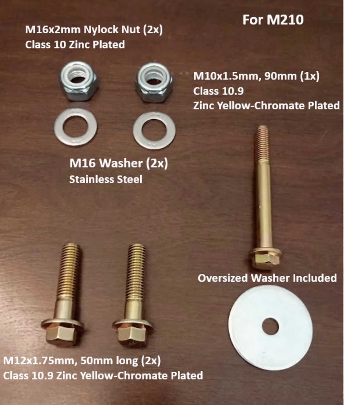

Just got the Dobinsons. They don’t include the bolts and nuts needed contrary to what their site says. Heading to Ace tomorrow to get the the same ones Broken Innovation uses. I can’t use their drop though as my Talons skidplate needs to use their threaded hole in the middle which broken innovations doesn’t have.
Bear in mind that this hardware is sized for the specific drop and spacers used in my kit. If another kit does not use a spacer, or same type of spacing strategy at the rear of the diff you may not want to use this hardware.
Their kit comes with the spacers for the diff tube. They just didn’t include the bolts for the frame mount.
